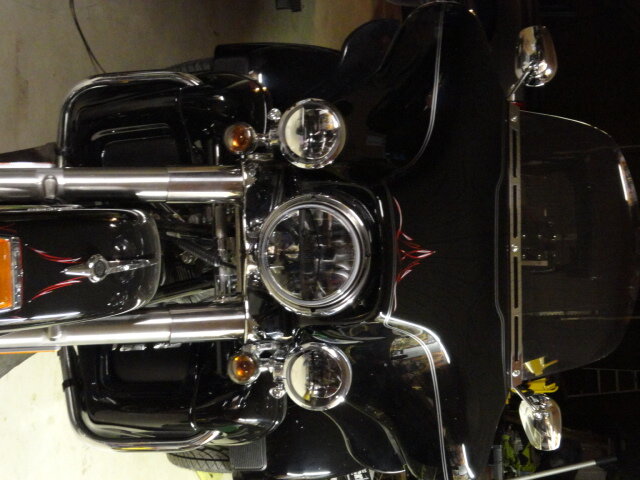

Truck lite for old Shiney DSC00268.JPGDSC00550.JPGDSC00551.JPGthese made to world of difference now three years old looking to possibly upgrade again. LED light has come a long way in three years. Please don't get me wrong these work fine however if I can see better for a few dollars I'll pay it.:D ride safe Fred
