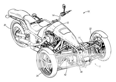

This is the trike they applied for a patent on. A leaning, reverse trike design. Thanks Larry @ Champion Trikes for pointing this out! You've always got the correct information. Here's a link to the whole story: Harley Trike Patent
Zook, the patent apparently is real, but that particular article is from 2007. Does Larry @ Champion know of any articles that might be more recent?
Well then I guess they have two separate trike patents...my mistake. Dont drawings have to be submitted? Are there drawings attached for the patent you listed Dave? When I clicked the link on that article to read the patent language, the link was dead. I should have researched it further before I posted...sorry.
Yes Spirit this article was from 2007 but I guess we wrongly assumed that the patent for that application had finally been issued. As I said before, I dont think its going to affect the trike industry in any big way but it is interesting to see Harley Davidson so zeroed in on trike developement. Maybe they have seen what we have all been seeing for a very long time and that is trikes are here to stay.
