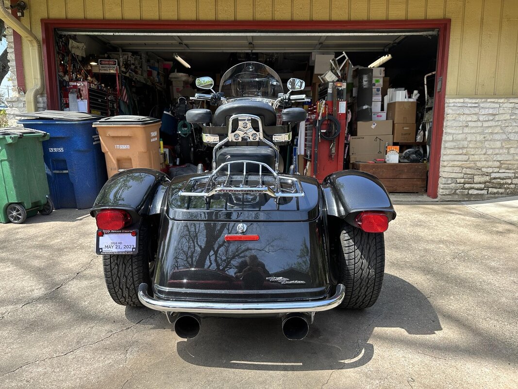

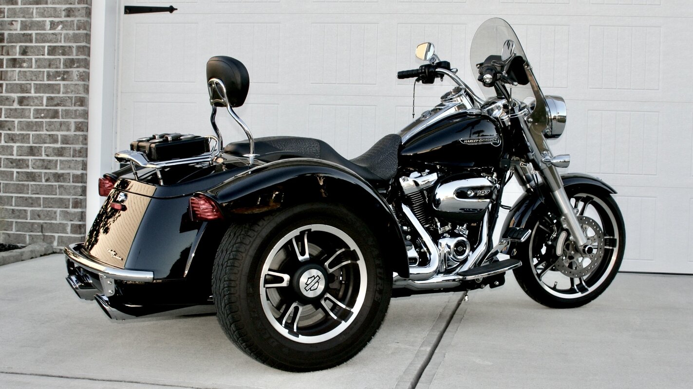

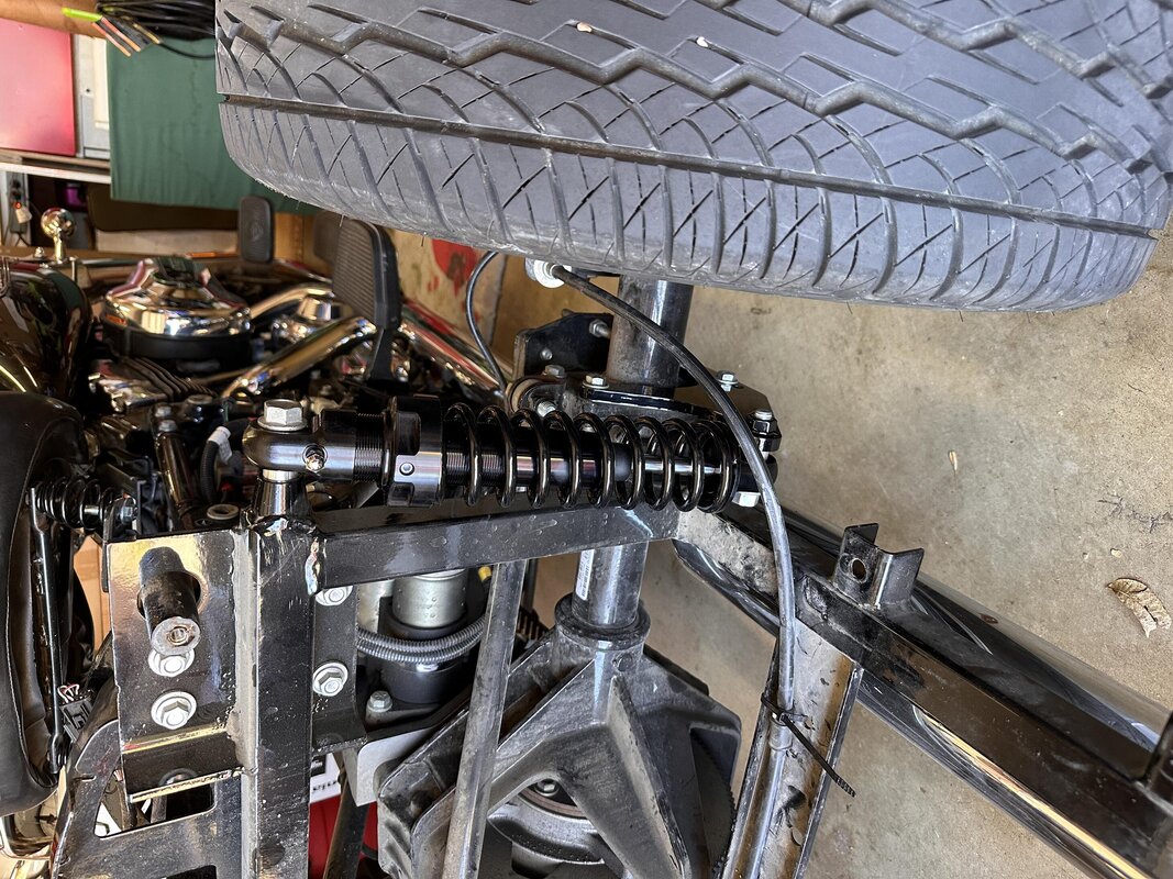

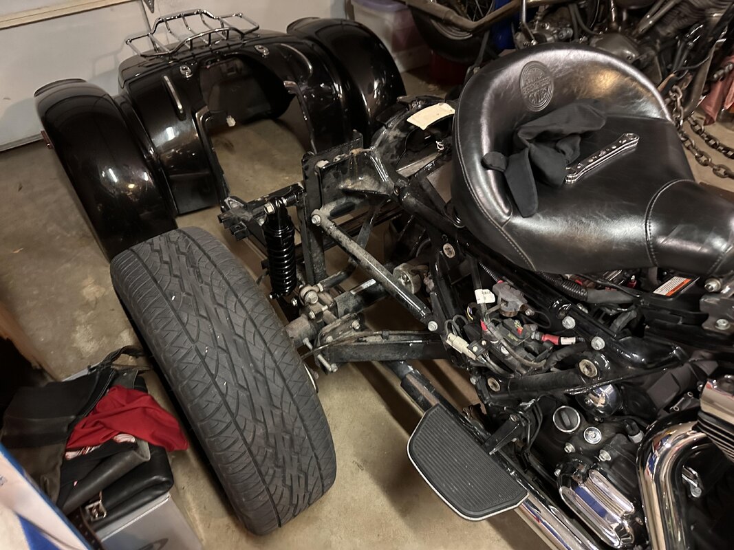

I had the taco box off the first week I had her. Other than the initial test ride, I refused to put any miles on mine until I replaced the 4" unbaffled exhaust tips the previous owner installed. Per the manual, removing the body is the only way to accomplish that. Stupidest setup I've ever seen!

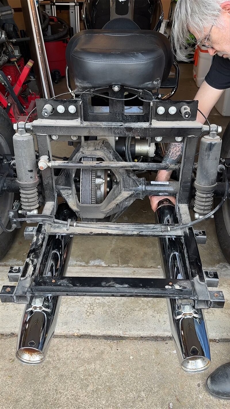

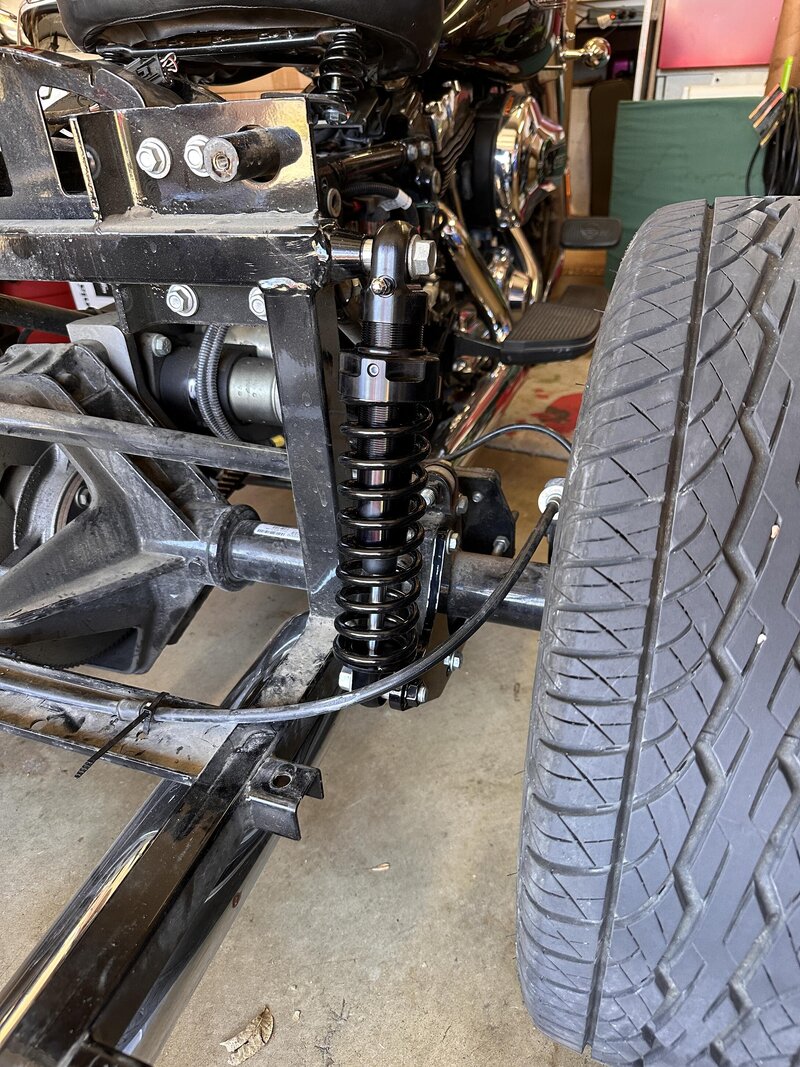

Anyhoo, while I tried to follow the directions in the manual, I'd welcome any hacks or tips someone with more experience might share.

No deceased rodents....
Looks like you got body removal down. Good time to clean things up.I had a petrified dead squirrel up under there. I'll add I use lots of blue painter's tape. The 13" Next Gen didnt require a lift but some other models may.
No dead squirrels, just those gawd-awful 4" cones. Ugh! I'm actually one of those guys who believes loud pipes do save lives, but there are limits! :Dorag:
Excuse my ignorance, but what was the painter's tape for? 🤷🏻*♀️

The blue tape is to protect the paint. Especially around the louvers where the exhaust pipe extend. Along all the lower fender ridge lines..you get the idea. Dont forget where the seat extension "tongue" extends toward the bulkhead. Murphy loves people that remove trike bodies!

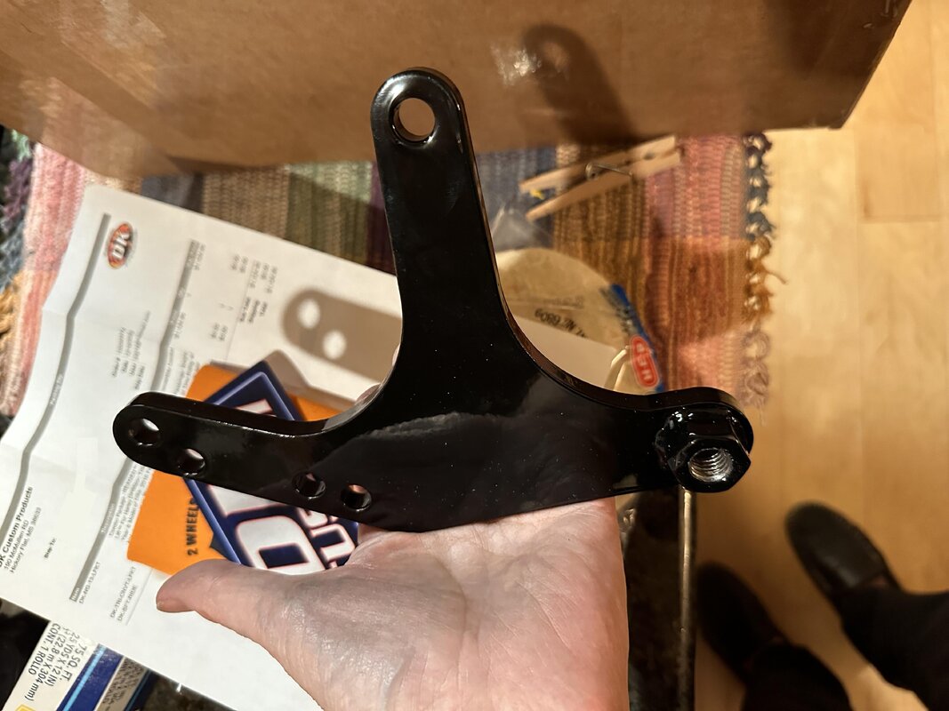

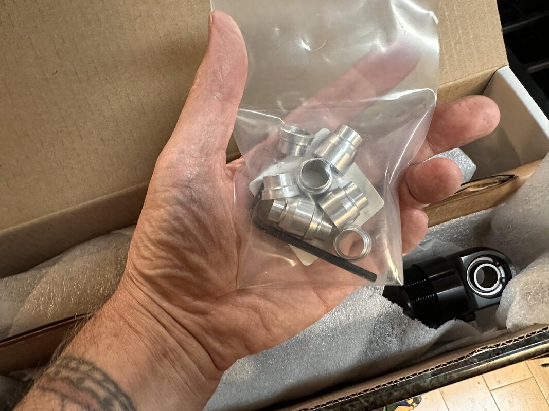

The bushings that will be required for installation.

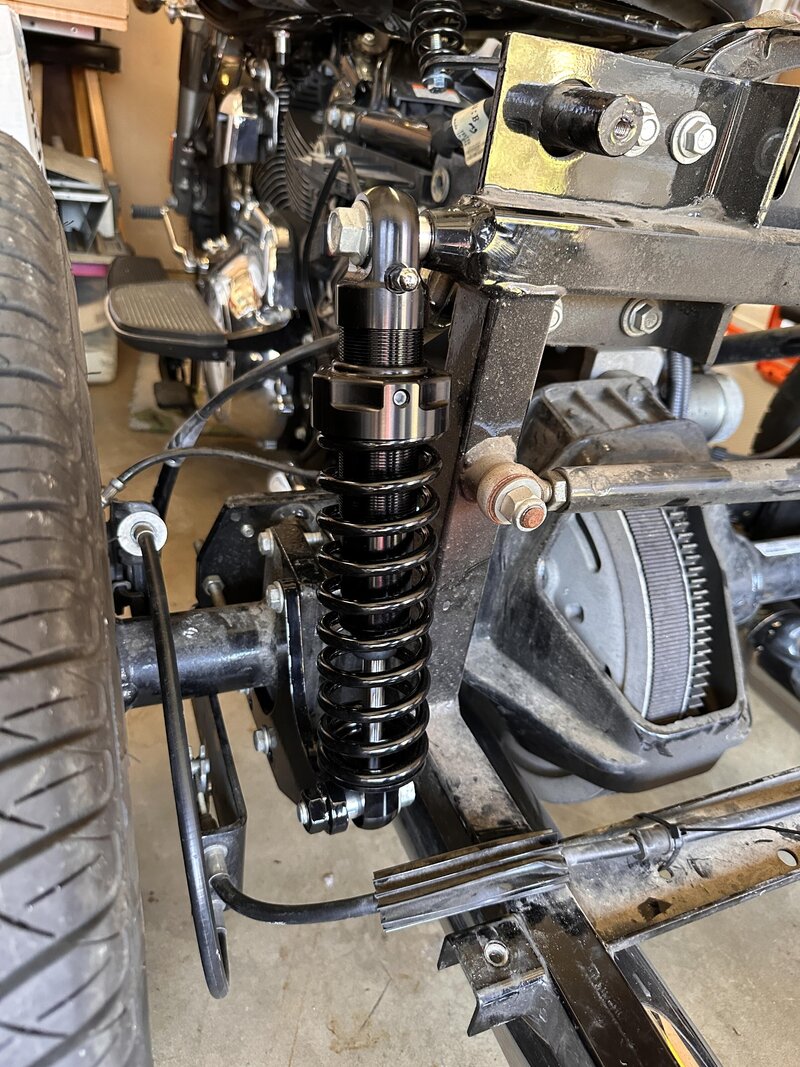

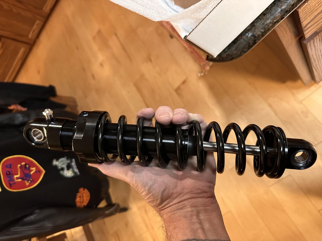

The main event. If you love well-made things, these certainly look the part! Give me a few days (family obligations intrude) and I will begin the install.

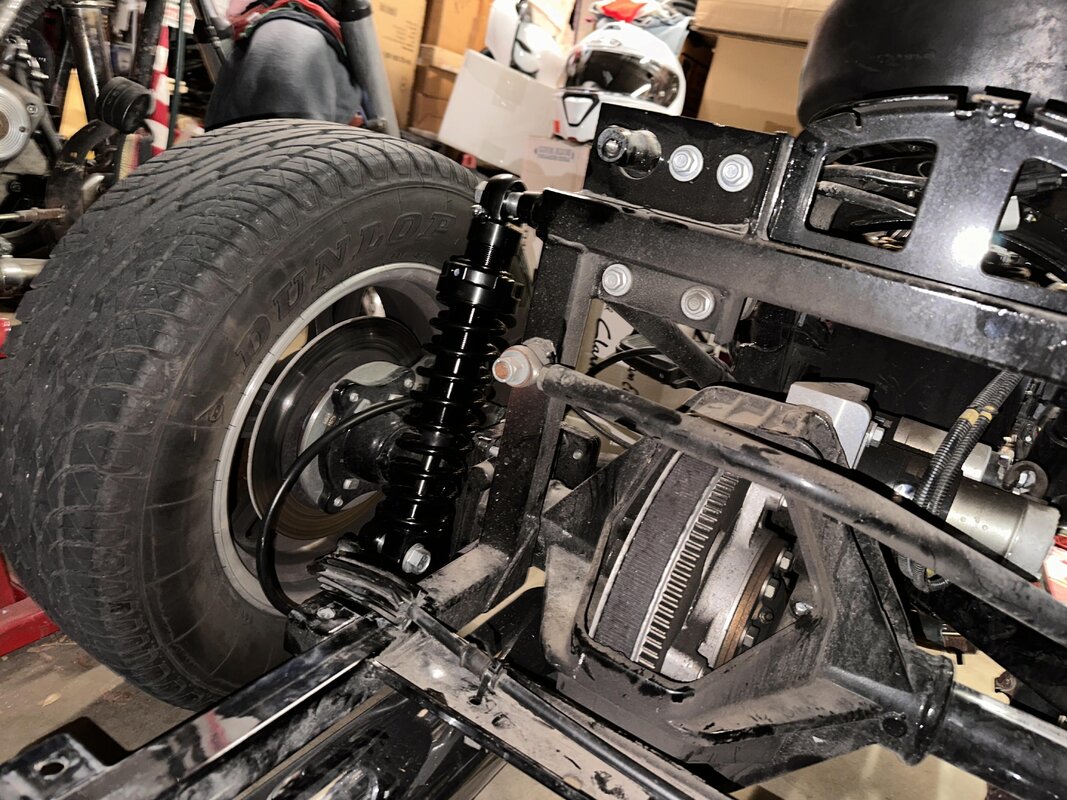

It’s not a hard install , other than the top shock bolts being a bear to remove . HD used a tube of white lock tite to secure them . Replaced mine with body on , have bandaids by your side .

What's the purpose of the lift kit and is it necessary to use with those shocks? I really don't want to lift my Freewheeler. I like it where it is.
Take the body off. It is 6 bolts and one plug. You will save yourself hours of frustration. I have had the body off my freewheeler twice, takes about 15 minutes.

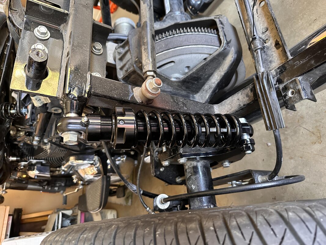

When I first installed the 14" shocks I had to compress them about 1/2 inch even with the swingarm in full droop, thus giving up that amount of travel. The lift brackets eliminated the need to compress the shocks thus I am getting the full 4" of travel. It raised the rear ride height less than 1/2"
