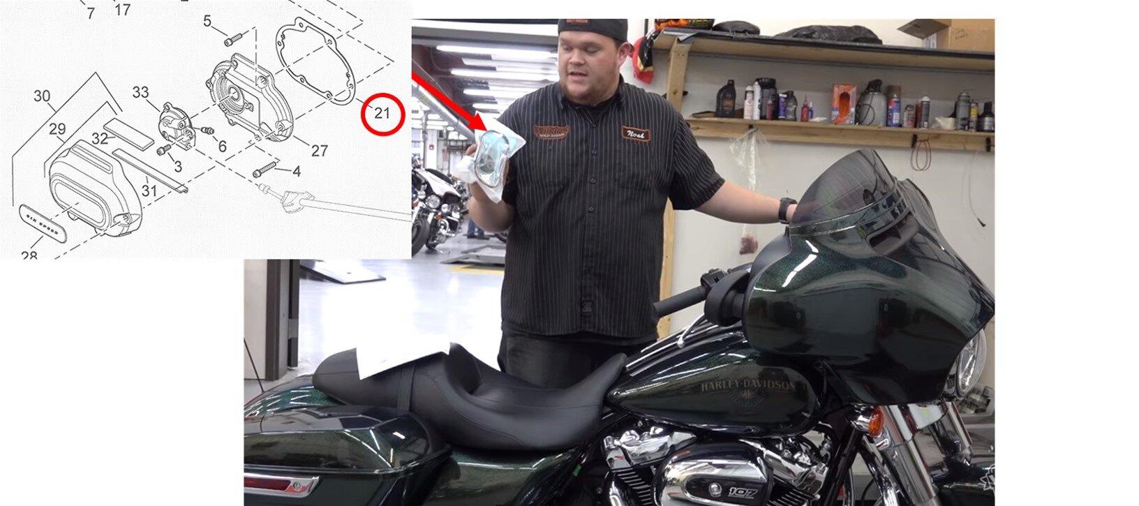

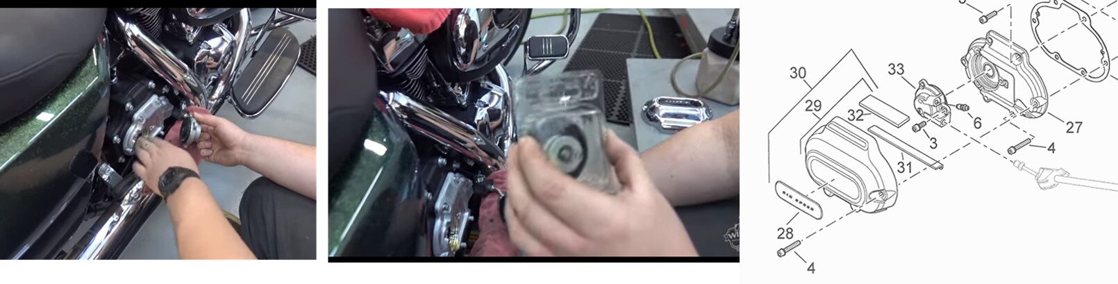

It is the seal on the back of the secondary clutch actuator (item 33 below). You can see the original installed and the replacement part from the kit in the video captures below
Look when he is holding the parts bag, I see what looks like a door cover gasket and the piston with the seal already installed
I dunno why the door would have to come off, the piston appears to deal the slave cylinder to the door. I am wondering if HD is wanting to check the inside of the trap door?
I do not trust this fix:p
I see the seal your talking about Jack. I'm just guessing, but they may change that seal if after the piston/seal change, it fails the leak down test.
I can imagine what the DOT 4 does to certain seals if it eats paint.:confused:
Ah! I see what you're referring to Jack... Looks like the kit does come with a tranny side cover gasket. To MDO's point, likely backup in case the pressure test fails.... And I would agree that the fact they are sending 230k + cover gaskets out with the recall kits says there is likely a potential failure mode for the gasket or its intention that is not discussed in the recall letter.

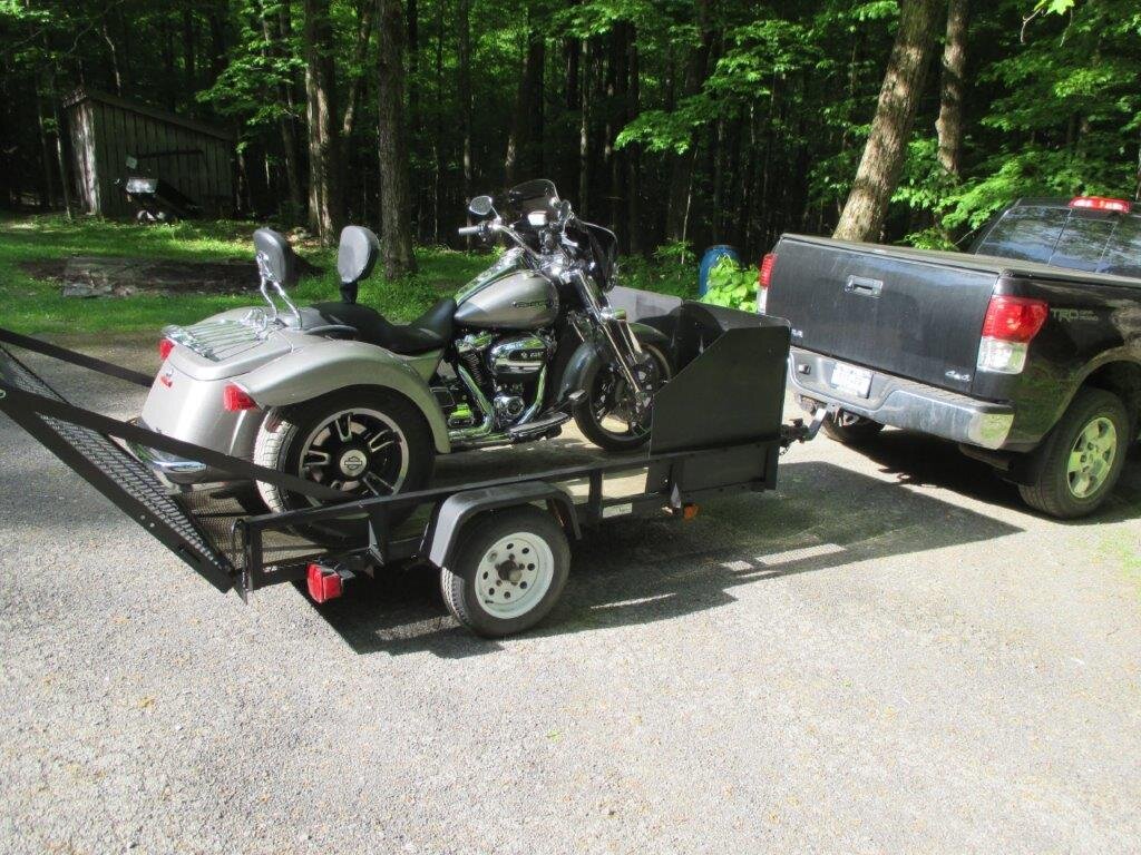

The extend-a-trailer tagged along like it wasn't even there and the bike rode comfortably with no complaints. A couple extra steps to load & unload but overall a nice low budget setup for the rare times I will be needing to trailer the bike.

Here is a link to the clutch recall performed on a trike. Note to all- he has a different recall kit than the previous video??? It's a new derby cover O-ring.
AHHHAAAA, I thought I saw another gasket in the earlier post. I thought it was a tranny door gasket. Now it makes sense after checking the clutch plate lift to replace the derby cover o ring ;)

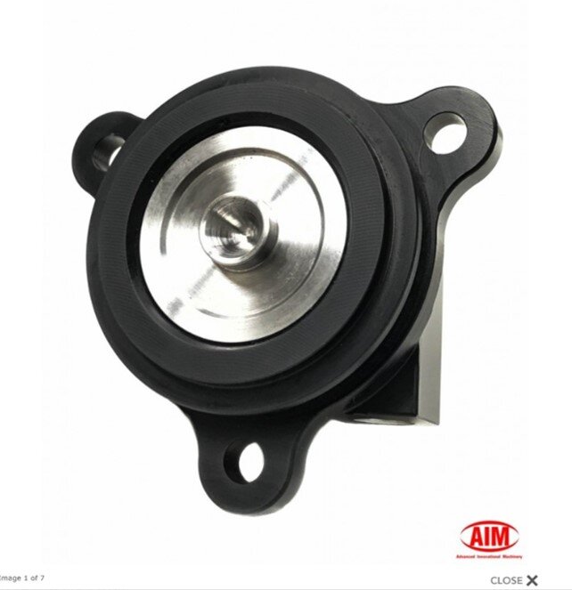

Didn't know if you had seen the working end of the AIM unit MDO found...but I agree with him... this is looking better and better
It seems that the AIM piston has a bigger surface area. I wonder if that, in combination with a different spring, makes the 40% reduced clutch pull possible .
If I have any problems at all with the new OEM parts, I'm dropping the $280 for that unit. It's too important to be messing around.
Side by side, HD one on the right
The AIM looks way better to me;)
What do you think would cause their part to reduce clutch pull ?
I would like to see the back side of theirs like John Maxwell showed on the recall repair in the video.
Depth or length of piston, if you look close you will see the difference in the pocket that the push rod sits in
I am wondering what the bore of the cylinder is? I know it has a steel piston ( The HD Brembo looks to be aluminum)
