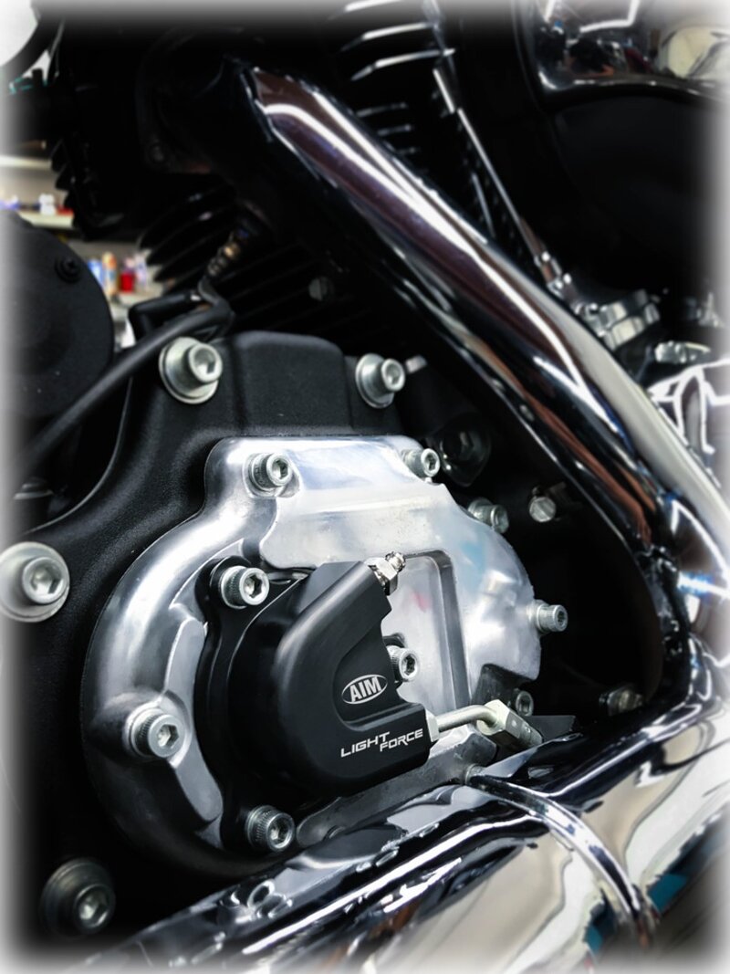

The HD hydraulic clutch is a classic example, when it gets TOO hot it can fail without warning, once cooled down SOME come back to life, tho I would not trust it
IMO, if Harley did not cover up the slave cylinder ( with a cheap chromed cover) and move the exhaust a bit more many of these slave cylinders would be working better and longer JMHO
JACK, that aftermarket AIM slave cylinder is starting to look better!
Jeff, I think it should do fine in the un shrouded look unlike HD hiding behind a faux cover;)
I too miss a cable clutch, at least we could adjust the free play
I think you still install the cover, they just left it off to show off their cylinder. I'm getting the recall done , but when I find $280 laying around, I may order 1. The 40% less effort is a great selling point. The OEM HD cylinder is priced at around $60. If I was an engineer/machinist type, I would get 1 & modify it!

Played with a bike that had the AIM Light Force slave cylinder. The clutch pull is indeed light, but the major improvement was the clutch started engagement right near the grip instead of at the end of it's travel. Very easy to modulate now.
