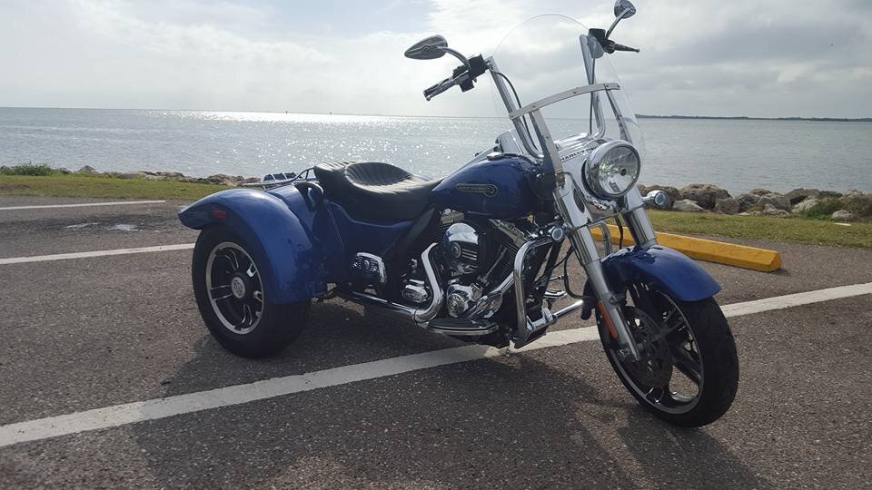

I added Roadking tallboys to mine. Brought them a little taller, back and closer together.
I added Roadking tallboys to mine. Brought them a little taller, back and closer together. Very happy with them.

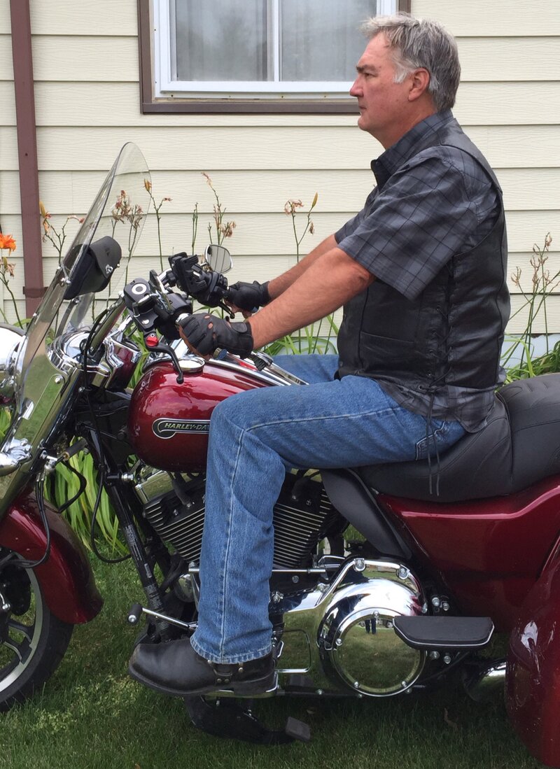

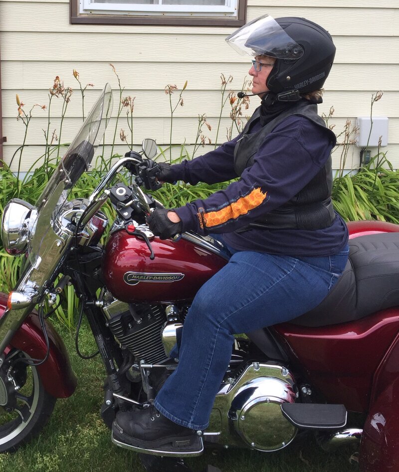

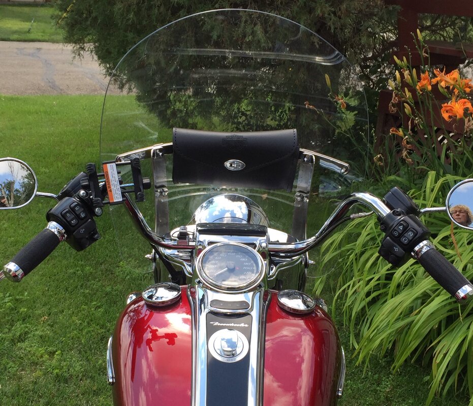

Could you take a side view from a little further back and post? I am wanting to change mine this winter. Also, what else did the have to change to install them?
bars
how high are your tallboys and did you have to change cables, wires ext
Tallboy bars
Here is a comparison. I am 5'4, have a Mustang reach seat, and adjustable clutch and brake levers. My husband, Jim, is 6'2 and the seat is too forward for him so his hands aren't positioned correctly. They did have to change the grips since they're glued on. I hope this helps. Also, back to the original poster. I had a stage 1 exhaust system installed because the heat on my right leg was almost unbearable. The cost was around $1300 and I wish I had included it in my loan.
Just some food for thought.
I stand corrected.
My husband compared the stock bars with these and they are the same height. They are pulled back more and closer together. Wire and cables did not need to be changed.
I assumed they were taller because, hello, tallboys!

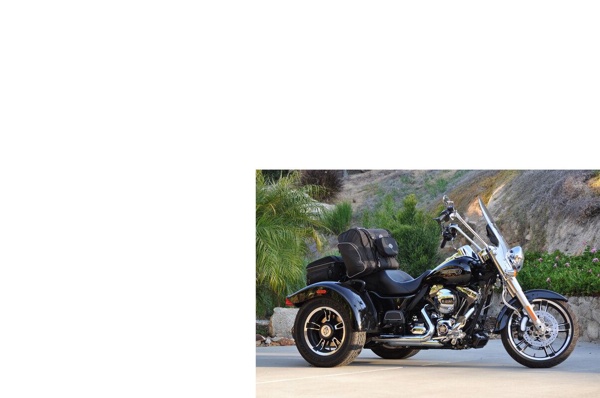

Otis at sunrise best copy 3.jpg When I got Otis in October of 2014 there were no bars in the aftermarket designed for the FLRT so we had to improvise a bit. We found a set of 19 inch apes that, when laid back, fit perfectly. I've put 29,000+ miles on Otis with these bars and they are perfect. I lean against my backrest and the grips are perfect. The installer/dealer and I were both amazed it required a set of 19 inchers to do the job but that's what it took.

View attachment 39029 When I got Otis in October of 2014 there were no bars in the aftermarket designed for the FLRT so we had to improvise a bit. We found a set of 19 inch apes that, when laid back, fit perfectly. I've put 29,000+ miles on Otis with these bars and they are perfect. I lean against my backrest and the grips are perfect. The installer/dealer and I were both amazed it required a set of 19 inchers to do the job but that's what it took.
I tell ya, Otis, your FW looks sweet! 19" would likely be too much for me, though as I only stand about 5'9". I'm hoping the 16" my dealer is offering will work for me. The stock just feel too low, even for a short guy like me.
