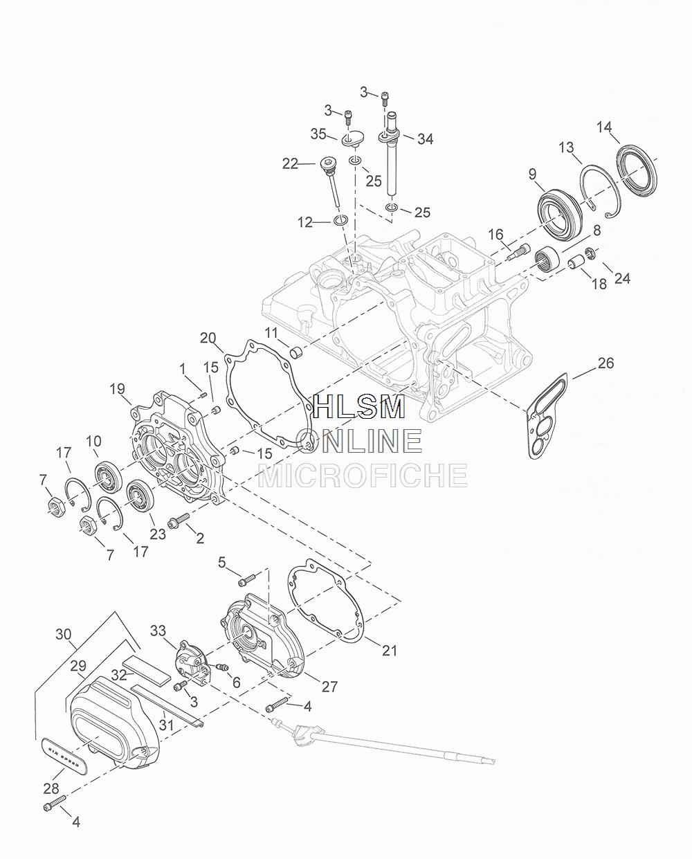

I'm not there yet, but I didn't have a clue how to flush the brake fluid out of the hydraulic clutch.
I researched it by watching a video on Fix My Hog. They are putting together a video on every item on the maintenance checklist for the M8.
It's a little more involved than flushing/bleeding brakes, as you have to remove a false cover on the right side of the engine & on the touring model they were working on, they had to remove the exhaust heat shields to get the cover off & access the bleed valve.
2 items I learned were that the clutch system seemed to get dirtier than the brake system & unlike the brake system, were the fluid level in the master cylinder goes down as the brake pads wear, in the clutch system, the fluid level rises, so that is something to be aware of & keep an eye on, as it could lead to an over pressurization situation.
Have not done this service but I verified what you said per the 2018 Service Manual. Manual says you must loosen the entire exhaust system in order to move it enough to access the screws on the outer clutch cover. Sure hope that's not necessary. Removing the heat shields is no biggie but dropping the exhaust is more involved.
The video I saw showed them doing the job by just removing the 2 heat shields & that gave them enough room to get the cover off, just barely.
I have not had a chance to look at my Freewheeler yet to see if the set-up is the same, clearance wise.
Scroll down to see the side cover and actuator with bleeder
