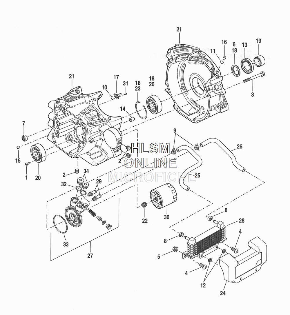

Be careful removing that plug, if it dont come easy stop or use a heat gun on it
OR u could take the RS cover off, the one below the tappet blocks, u may have to remove the exhaust and maybe the floor board
The oil in the crank case should drain out of there , u can check your cam chain tensioners at the same time A 2 for one deal
The crank case and oil galleries will hold up to1 quart of oily water mess

If the op is talking about #2 below that is the casting plug and it is REAL tight and been known to BREAK the case JMO
