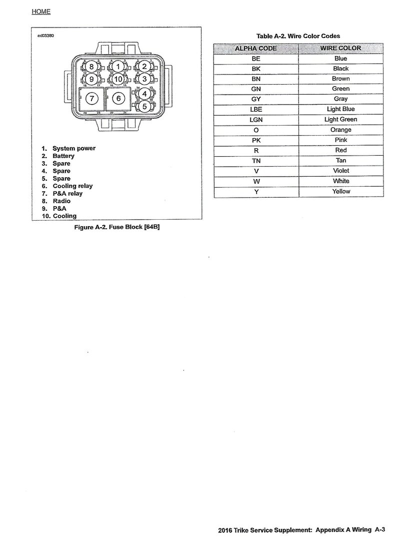

2016 Trike Supplement on Rear Lighting Wiring
Alan, I scanned the pages below from Appendix A on Wiring from my 2016 Trike Supplement Manual. Page A.3 showed me the Pin Layout, the Run/Brake/Turn Circuit and Wiring Color Codes for the Rear Lighting Connectors (Male & Female Ends). The last Page A-2 identified the Wiring Color Codes. This gave me all the info needed to connect the Posi-Tap Connectors on DK's Harness to the correct Run/Brake/Turn wires on my Rear Lighting Connector in Table A-4, Figure A-16.
If you have a Trike Supplement for your model year, it may have the same info.20190523_215824.jpg

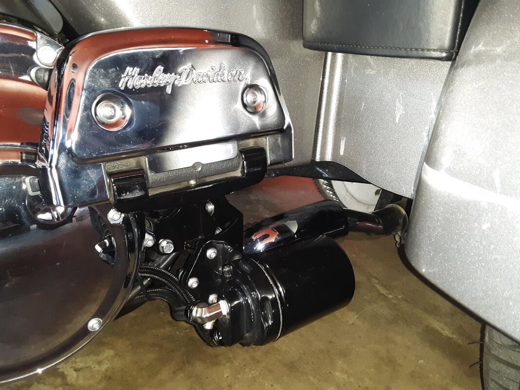

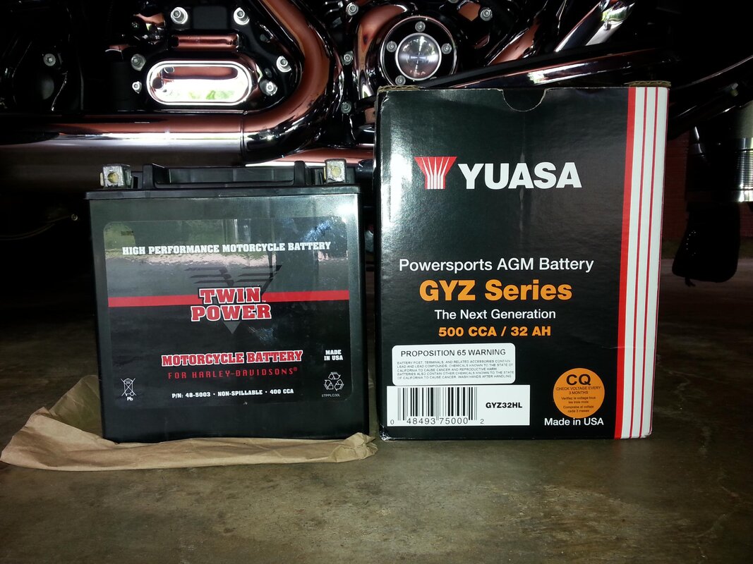

Finally decided to do the Oil Change and install the Cool-n-Clean Oil Filter Relocation Kit. Installation was easy, followed the enclosed instructions. I chose to use the optional Black Fiber Braided Hose and Black Hose Finishers. As usual the quality, fit and finish of all parts was excellent. Also, installed the new Battery that's been setting around for several weeks.
I now feel confident that the Trike is ready for the trip to SE Michigan in 6 Days and a Wake-up.
Cool-n-Clean Oil Filter Relocation Kit....No Runs, No Drips, No Errors20190529_221923.jpg

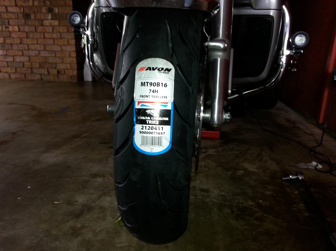

Cobra Chrome Trike Tire
Removed the front wheel, then took it over to an independent shop that mounted the Avon AV91 Cobra Chrome Trike Tire...they also added my Dyna Beads. Remounted the wheel, but due to bad weather rolling in, there's no chance to get any "Break-In" (Avon calls it Running in) dry miles. Not really sure what handling or riding character to expect with the Dyna Beads Balancing?
The only other concern I had was to ensure that the newly routed oil filter relocation lines along the frame did not get pinched or damaged when jacking the front.

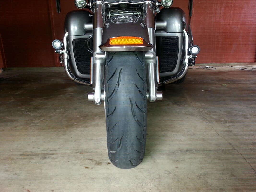

Vibration Through Bars

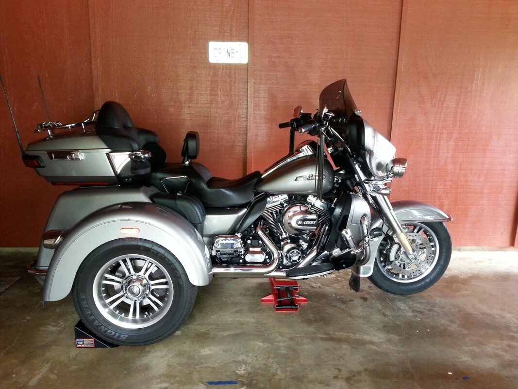

Yea, to me it looks a bit huge compared to the Dunlop. Makes the wheel look so much smaller in comparison. Was able to put 103 miles on rural roads between breaks in the rain.
I can feel some vibration in the handlebars at 50 to about 60 mph, so I didn't push it much beyond that. Could be a balancing issue, but I did decrease tire pressure from what the installer had set before putting on the wheel. So will step up from my adjustment of 36 psi up to 38 psi and see if the vibrations remain at those same speeds. If need be will go to 40 psi and see if their are any changes. If neither change gives positive results will get with the installer to find a cure.
These are best shots I can get....still show it's indeed a beefy tire!
Since the oil relocation had been completed and the oil filter's no longer hogging space up front, I rerouted new hose from EBS and repositioned the Catch Can in center underneath. This adds just a bit more ground clearance to bottom of can.

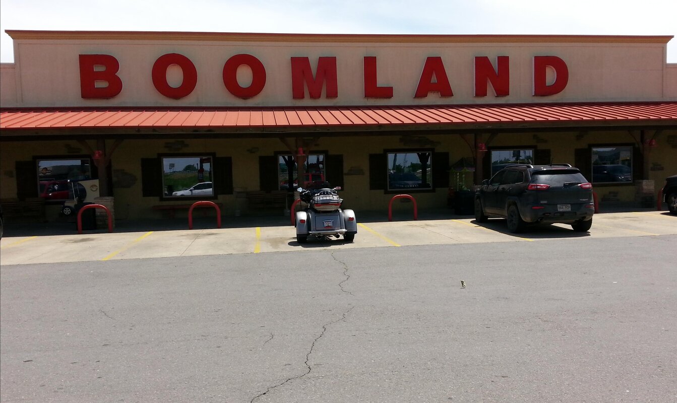

Boomland is always a must stop on this route.
Effingham, IL Arrival Miles
It's a popular stop for travelers, because they have a warehouse size fireworks room, another warehouse room with a huge selection of gifts,collectibles and a restaurant. I believe they actually have four Boomland locatioins. The one I always stop at is on I57 in Charleston, MO. For me it's a nice place to fill up, then take a break from the road and then wonder about. https://boomland.com/charleston-mo/

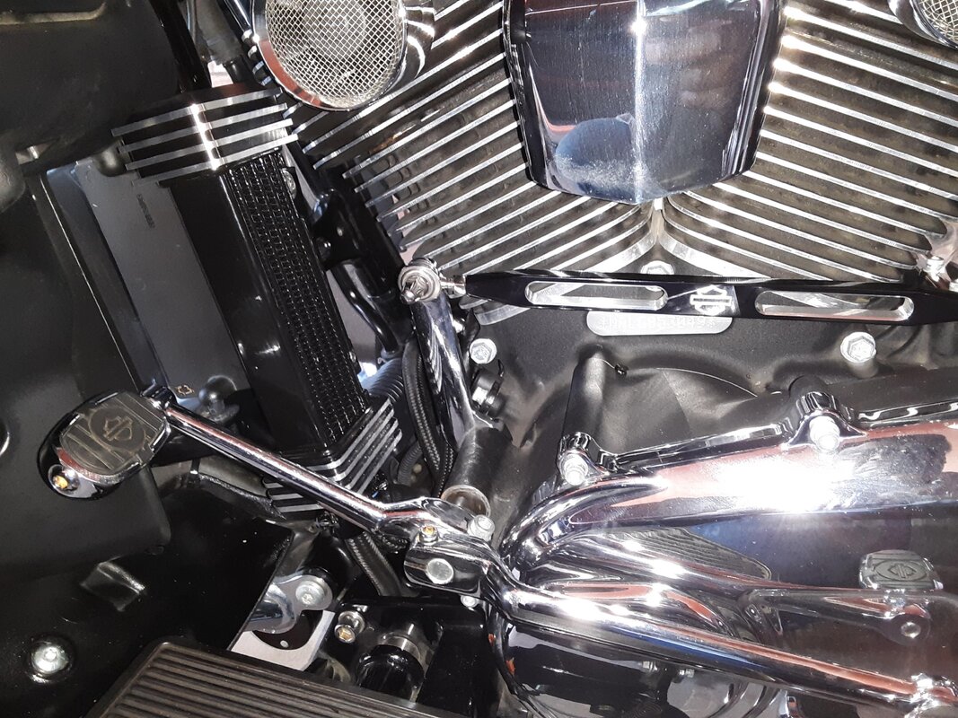

Oil Cooler
Changed the Oil, installed the DK Custom Oil Cooler, rerouted the Braided Lines to the Relocated Oil Filter and cleaned the Catch Can.
All went smoothly, but those braided lines sure don't flex like rubber hose in tight spaces.:blush:
Thanks to Kevin, I'm more at ease now after getting those Braided Lines above the Frame Rails.:) The Catch Can was pretty gunky too, so will start cleaning at every oil change.
Warranty Return
Had the Avon Cobra Chrome Trike Tire removed and the OEM Dunlop reinstalled. Buzzing vibration @ 55-60 no longer felt in the handlebars. Dropped the Avon off at UPS and it's headed back to Revzilla for Warranty Processing.
