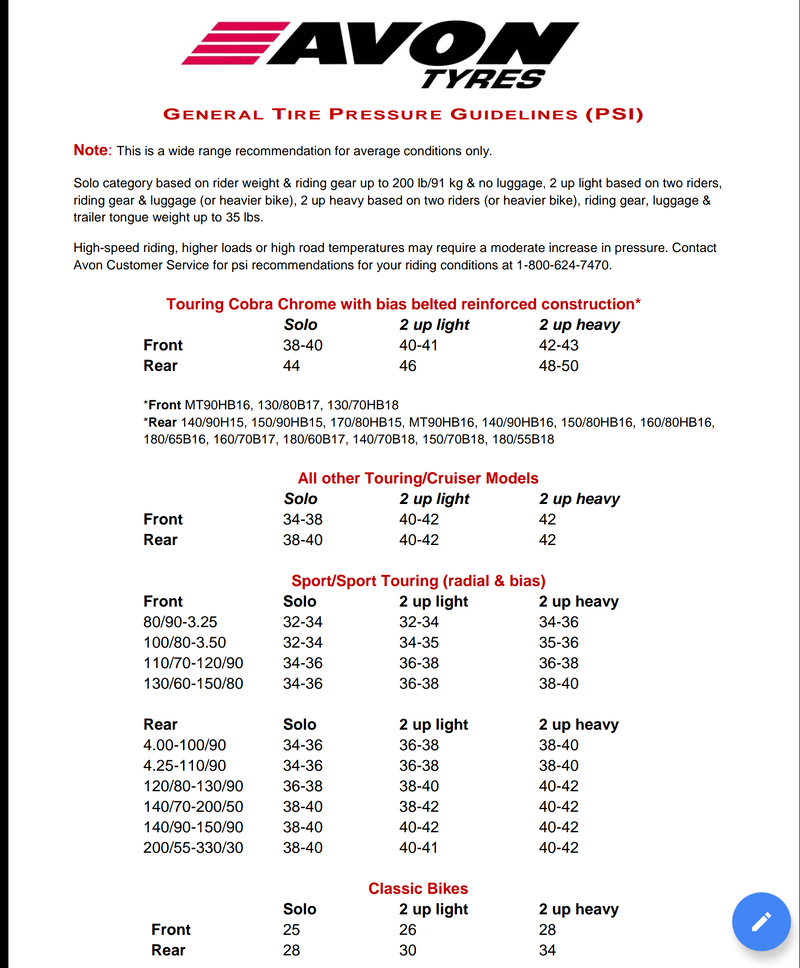

I'm curious, as I have an Avon Cobra Chrome front tire to install around spring, everyone having the trouble, what psi are you running them at?
I rode from Denver to Nashville right after I had the Avon Trike front installed. We decided to check our tire pressures and torque on the lug nuts in Nashville before heading on to Johnson City. Found out there was only 30 lbs of air in the new front tire! Pumped it up to 36 because I wasn’t sure what it was supposed to be, but was pretty sure 30 wasn’t enough. When we got back home, I did more investigation and found out it’s supposed to be 40-41 lbs (I think). Haven’t ridden too much since I fixed the tire pressure, so can’t say yet if the ‘buzzing’ feeling in the handlebars is gone or not.
So not a lot of help for your question other than letting you know that 30 lbs definitely isn’t right!!
I test rode with pressures at 38, 39 and 40 psi, mainly because I was hoping for relief fron the buzzing vibrations I felt through the bars . Unfortunately, there was no change in the vibrations. For me, it seemed the best comfort when riding solo, was @ 38 psi. Here's a snapshot of Avons General TP Guidlines.

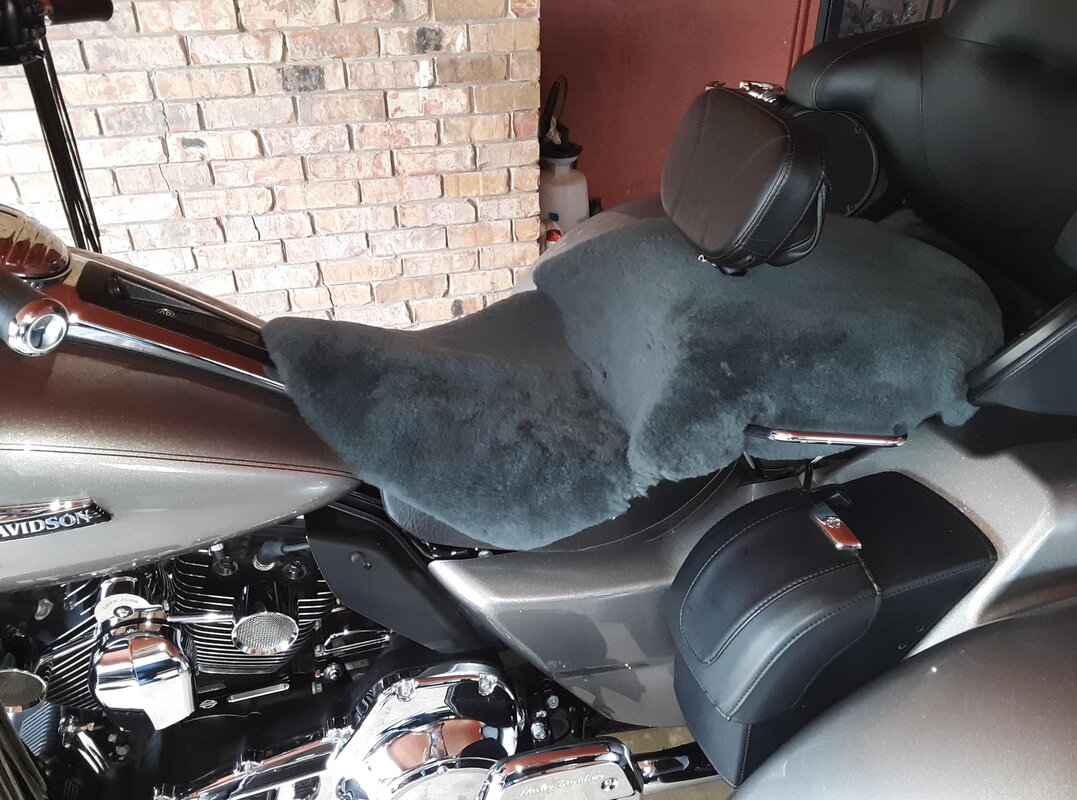

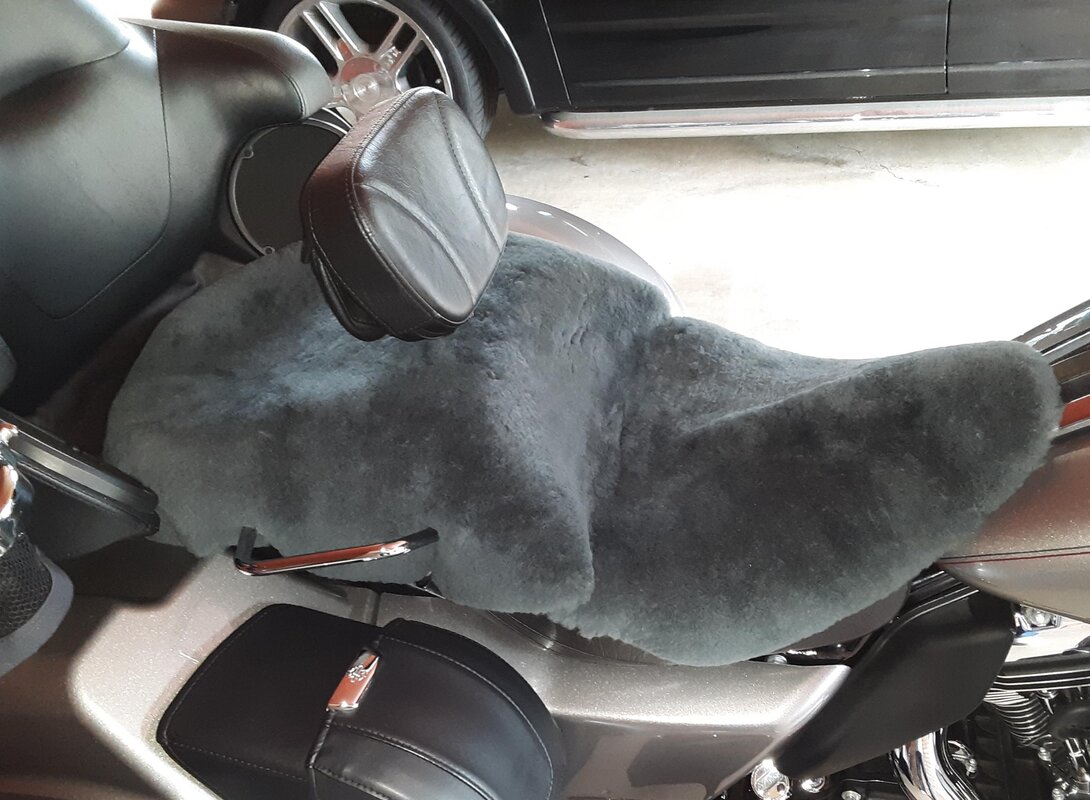

Replaced my Long Haired Black Sheepskin Cover with this 1" Sheared Medium Plush Charcoal Grey Cover. I cut the lower drivers section shorter to allow more air flow and not trap the hot air moving up from the engine. Prefer the look of the new short haired sheepskin over the previous long haired sheepskin cover.20200406_194336.jpg

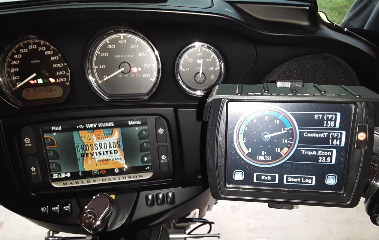

Changed to a new PV Gauge Setup (Voltage, Eng Temp, Coolant Temp & MPG)20200406_195421.jpg

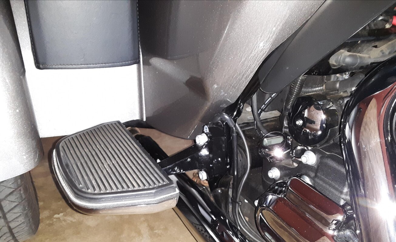

DK Custom Passenger Floorboard Relocators - should reduce heat to passengers feet & provide more sitting comfort20200406_195726.jpg

I like the seat cover. Where did you get it?

Hey Kevin, Don't mind the questions, that's why we're here to share information and help however we can. Only Gold Members get use of the personal message function.
No I didn't send my seat out, because that was a bit more than I wanted to spend. So, I did my own fitting and used a marker pen to make my own seat outline on the back of the hide as to where to cut. I then cut from back side following my outline using a snap-blade retractable utility knife. Anyone that's a bit unsure, can cut slightly outward past their markings, then test fit and trim more off as desired. I don't recommend anyone use scissors to cut their sheepskin!!
As of now I dont have any attachments on it. Just have draped over the seat with slot cut for the back rest and wedged between the grabhandles and tucked/stuffed into the cavity under the passengers backrest flap. I know it stays tucked on rural rides up to 60 mph, but at interstate speeds it comes out and constantly taps me on the back.:laugh: So, I bought a set of Coleman Sleeping Bag Straps, they have a non-slip buckle, so one could easily fit around the sheepskin and seat in the rear, and hold it in place to stop the flapping as higher speeds. Know this will work because on my solo trip to Michigan last year, that tapping got so annoying, I had to pull over and improvise a similar method using an extra belt from my luggage. So a belt or one the new Coleman Straps will work, they're just visible when you're up close.
The idea I'm toying with is, hand sewing or tacking one of the straps underneath to the backside of the hide in four locations, two relating to top of seat and lower on each side close to the bottom. This will hold the rear part of the sheepskin in place on solo rides at speed. However, it will require unbolting and lifting the rear of the seat each time to install and remove the cover. I suppose it also provides a bit of security for the curiously honest among us.:D
Sorry for the long reply, but it also helps me to think out loud as to how I want to resolve the solo flapping, but also keep the covers seemless look.

That is awesome information. Exactly what I was wanting to know.
Thank you very much!!

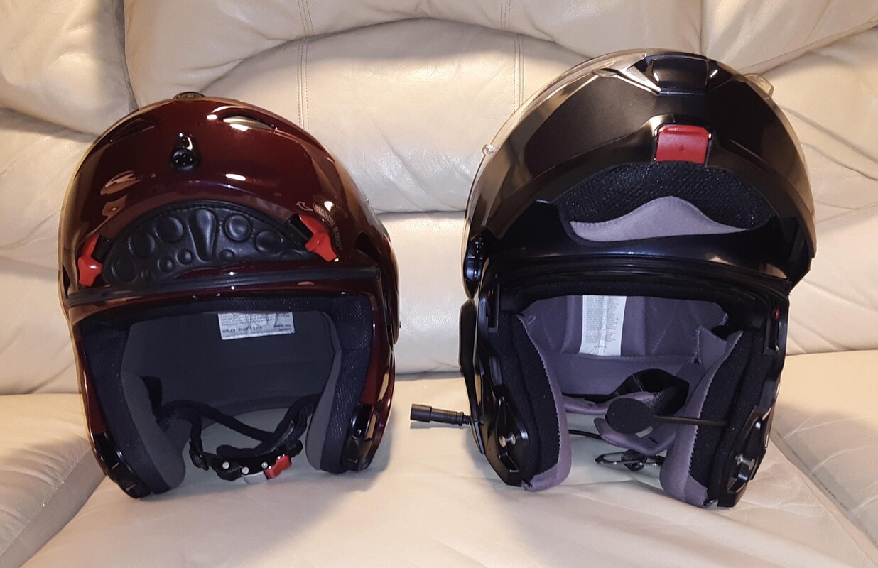

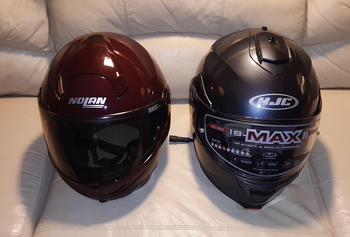

My modular helmet, a Nolan100E, was my go helmet for Michigan cold weather riding when I lived there and I've used it for riding in other other adverse conditions after relocating......it's about 14-15 years old now. Nolan like others manufacturers only recommend a 4-5 year useful life for a helmet. But my trusty 100E was hard to give up, it just seem to fit me like a great pair of Ostrich Boots. The thought of replacing it with another comparable Nolan was at a price point that's simply not in my budget. Current climate calls for a bit more frugal spending for a helmet.
I went in search of another modular helmet with an affordable price, but one that also had; convenience features, was well constructed and DOT Approved, and it had to be light weight. Checked out several, but already having bought an HJC Helmet in Dec 2018, and being pleased with the HJC LS2, 3/4 Open Face w/Shield. I thought why not give their moderately priced Modular Helmets a good look.
Bottom line: I just received an HJC IS-MAX II Modular.....it met all the criteria I mentioned earlier. Only slight Con is, it has a bit larger profile than the Nolan!. So, probably going to have a more pronounced Bobblehead Look!!:D Have washed the headliner, cheek pads, chin curtain and sanitized insides and outside. Last night, reinstalled everything back and added a new wired head set. Looking forward to a test ride whenever the strong thunderstorms and torrential rains leave the area.......around here we're wondering, how long before we see a full week of dry weather and sunshine!!:Shrug:

You're going to like the HJC IS Max. My wife and I have been riding year round with the HJC IS Max helmet for many years. In fact we're on our second one know and think they are fantastic. Now I've not tried Nolan or any of the other 'premium' priced modular helmets but this one sure fits the bill for us. Very comfortable and does not restrict peripheral vision at all and that's very important. Even on the hottest summer days we don't find wearing this modular helmet to be a problem. In fact I like it rather than having a blast of superheated air in my face.
That's really great feedback coming on the heels of my new, but yet to be used IS-MAX II.ThumbUp The Nolan I bought during my working days in Michigan, at a time when cost was a lesser concern.;)
Now if this monsoon like weather let's up, I can give it some nice trial runs!
