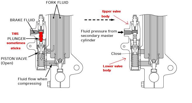

No 1 - Is more than likely correct. The AD plunger is notorious for sticking, thus causing a blockage, and making the front rough ridding. A stuck plunger is most likely the cause of the left seal going out long before its time, but when the seal is changed and the upper tube isn’t surfaced i.e.: sanded lightly with 1000 wet/dry there could be something not readily visible in the motion area of the tube that can and will take out a new seal. Also look extremely close in that area (about 5 inches up, and down) for any vertical scratch or gouge. Often a scratch is undetectable by eye, but can be felt with a finger nail. A dried on bug part can take a new seal out.
No 2 - The AD is activated in two ways. By the rear peddle which is linked to the front in a 60/40 through a proportional valve, and by the secondary brake cylinder which is on the left fork, and is activated when the fork starts downward during breaking, usually via the front lever. The front break by it self does not activate the AD.
However, when I had the AD apart I firmly depressed the front brake and noticed that the plunger did not move at all. However, when I depressed the rear brake the plunger came out about ¼”. Does this indicate that I may have a problem in the secondary master cylinder? If so, would a complete flushing of the brake fluid take care of the problem?
See Above: and flushing the system will not unstick a plunger. You did that when you separated it and moved the rear peddle with no resistance on the plunger. The upper plunger that you saw move out is 90% of the time the culprit, but the plunger system is a two part system. The bottom plunger that you more than likely didn't even look at, could very well be stuck down also. Press down in the small hole with a drift punch that will fit in the center, or something that you can get good pressure on to see if the plunger moves down, and then back up. Both are dry metal to metal with no lube, and either can stick. If the bottom is stuck, just tap it with a hammer to unstick it. Tap not Whack.
I know the bleed-thru valve (I think that’s what it’s called) is working as when I lightly apply the rear brake only at low speeds, I can hear the front brake working as well.
That is the linked system working, front leaver = 60 front 40 back. Back rear peddle = 60 rear 40 front.
To really work on and understand the BIKE SIDE you need to get a Service Manual for the GL1800. The diagrams are very helpful at times like this, where words cant describe it well.

One other question about the lower AD plunger. Can you tell me how far it should be recessed if it is the full upper position?
On the Traxxion: Yes just the springs. I talked to Max, and Mike several times before I got my springs 4 years ago, and haven't regretted it a bit, and the vertical scratch got me on the first seal replacement in about 1K + -
I don't know an exact depression, but tapping the lower housing should release it back to the top ( maybe ), and once the spacer ( nickle ) is in the plunger on top shouldn't come in contact with the bottom, thus disabling it.

Thanks, I should have remembered that since I downloaded and saved those pictures yesterday before disabling the AD. Looking again at the photos, Fred shows that the resting position of the lower piston should be 9mm down.

Open up a beer, then take off the upper fender (4 bolts) and the left mud guard (2 bolts). Unscrew the top of the anti-dive from the bottom half (2 screws) and separate the halves. (Don't worry. Nothing will leak or spring out.) Take a drink of beer then with a small punch or, like I did, a golf tee and press down into the hole in the top of the lower half. The piston inside there should depress slightly and spring back after you release it. If not, lightly tap the housing with a small hammer until it releases. Drill a 7/32nd" hole in the center of a nickel. Place the plugged nickel (always wondered where or when that phrase would really apply) over the tip of the upper plunger and screw the halves back together. Have another drink of your beer, then put the mud guard and fender back on and you have disabled the anti-drive and any related problems. Now you can finish your beer cause it should still be cold.:beerchug:
1. When serviced properly(basically cleaned) at the time of fluid changes, they are not a major problem. Make sure the upper plunger works correctly in the upper half as well as "what it plunges" in the lower half.
