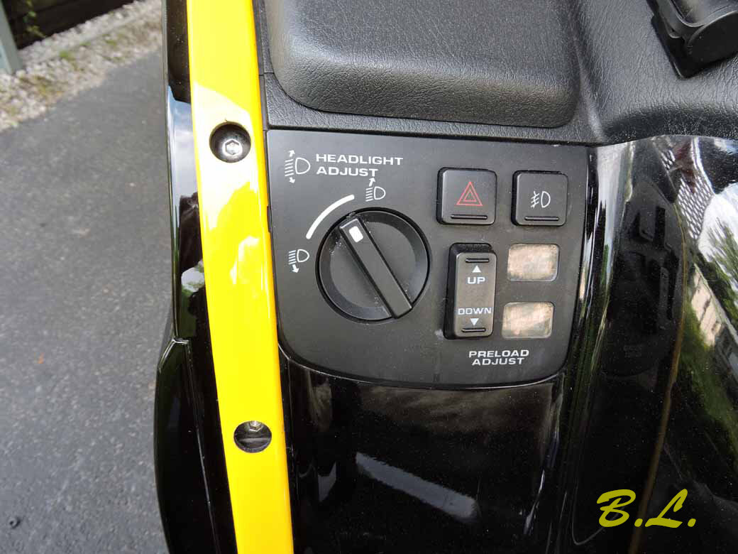

pressure switch in air ride needs replaced, where get?
I have a 2005 Honda Goldwing Motor Trike conversion. I believe the air pressure switch controlling air bag suspension is not working correctly. Where can I find a replacement switch?

1. My voltage meter was not filling in all of the LCD sections when I first start the bike but it would give a full reading after a few minutes.
2. The air pressure switch would only activate the air pump after repeated tries. Sometime it would not activate at all. The air release however would always drop the pressure which made the failure to activate the pump even more of a problem.
I had my mechanic (Luke Ritter at Kustom Bike Worx in Jamestown, TN) do the installation so he could ensure the proper power was being supplied.
The new unit works only slightly better. So I'm not at all sure that the switch unit itself is/was totally at fault.
