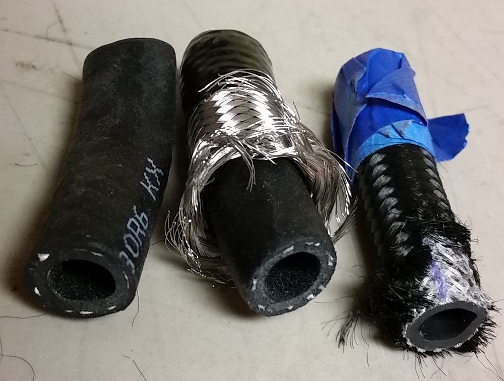

My first look was to the fiber braided hose. I confirmed that it is the same hose used on 10's of thousands of Jagg oil coolers for many years without problem. It is also the hose used by a few hundred of our Customers on Oil Coolers, Oil Filter Relo's and External Breather Systems. It is a quality hose. We purchase it directly from Jagg.
The hose is a nitrile rubber (same as the standard hose and the SS braided hose) that has a metal sheath, then some adhesive, then the black fiber braid. With the black fiber braid pulled away, it looks sort of nasty (it's the adhesive over the metal sheath).
Also, because of the adhesive, it is less flexible when manipulating it.
The wall of the standard nitrile hose and the SS braided is 1/8" thick. The Black braided is 3/32, so that is 1/32 more narrow, but again this hose is proven with millions and millions of miles.

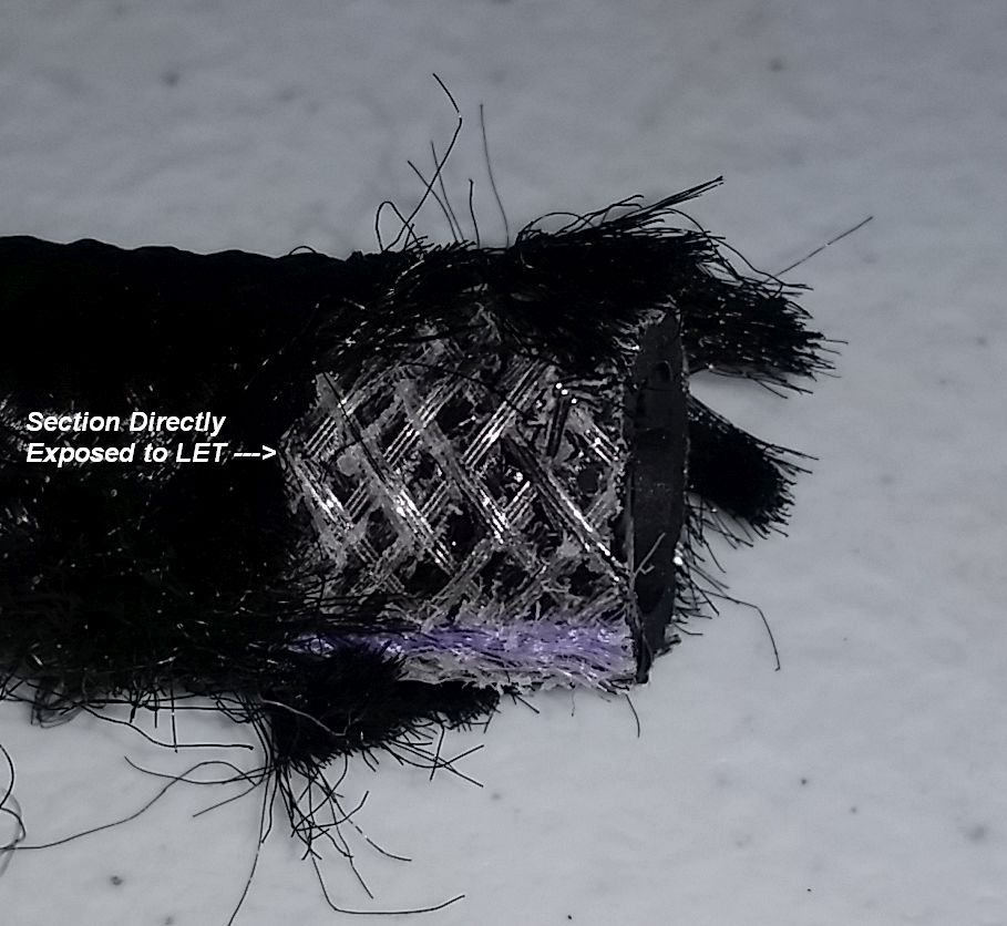

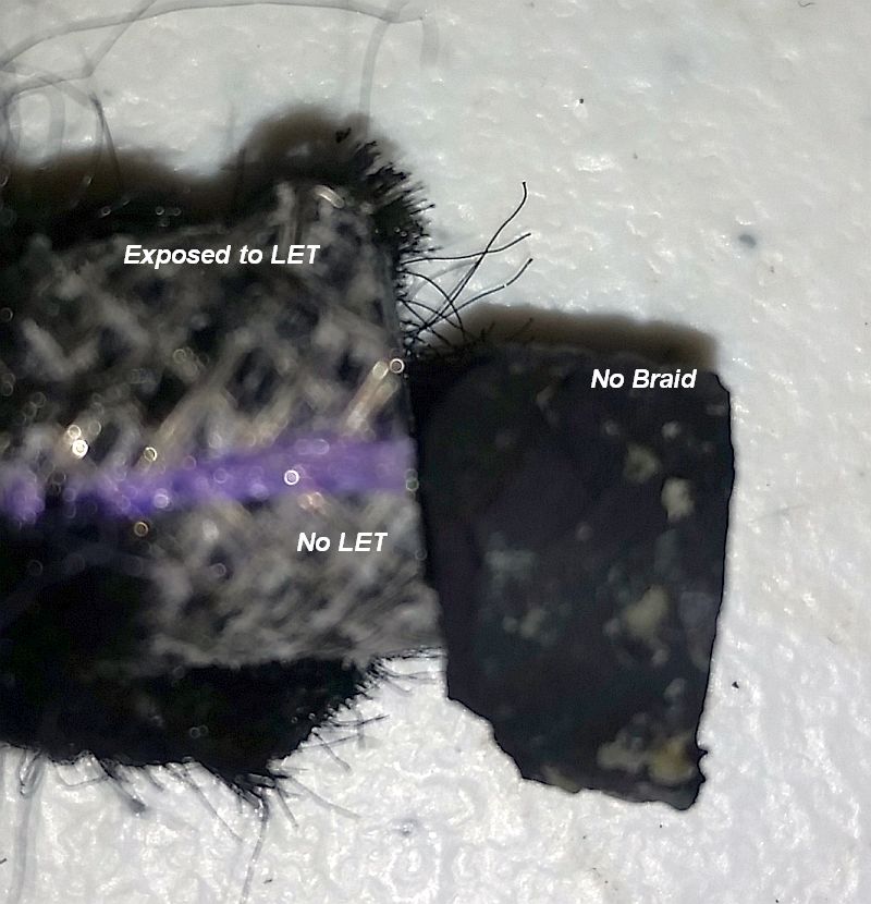

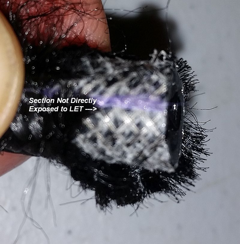

The next thing I looked at was Liquid Electrical Tape (LET). I did not even know such a thing existed. Devin was aware of it, but had never used it.
So I went and purchased some at Auto-Zone. Permatex brand was all they had. Upon reading the label I saw it contained Xylene, methyl ethyl ketone & acetone.
I then went and researched nitrile rubber hose and those chemicals. Found out that each one of those chemicals is rated as destructive to the hose. Even the off-gassing from those chemicals will cause the hose to deteriorate.
I also have applied a very small amount of the LET to each of the different hoses we have. Tomorrow I am going to look at the hoses to see if/how much they are compromised.

Regarding Randy's experience, it appears to have been the "perfect storm", where a confluence of the worst possible scenario's all played out to make a very unsatisfactory experience with our Optional Braided Hose.
1. Hose difficult to put on because of nature of fiber braided hose, with 3 barb fittings instead of 1 barb, heated with hair dryer instead of hot water.
2. A small amount of the LET touching, or at least off-gassing onto the hose, resulting in an accelerated deterioration of the hose.

Thank you for sending what you have in....I, by nature and by vocation, am very curious. I always want to understand and grow my knowledge base, so having that little piece of hose will help there.
Those chemicals, via off-gassing, or direct contact are very damaging to Nitrile rubber hose (which is what is used on HD's for oil). Below is a very informative link with a Rubber Chemical Resistance Chart.

Hey Randy,
I received the piece of hose you sent in. Thank you!
The rubber is soft and pliable, not dry rotted at all.
It does have some slits in it...this could have come from kinking when sliding it on, or from a too tight hose clamp, or from work at taking it off.
What was most interesting is that the glued on steel mesh is completely gone from the outside of the rubber hose.
Photos below show-
1. The hose with the adhesive & braid intact
2. The hose with the adhesive holding the braid pretty much gone, after just a day of exposure to LET
3. The hose I received with no braid or adhesive left on it.
The photo I do not have here, at the shop, is of some of this hose that has over 30K miles on it. This weekend, at home, I took a section of hose off my Tri-Glide and peeled back the black fiber braid, underneath the adhesive and metal braid were fully intact, just like in the first photo above.
What is perplexing is why your metal braid is no longer on the hose. I know you did not have any part of the LET on the hose, but I have to believe that the off-gassing (which continues indefinitely after the LET is dry) must have had an effect.
In any case, you are set now with the standard rubber hose.
Thank you for helping us in this.
