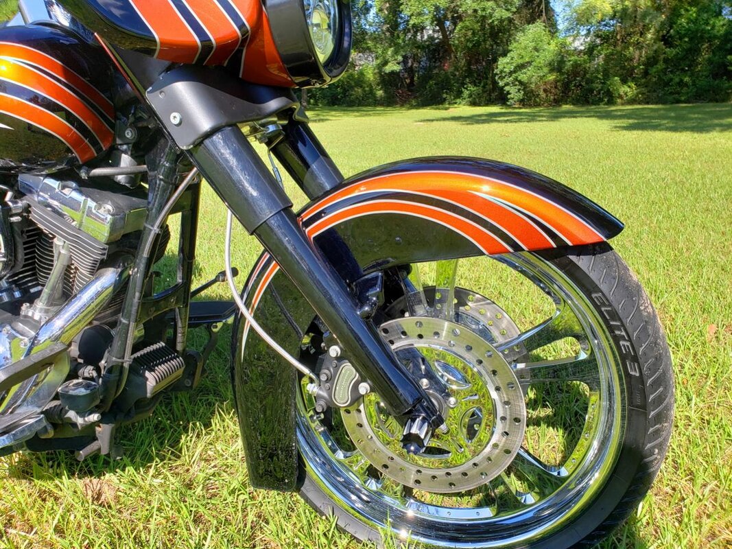

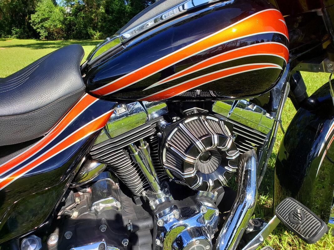

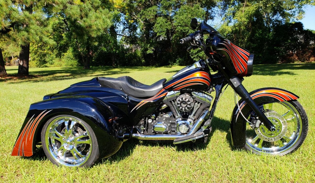

Sharp looking ride Papa, I dig the paint scheme.
Thanks Gary...I agonized over the paint scheme, changed my mind a dozen times and said what the hell I'm going black.
But I didn't want solid black, so this was what I landed on.
The motor is bone stock for now and its been dependable and the Hannigan IRS is real smooth so I'm enjoying it. I will prob add a cam to give it a bit more punch since its a 96 inch motor. The bike is a 2007 Ultra and just hit 40k miles.
I am going to have to change the rear drive pulley though as its geared a bit tall with the Hannigan 66 tooth pulley so I'm going with a 70 tooth.
That's certainly one way of taking care of the 07 suspension problem that results in a nasty weave. I agree with the cam job. That will complete the transformation to a darn good trike. Fine like it is but that extra punch will be great.

Shes a beauty Zook :clapping:

Awsome looking trike!
Would the 70 tooth mess with 6th gear light and Cruise control?

It has no effect on either.
