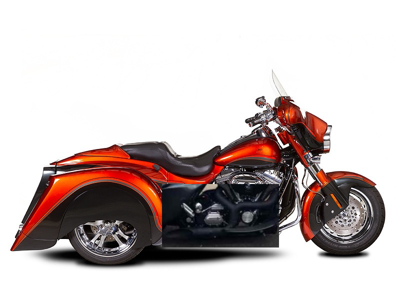

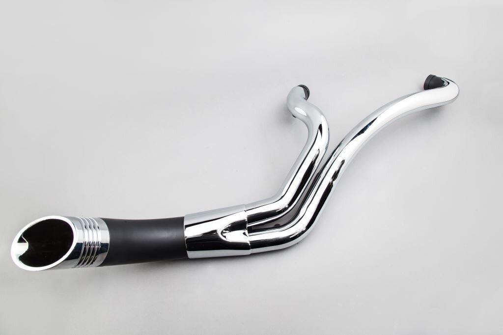

I'm wondering if this exhaust system would work with the Hannigan Transformer kit? Also If I can order the kit without the cut outs for the exhaust at the rear??:confused:

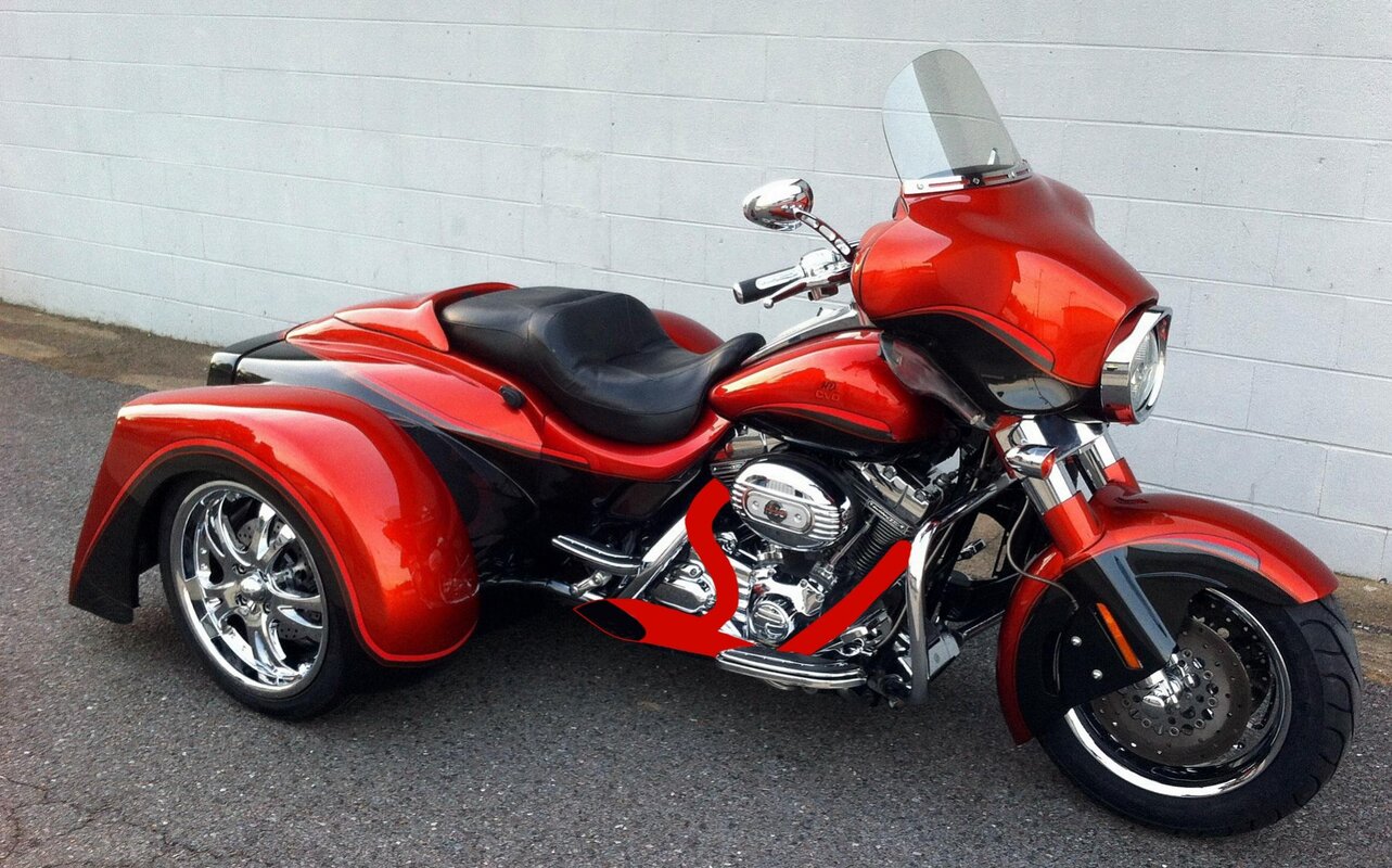

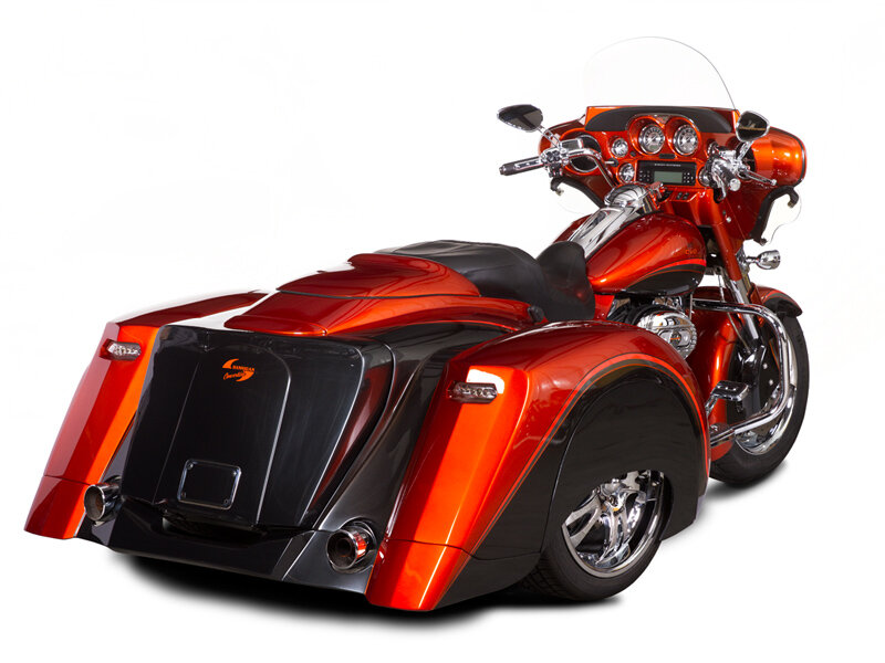

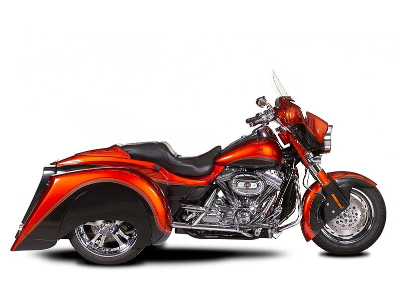

Hard to tell the length just from the picture, but I'm pretty sure, almost certain even, that it will get into your rear fender. The Transformer body sits lower than most kits in the front and is notched to allow for the stock exhaust system to pass through a semi-circle cut out, and not straight underneath the body like most kits. On Clint's Transformer we had to notch the body even more due to his aftermarket exhaust system.
My thinking as well
I agree with Zook,Dave. Don't think that wouldn't clear the rear fender. As for your other question,all you can do is call and ask them.
My thinking as well. Wish they made 2-1 exhaust that would work and look good for these trikes. If I only had a fab shop... :AGGHH: You watch, someone is thinking or doing it right now; making exhaust for our trikes $$$

We have worked on several bikes with this and several similar side exit 2/1 systems, I do not believe it would clear the fender. Another consideration when considering a side exit on a trike is that with the fenders and a turnout pipe that turbulence and airflow may direct exhaust gasses back toward the rider. A turndown or big radius may be a better option

No way would that exhaust system fit our trike. Something else is the cost. Our trike has Vance & Hines Power Duals headpipes and Monster Round 450 Destroyer mufflers. The Dirty Bird and Akropovic both cost more.

I just talked to Jason @ Misfit. Their exhaust system will work if the collector is shortened.

A black pipe would make the job easier as lots of places out there can do high temp coatings. Shortening a chrome collector would also be easy also but getting it refinished would be more difficult. Not many chrome shops left anymore as the EPA has just about driven them all out of business.
If I were doing this,I would see if Dirty Bird would sell the exhaust to me in a bare metal configuration,shorten the collector,and then have the entire exhaust coated,by Jet-Hot Coatings. http://www.jet-hot.com/
