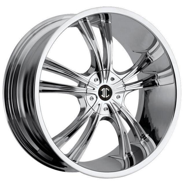

My UPDATE
I have the 16 inch chrome wheels and Tires on the way! :pepper:
Jim says the 40 offset will be just fine. I will also be
using what Hannigan puts on , A Kumho Ecsta 4X 195 / 55 R16
these are the wheels, chrome all the way to the back lip.
Ragtop found this one and I like it :)
what do you think?
Wish me luck I hope it all works out :)
Jeff

Re: My UPDATE
Gee Thanks...... Now I have to find another wheel, can't have 2 trikes with the same thing !<br />
<br />
<img src="images/smilies/allgood.gif" border="0" alt="" title="AllGood" class="inlineimg" /> Just messin with ya Jeff.... <img src="images/smilies/grin.gif" border="0" alt="" title="big grin" class="inlineimg" /><br />
<br />
They are nice looking wheelz<br />

Glad the Purchase/Upgrade has been given the "Goochie Seal of Approval" ThumbUp
Ya Done Now ???? :D
I hear in the Wind that somewhere there's a Dude toying with a Hemi-Swap :xzqxz:
