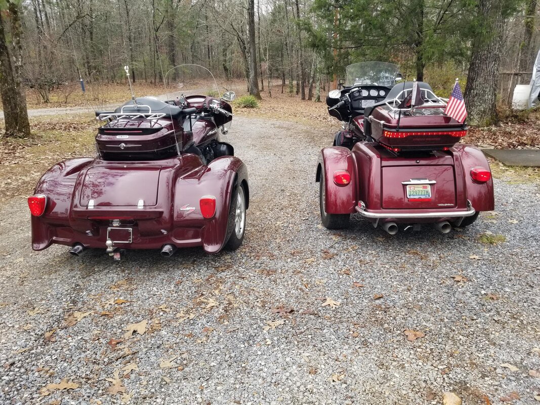

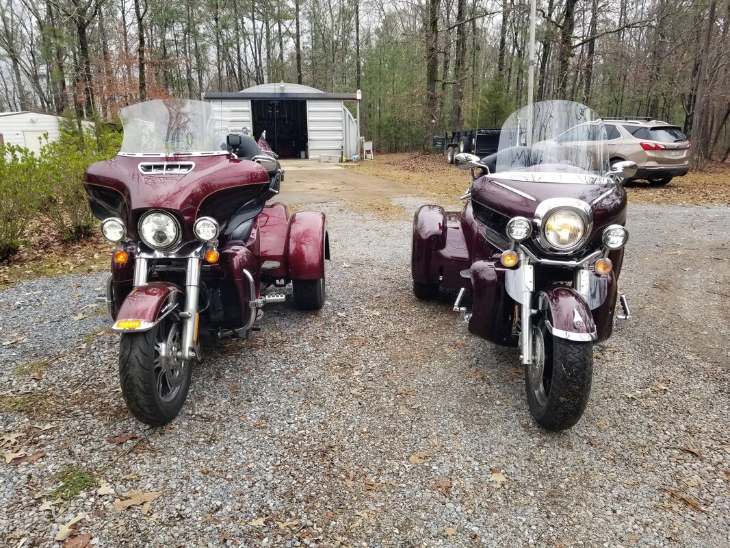

Hello everyone, my in-laws have joined us on three wheels they purchased a 2008 Yamaha Venture with the Hannigan on it. it is a beautiful bike and rides good. it has a modulator on the head light that has to go we are not to fond of it. it does not have a reverse, I tried telling him it was not necessary but I think there is going to be one added and I will be the one doing the install when it happens. the front end has a wobble in it sometimes that we have not had time to figure out, I believe it is the front tire so it may get a new one when riding season comes back around. if anyone has an idea what to look for or some input on installing the reverse let us know. these picture show it beside my Triglide
