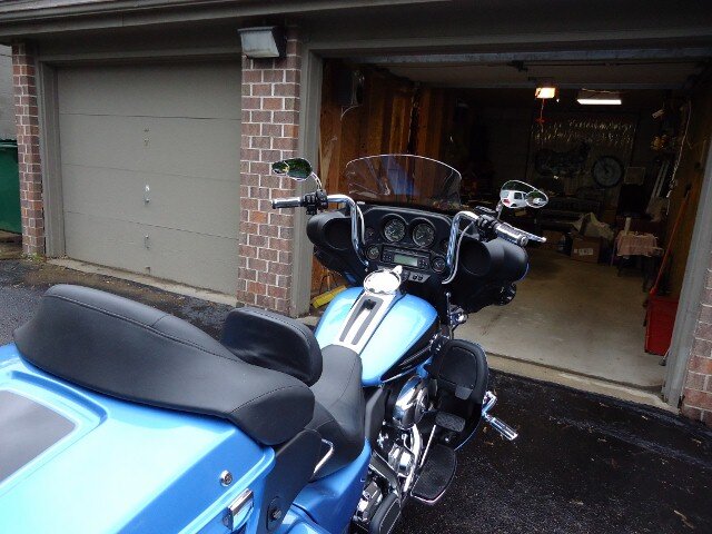

Like eagle1 above, I too went with the Paul Yaffe "10-inch Classic Bagger Bar". I went with all new chrome controls, cables, and brake lines during the transition. I chose to extend my wiring by about 4 inches so that my connector plugs remained in the same location inside the fairing.
I'm very happy with the change. It raised my hands where I wanted them to be, putting them about even with the top of the fairing.

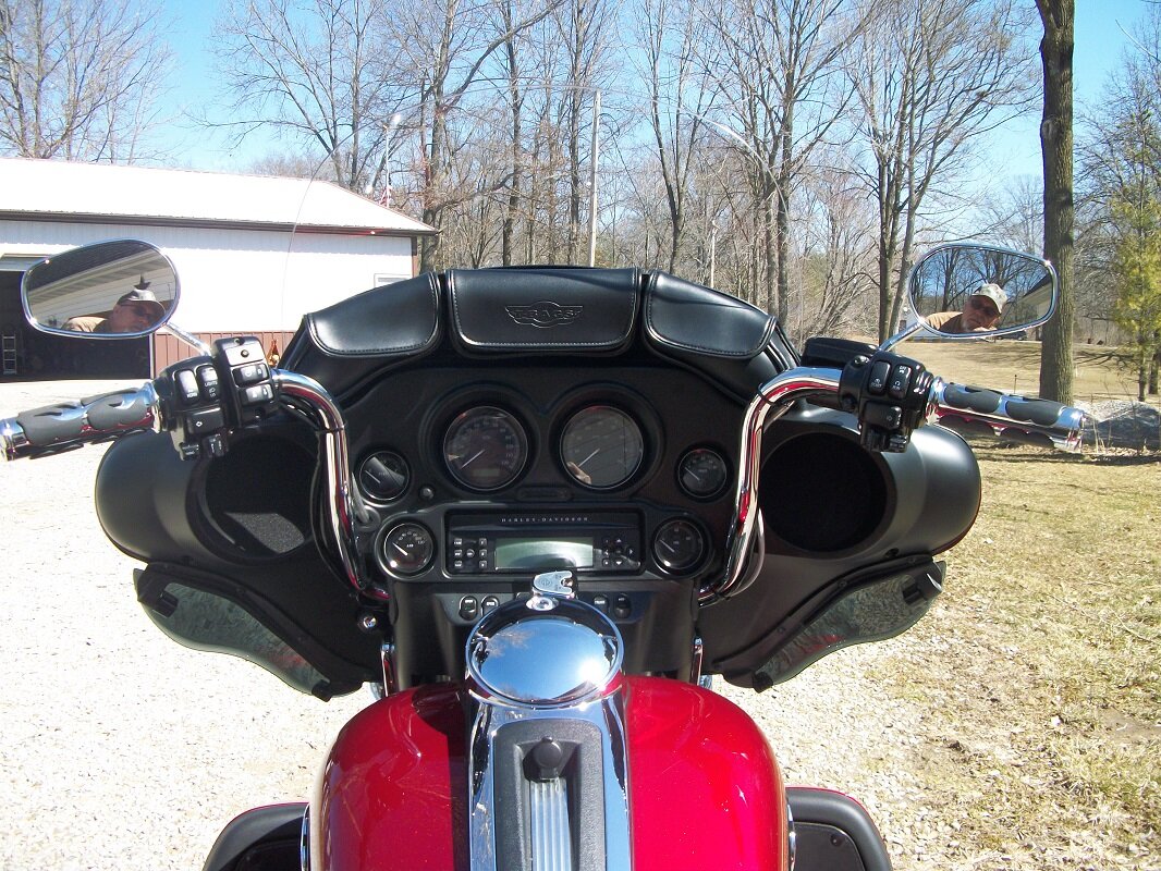

I got my bars on today and just wanted to post a update.
A little more tidy up and iam done .
