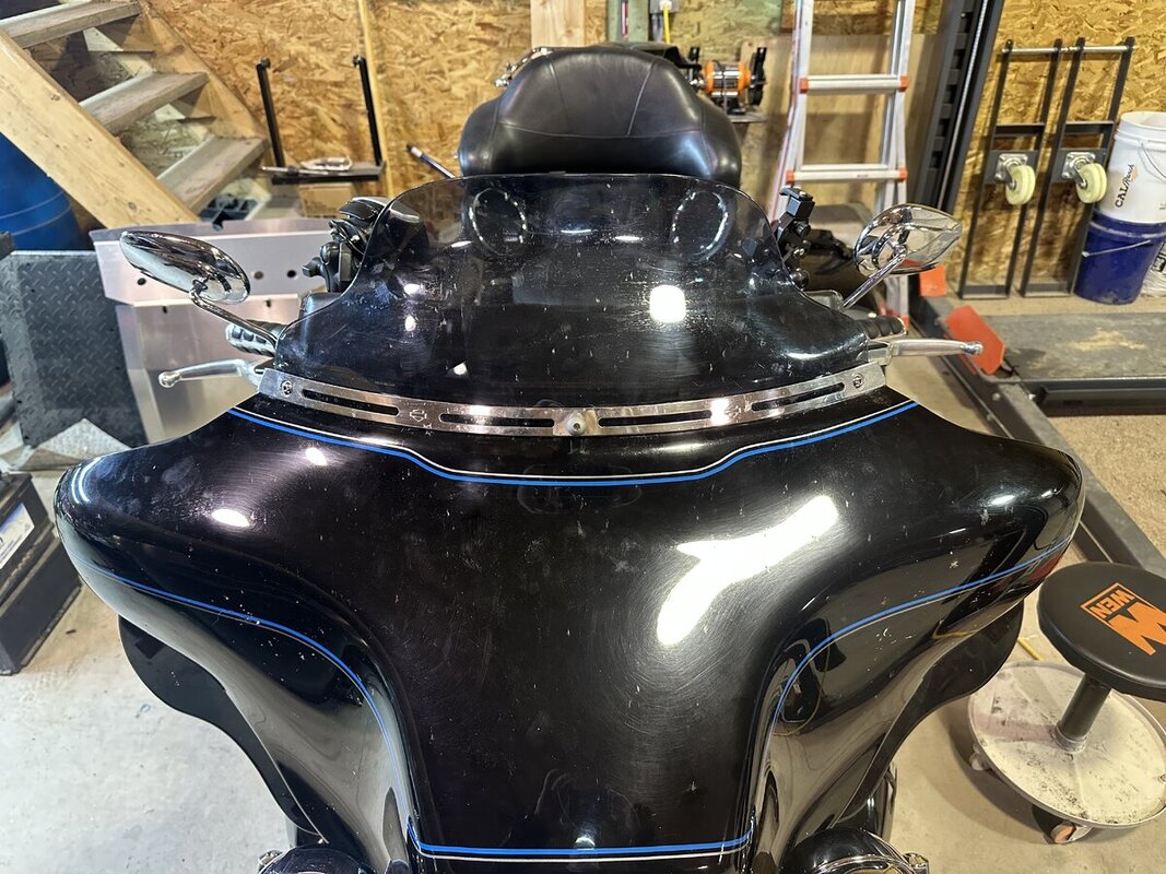

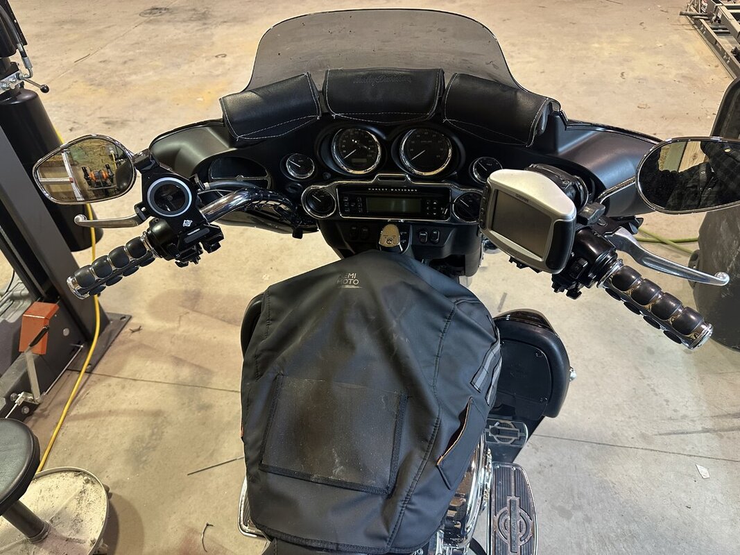

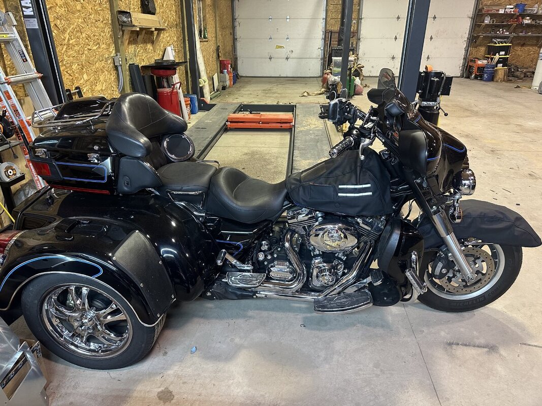

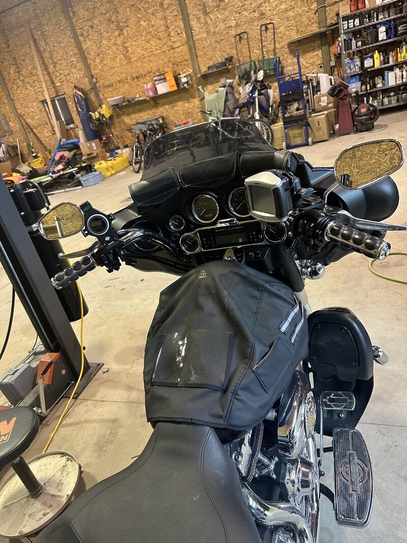

Finished the install. Raining all weekend but hope to get it out soon and test. These bars feel a lot better sitting on the bike. I rotated them forward to where they are just touching the fairing and then backed off 1/8” for a little clearance. I rerouted the clutch cable and used the stock brake line as mentioned. Brake line is tight but not bound up anywhere. Originally, I was going to run all the wiring internal but decided to just leave external like it was stock. Thanks for all the guidance.
Finally got a chance to get out this weekend and these bars are a game changer for sure. Really give the Trike a different feel. I like them a lot. Have a 1200 mile trip through central Idaho later this week and can’t wait!
