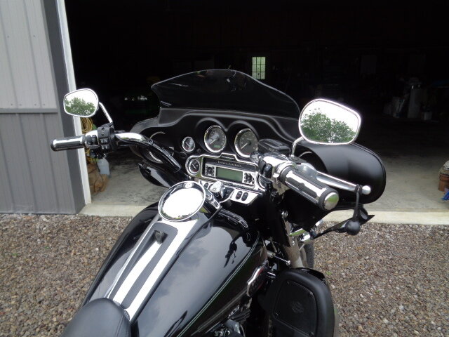

I installed the 2+2 narrow sweepers on my 2014.All I needed was the wire extension. The brake & clutch were long enough. It only took me a little less then 3hours.

For the cost of the manuals I would do it myself it is not that hard videos and all sorts of help is available. I did it just to be able to do it, no special tools are needed just takes time, and work with the service manuals. I installed 2+2 wide sweepers they are a little straighter on the grip my wrists are a little straighter than OEM. Install what fits you for these worked out great.

Getting the two inch pull back bars installed, Harley carries them as the reduced reach and move your grip back two inches, you might be able to gain some height via the angle. Dealer wanted almost $1600 for the install, said he had to replace all cables, wires, clutch hose extended...etc. Read on here that you only need the wire extend kit, so went to the Victory dealer, he does service HD's and he is doing the same install for under $500, using just wire extend kit.

I went the same route... being only 5'5" I needed more than the stock bars gave me. Dealer quoted $155 parts + 4 hours min labor ($380). An indie shop that does all HD work did it in 2 hours for $67/hr. I supplied the bars and the wire extensions.
These bars do not need brake or clutch hose extensions on the '14s and '15s.

Mine said that too. I quoted the kit manual that said only '13 an under needed new clutch and brake hoses. He disagreed and said the directions were wrong. I told him if I found out from another dealer it could be done without changing them out, he would pay me back the money.
When it actually got done, the tech told him I was right, and the extra hoses weren't needed. He came to me and ate crow. I told him he ought to listen to his customers every once in a while--especially ones that new how to read directions. :kpzxvq:

Here is a link to the reduced reach batwing handlebars. If you'll look at the parts needed for the 14 and above, the only thing needed is 10" switch wire extensions. Ask them how it is they know more than Harley does.
I just installed the Khrome Werks 2+2 narrow sweeper bars on my 2015 TriGlide today. Just needed the wire extensions, no clutch or brake cables needed. Took me about 4 hours to install and the ride is great.
