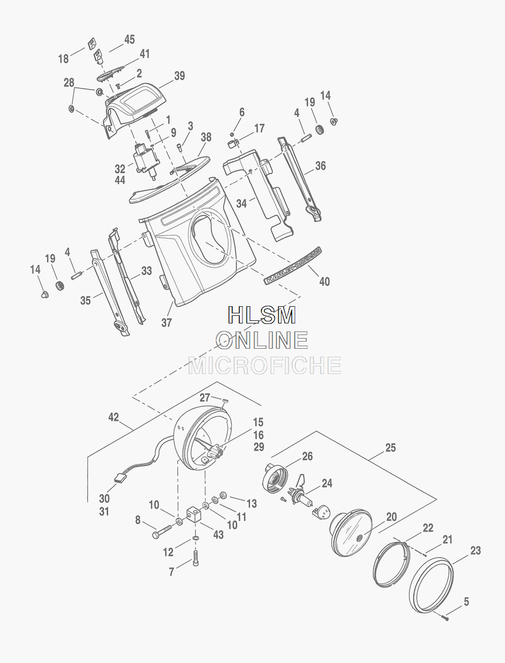

Have a look below
Under the black cover you will find the screws that hold the chrome cover on
Then you will get to the bolts for the handle bars
Glue the black trim piece back on when you are done;)
Under the black cover are also 2 access holes, you may loosen 2 bolts on the bars clamps enuf to move them with out total removal of chrome cover
You can use a thin knife blade to pry up the black cover around the fork lock, go easy it will bend and break;)

thank you for the diagram. now if it were reversed so I could see the 2 holes and where they lead to
