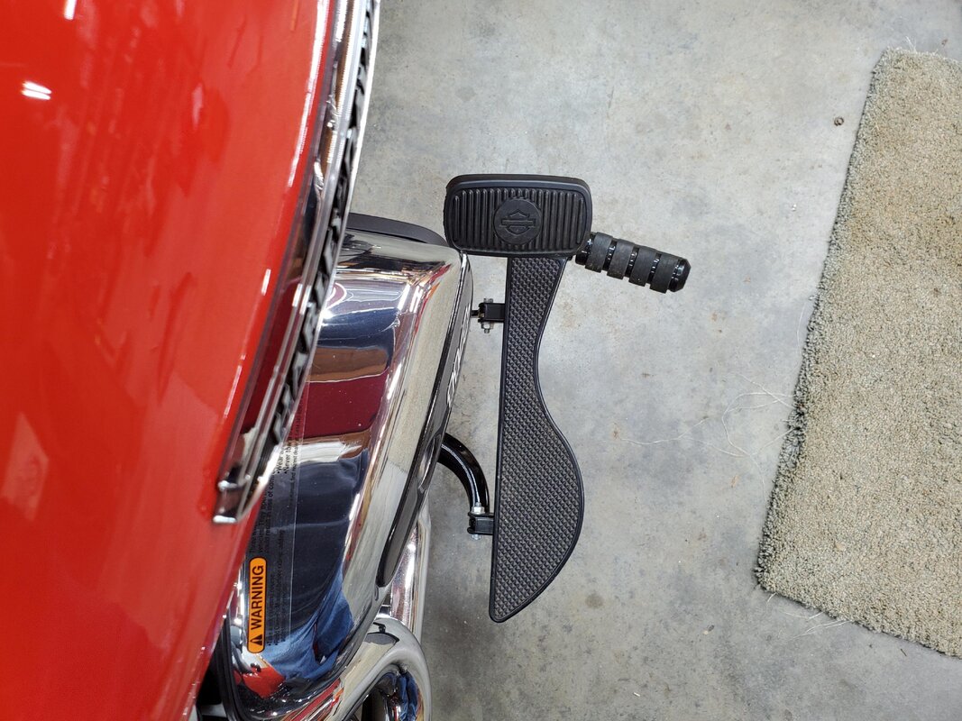

Ciro frame mounted foot peg mounts on our Freewheelers for leg comfort.
