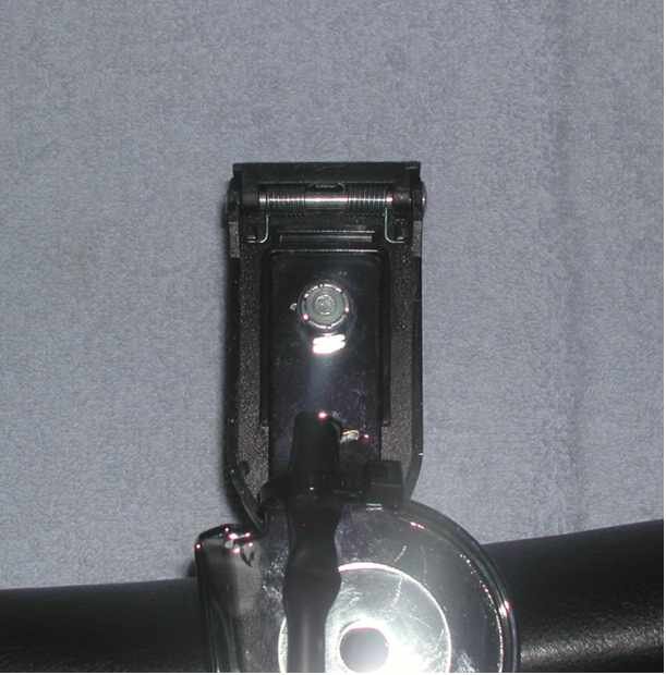

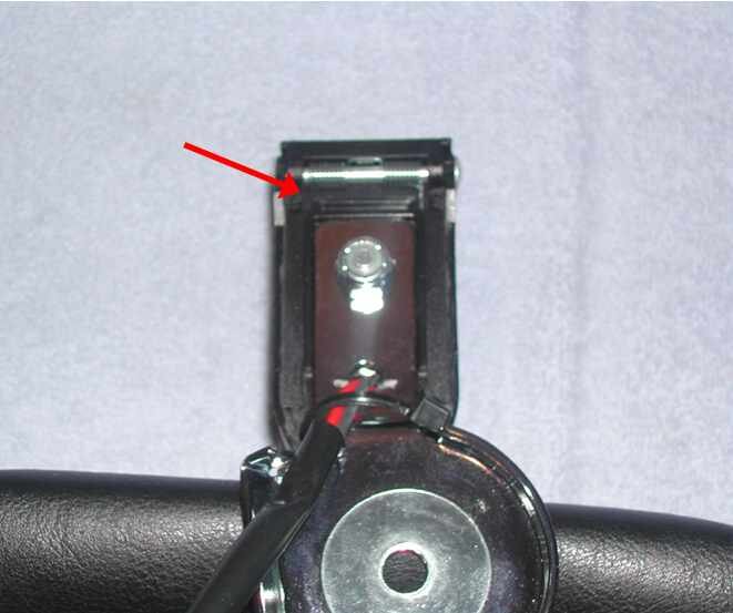

4 - I discovered that the dust cover closed like a mouse trap! Knowing that some members on TrikeTalk have had the metal horn mounts break off from vibration, I really didn't think a highly-stressed plastic part would last very long. To try to mitigate the cover's steel spring tension, I used a small pair of diagonal wire cutters to cut off one ear.
Before, with both hinge spring tabs
After, with left hinge spring tab cut off
That reduced the tension by, approximately, one quarter. It still closed tightly, but it was noticeably better.
