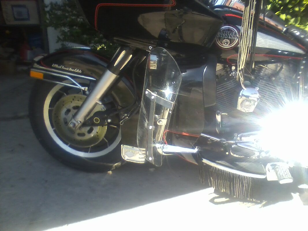

first order of business, Stop lugging the motor.
The biggest mistake people make is lugging a trike, Keep it in a gear where it is always pulling so you have power at your finger tips. It will also cut down on any head shake from the front end.
I have an oil cooler that keeps the temp a steady 150 degrees needed for good combustion. I have a mild cam in my 80" evo.
I made a leather deflector that fits under the seat and keeps heat off my crotch.
I just made the wind wings out of a detachable windshield that keeps bugs off my fenders and cuts wind drag off the fenders. So far it works great. They are concave so they create a slip stream instead of a barrier and my tach. runs slower at 60 mph so I am not working the motor as hard as before.
Im still in the testing stage but so far I like it.
