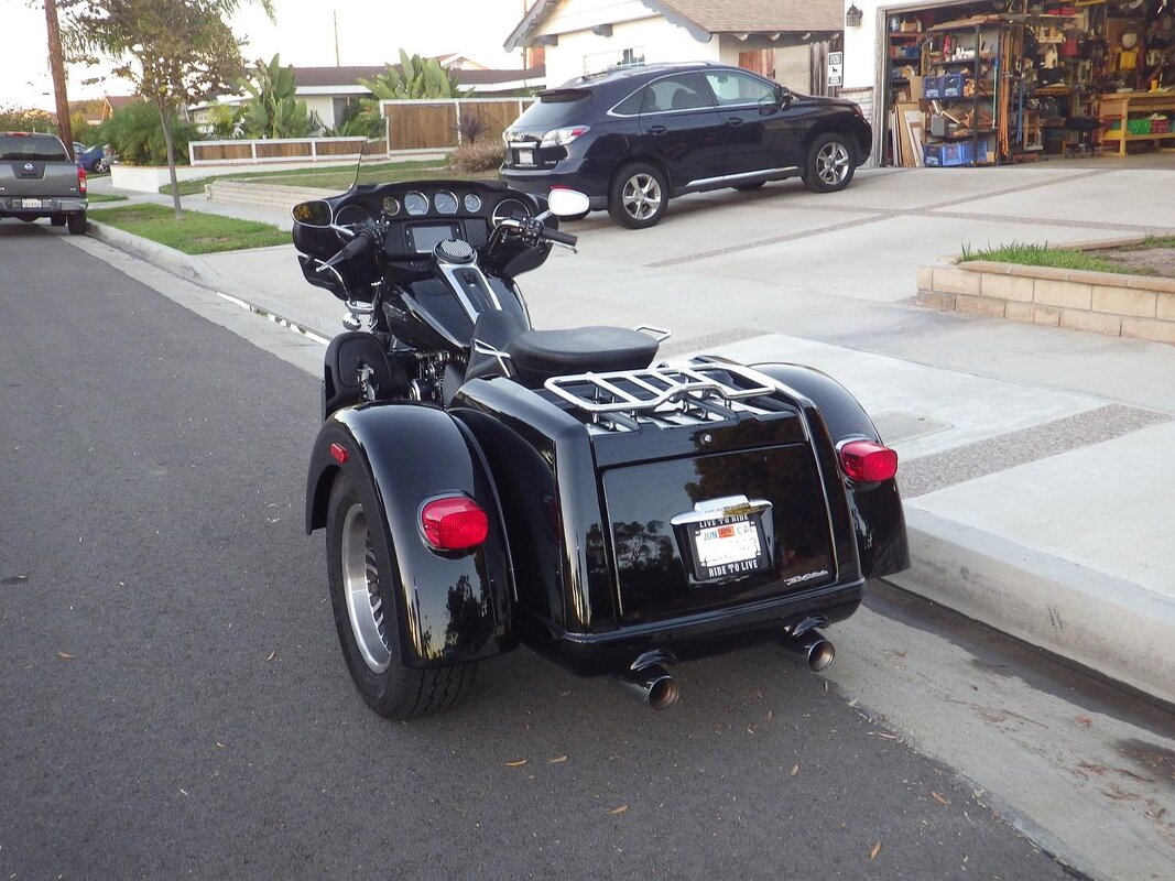

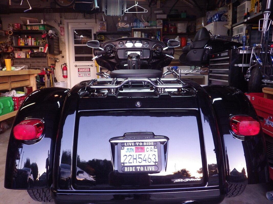

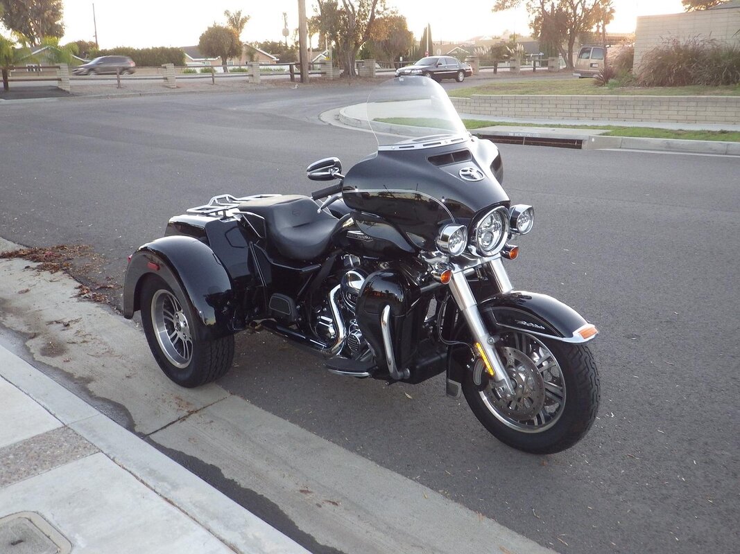

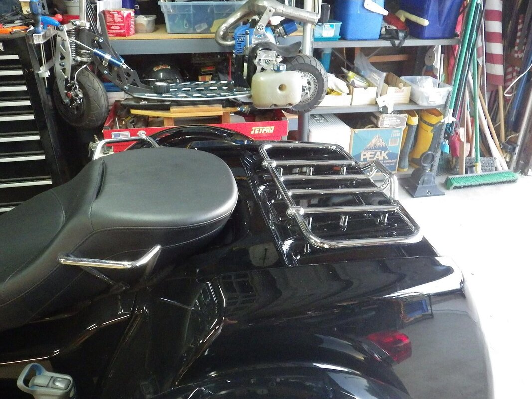

A couple of weeks ago I had taken the top box off to install a Lil Piece of Trim and really liked how the trike looked with no top box. I wished that Harley made a rack that mounted into the same holes as the top box does, and like magic a member (SEAlaskan) came up with a part number for a rack that fits and was offered for the FLHXXX 2010-2011 Tri- Glide. From Harley they were $299, but sadly are no longer available. I got lucky and found one on ebay for just $99, and it was brand new still in the box.

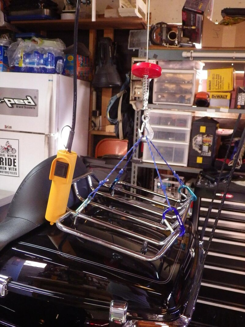

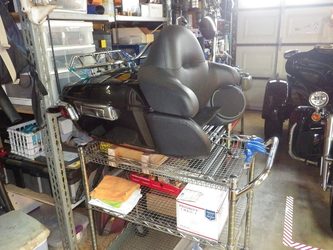

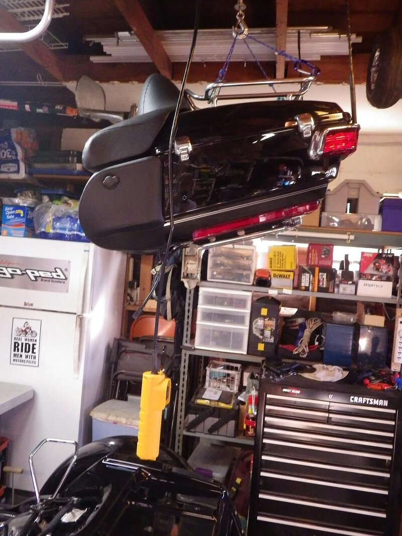

I don't plan to run topless all of the time because that top box is just so damn convenient. But on occasion I would like to show off the slimmed down wide glide so I devised a way with an electric hoist to lift the top box off the bike and lower it back down onto a rolling cart. Then when I want to put the top box back, on I lift it off the cart with the hoist and drop it back down into the holes. It is not super heavy, but it is a bit awkward trying to drop the box into the holes without scratching the body.

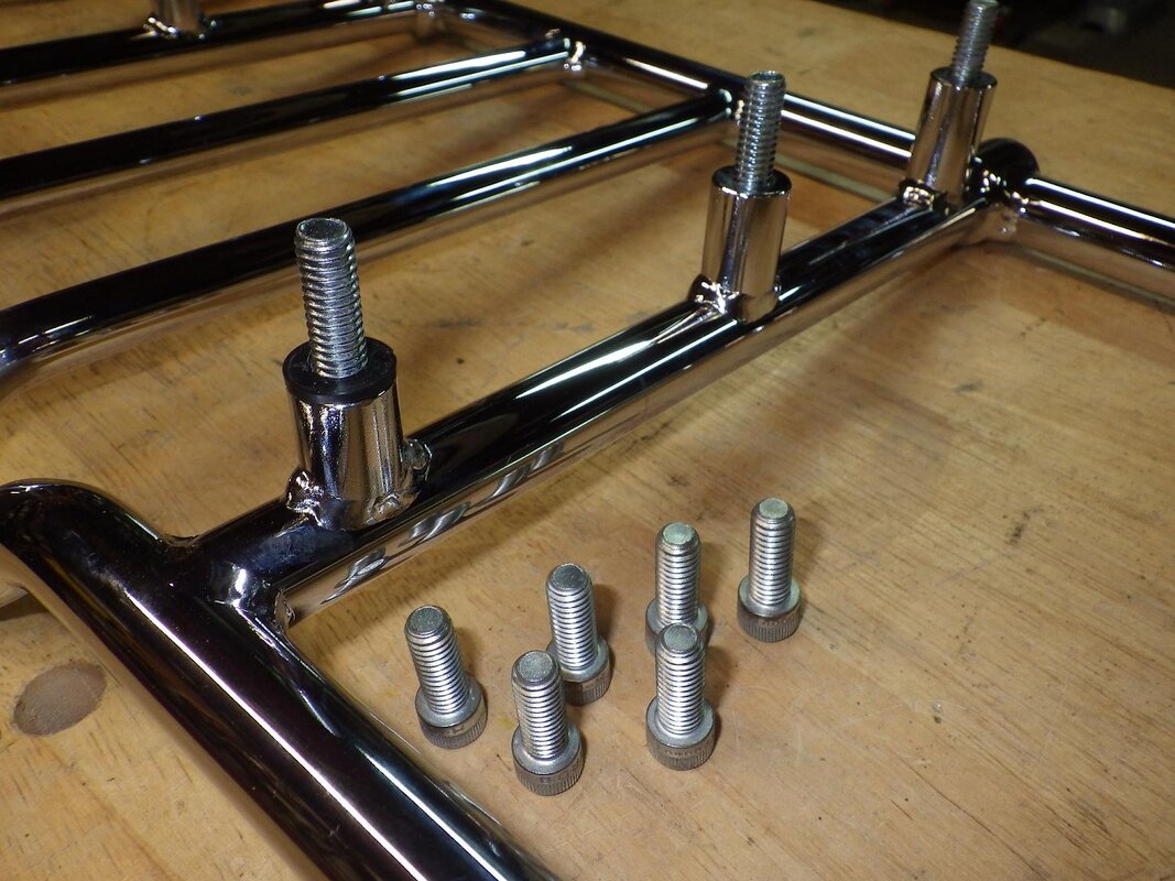

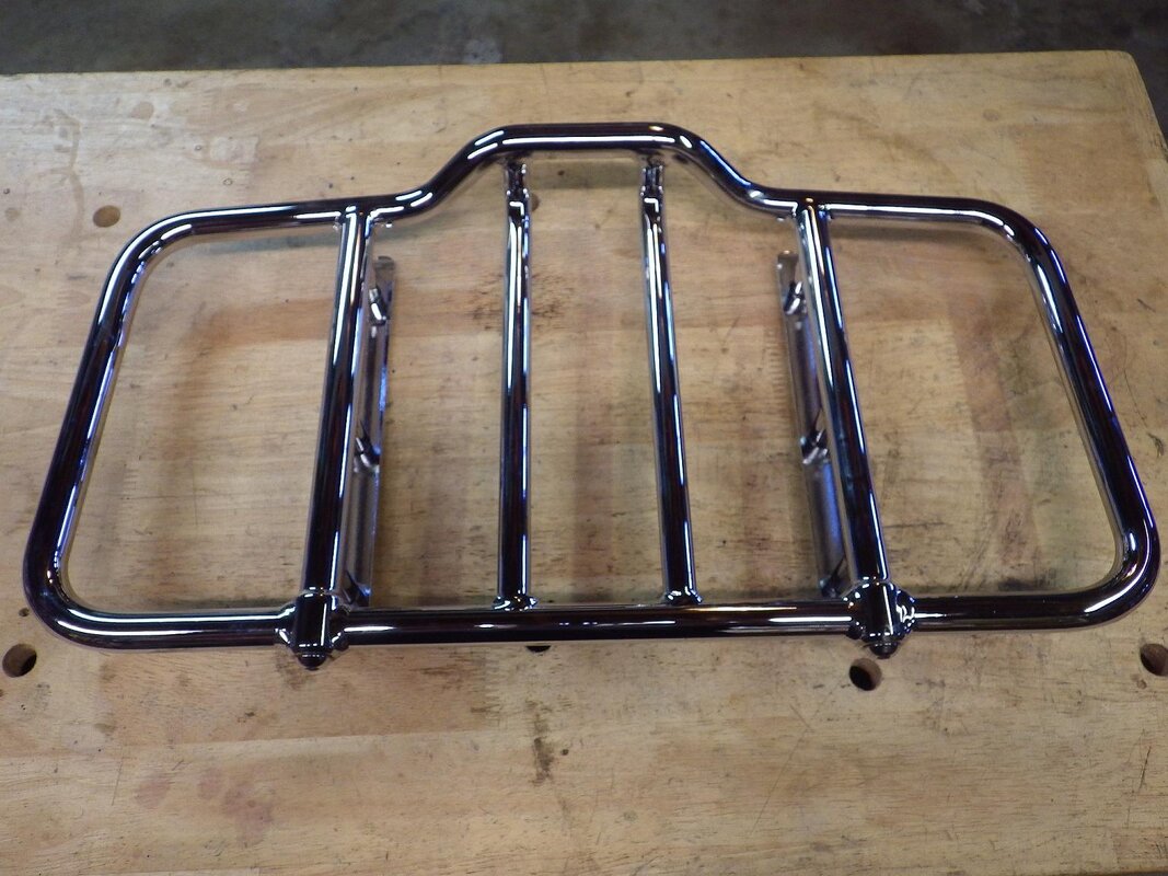

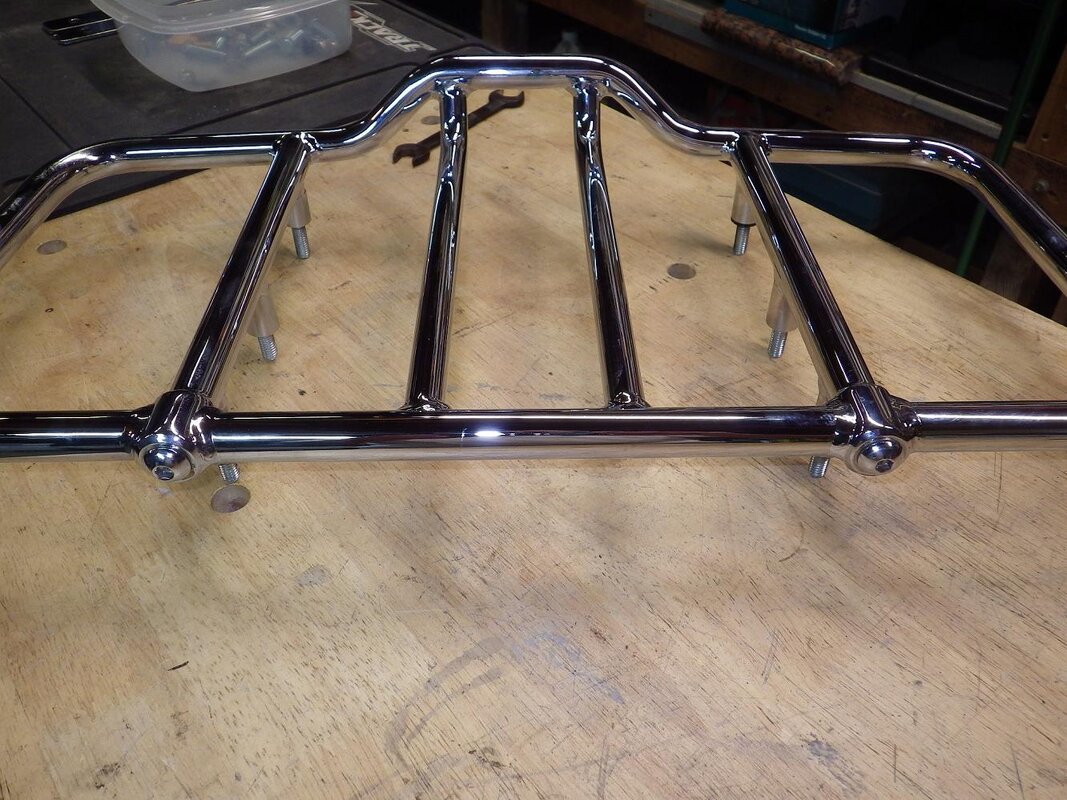

The rack came yesterday so today I stripped down and went TOPLESS. It came with 6 5/16" allen head bolts to screw into the rack from underneath the trunk top. But I like the idea of studs like the top box has, so I got 6 5/16" lag bolts and cut the heads off and to length, then I will blue locktite them into the rack to make the switcheroo/install a little bit easier and use ny-lock nuts on the underside of the trunk.
Now from behind she looks like.......BEYONCE
Black, wide and easy to ride :pepper:

I love this look as an option. Wonder what the weight limits are for loading the rack? Maybe more than on the tourpak?

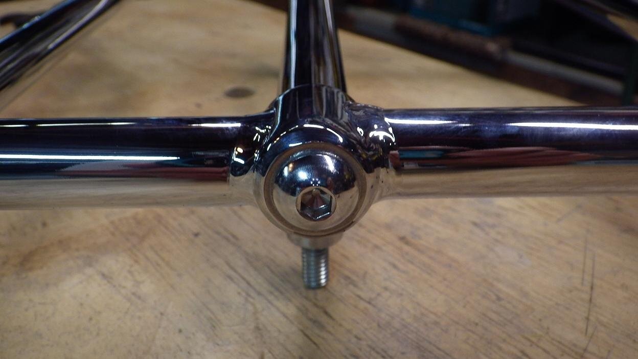

The rack is super beefy solid 3/4" bar stock as opposed to the Tour-Pak rack which is 1/2" tubing. I am sure the rack itself could hold Beyonce, JayZ and Chris Christe. The trunk roof would likely fail before the rack would.

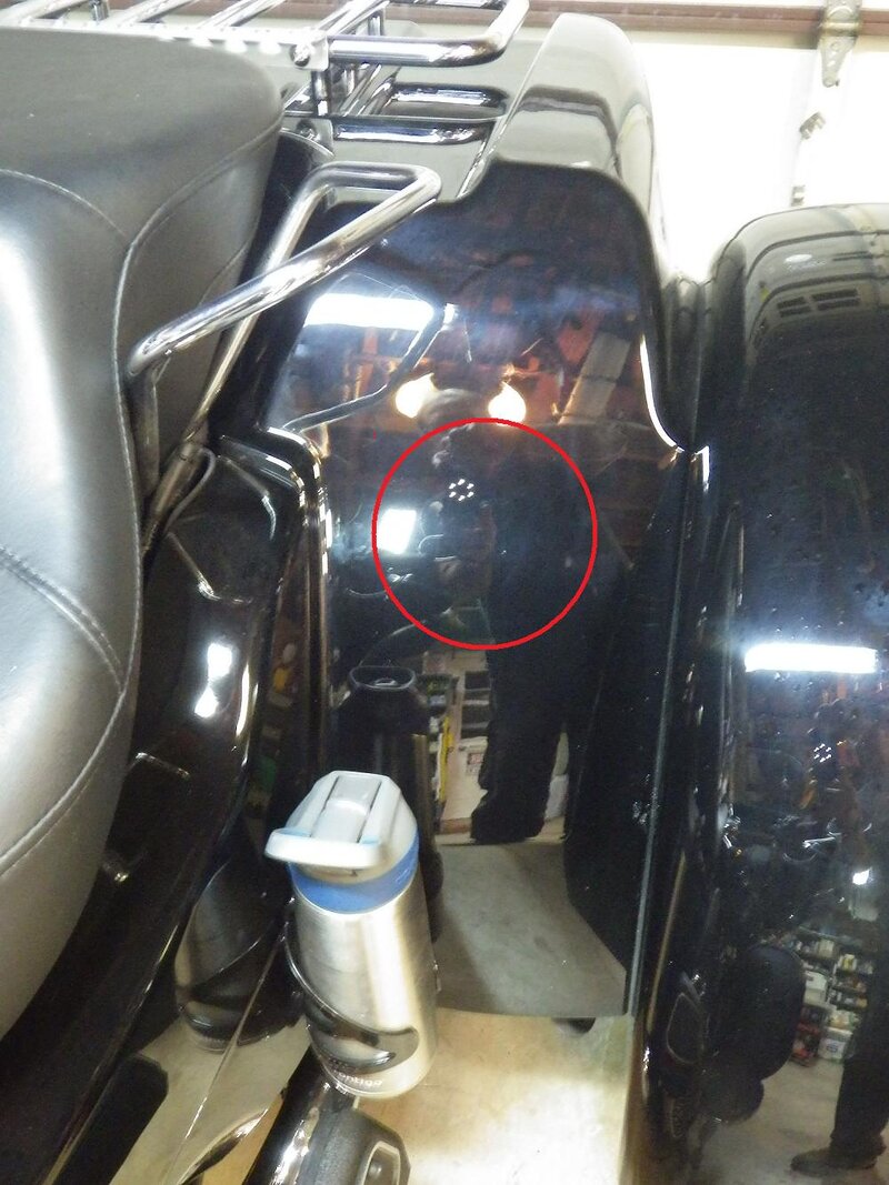

The 2015 Tri-Glide does not come with a CB, nor have I felt the need to install one. I simply replaced the one tall antenna on the top box with two shortys to make it have a more balanced look. I left the antennas on the top box when I removed it and just unplugged the radio antenna connection and the speaker connection along with the top box lights. So going topless means I also have no radio to listen too. IF I was going to keep the top box off most of the time I would figure a way to mount some sort of an auxiliary antenna. And IF I end up with a passenger I will try and find one of those rack mounted back rests.

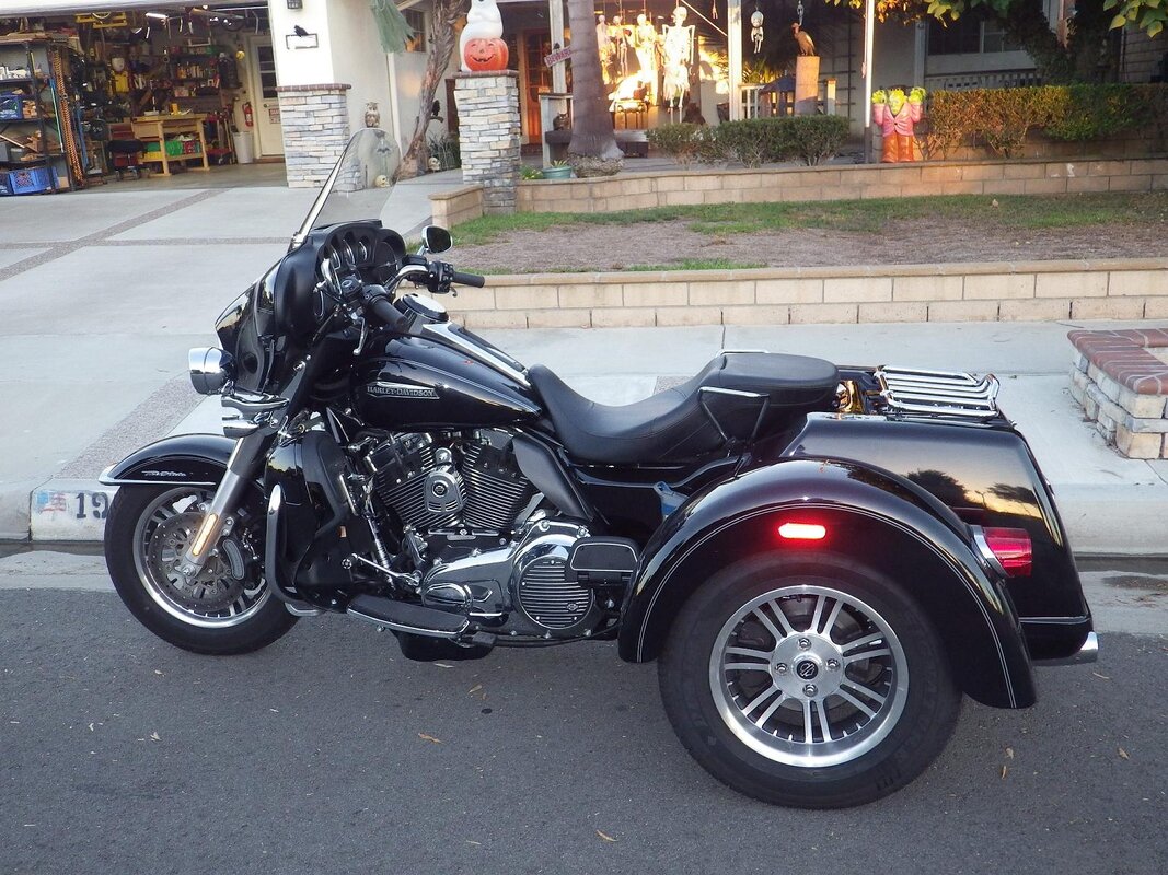

Convertable
Maybe I wasn't clear. To me this is kind of like having a sports car with a removable hard top that you can remove and store in the garage when you want to go topless. I am only going to go without the top box on occasion, and when I do I will forgo the radio.
IF I decided to go without the top box on a more permanent basis I would get an internal antenna as suggested, and look into maybe mounting a pair of speakers on the front of the 1/4 panels.

I like the look but sure would miss the storage even around town. I am not to sure about lifting the tour pak by the rack. Looks like that would put a lot of strain on the lid.
