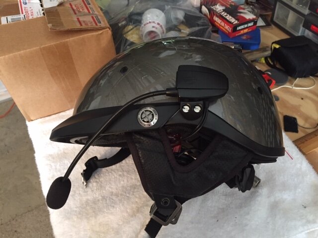

Is the Sena 30k interchangeable between the different helmets (full, 3/4 and half)? In other words, can I switch it out from a full face to the half helmet without having to buy another set?
First a BIG caveat . . . I don't own and have never used any Bluetooth headset - Sena or any other brand. But I have done quite a bit of research about these and read many 'technical' and rider reviews, likes, complaints, etc. So my understanding is that the Sena Bluetooth headsets can work with all these different style helmets. But the install is not a five minute job especially on the 3/4, full and modular helmets. So while I do think you could switch it would not be a quick and easy change.
And I'm not sure what model bike you plan to use it on. If a Harley with the Boom!Box you'll need the Harley branded Sena 20s EVO Bluetooth headset to get full stereo sound. The 30k will probably pair up but it will not provide stereo.
I have been using the Sena 20S since it came out and it is very reliable in my opinion. I use the Sena Freewire and find that it is good to go once you figure out how to use it. You can use the same 20S on different helmets but you would have to buy the mount for each helmet it you want to make it easy to change from one to another. I do not do it that way. One thing to be careful of and not all helmets with take the mounting system easily. If you can not use the clamp mount do not use the stick on one. It will fail in the summer. Just my 2 cents.
I'm just Old School CB guy. All my riding buddy's have a CB. The little 3ft cable from the Helmet to the plug on the tank is no big deal. It clips to your shirt and doesn't move around. The Mike can be moved anywhere you want, and the ear speakers are inside the helmet and you don't feel them at all. But, Hey , whatever you want will work ...
I had the CB installed when I purchased the trike and had no problems, although I got tired of my wife's wired headset coming off the helmet and dealing with the wires. I finally purchased the WHIM and HD headsets. I also purchased the half helmet headset. My only real problem is her hearing me when I'm on the Half headset. The mike doesn't come around to the mouth area, it sits on the cheek area. I thought it would be more sensitive but no luck there. Music comes in great, I downloaded o ton of cds on a thumb drive and use it for most of our riding. Occasionally, I'll stream the Sirius XM from my phone. Good luck
