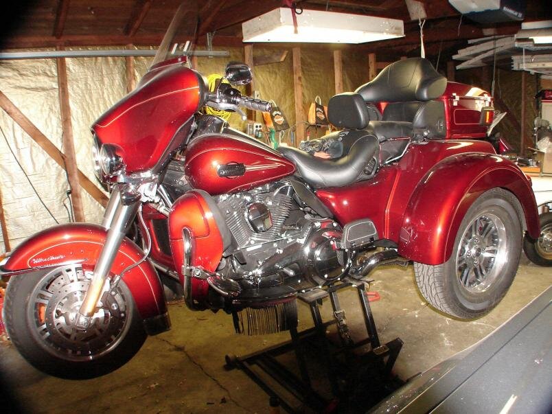

I can get under mine this way..
trikermutha, I was reading this thread yesterday when the UPS truck pulled up with my new Pit Bull lift with Tri Glide adaptor. I started looking into lifts after seeing an earlier post of this picture that you had made. Thanks for answering my questions as I had zero experience with any type of lifts. Working by myself, I had the lift assembled and the trike in the air ready for pictures in 25 minutes. I have back problems and was unable to even reach the lower parts of the trike, it sure was nice to polish my mags for the first time while sitting in my chair. Everything associated with trikes and H-D is expensive but this sure was some of the best money spent. Pit Bull was great to work with and gave me free shipping. They actually included the adaptor for no charge !! I was only billed for the advertised price of $489.00 ! Thanks again trikermutha. I am trying some pic's hope they make it...
Pictures....
Thanks to both of you, I must be doing something wrong. Both of our trikes use stock pipes with slip-ons, but seem too rear heavy and won't balance on my jacks. I only tried once before I gave up and used ramps, need to give it another attempt. Never had any problems with the jacks and the old Harleys. Guess old age makes me too cautious.
screwball, I haven't heard you say, do you have the adaptor ? I think it is a must have with these lifts. Pit Bull sells the adapter by itself, I think it is somewhere around $65.
yes you will need the pitbull Tri Glide adapter...But I dont think they would fit on your lifts..
The bike would tip to the back without the adapter..
See my other post on lifts..I have pics posted and another member posted his pictures also
