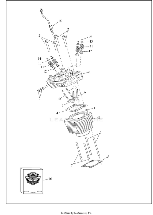

I believe the m8 configuration is different than the twin cam. If you pull the rockers you also loosen the cylinders. Little more work involved.
Not any of the M8 I have done, Pull the anti freeze lines, then the rocker covers, & the rocker arms, pull out the push rods. For me the pain in the ASS is the lines. The cylinders are held down by the cylinder heads, no need to remove or loosen the head bolts.
AS long as you do not disturb the head bolts you should be OK # 2 the 4 head bolts
