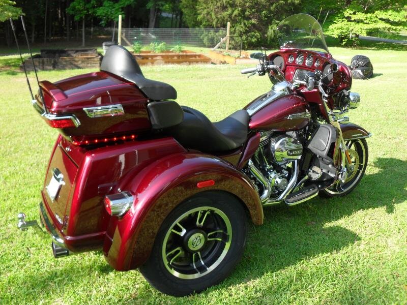

Well I did it today...:pepper::pepper::pepper:...Street Glide front wheel on Miss Mysterious...19" wheel has cleaner narrow rotor...
When I was test riding it reminded me of when I tested a Freewheeler...the steering was a lot easier...
Will remove in a week or so and send it to Willy Shiny...
Nice job. Sure looks nice up there. Should be really great once back from the chrome shop.
Well I did it today...:pepper::pepper::pepper:...Street Glide front wheel on Miss Mysterious...19" wheel has cleaner narrow rotor... When I was test riding it reminded me of when I tested a Freewheeler...the steering was a lot easier... Will remove in a week or so and send it to Willy Shiny...
Those wheels look real good on the TriGlide Rick...I always liked the look of the Street Glide Wheels. ThumbUp
Thanks Gorilla but I now have to put all other mods on hold other a good tuning to be able to order the rear matching chrome FW wheels...
Fuzzy to me I could not tell any difference in ride...just has power steering now to me...I was going to do a rake kit from Zook later on but don't feel the need now...I do have the DK Comfort Lift and that made it become a Lincoln instead of a Corvette (but that is another story)...

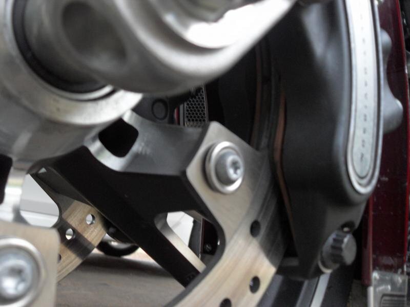

No wheel install kit... did install non ABS bearings...running Tri calipers...
Fuzzy you have me in a corner so I will have to tell you to do this at your own risk !!!
CONS: I do not know yet if the SG caliper will work on the Tri...you will have to take a closer look at my caliper and SG rotor... the caliper does overlap the rotor by an 1/16"...it is polishing the lower part or the rotor with no catching...and we replace our break pads before they are at the point of metal to metal...
With that said I say what if that break pad ever came apart and caught the lower part of the rotor...I would not believe it would lock up with just an 1/16" grabbing but who can say for sure...
In testing I did really hard breaking on front wheel...even coming to a hard stop from 60mph front break only and as hard as I could at 25mph...I feel safe with it...
