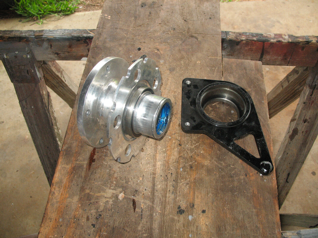

Okay folks, first remove the front tire, make sure that you loosen the brake caliper bracket bolts before removing the tire, once off you need to remove the bolts/nuts that hold the hubs on the wheel. Now remove the caliper bracket. Now use 2 of the bolts removed holding the hubs on and screw them in until they contact the rotor, now place a flat blade screwdriver between the rotor and the black hub on the opposite side. Take a turn on each bolt, tap the screwdriver , now repeat this until the black hub separates from the wheel hub. On mine the inner bearing stayed on the wheel hub which took a little time with 2 flat blade screwdrivers / small pieces of wood to pry the bearing up enough to get a puller under it. Remove the retainer clip for the outer bearing and that one will tap out from the backside. I will get the part numbers and where I purchased them. My axle bearings were good so I just cleaned and repacked them. I believe it was $360 for the 4 sealed bearings and 4 grease seals with shipping.

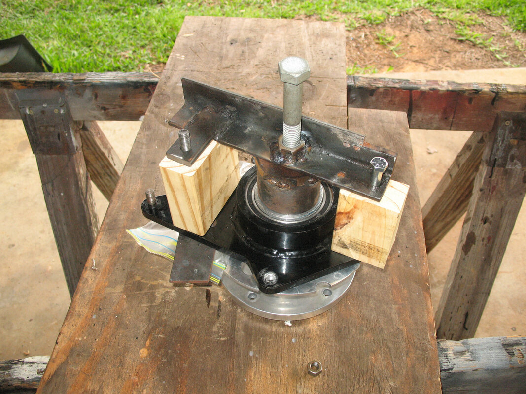

Here is a jig I welded up to press the bearings OUT. I don't have pictures of what I made to press the new ones IN, but it was basically 2x4's, PVC pipe and a 4 ton bottle jack. Pressing a bearing in requires attention so that the surface you are pressing on does not put the balls inside in a bind or you can damage the bearing. THINK IT OUT!!

Looks good but I didn't have a welder so I used my small oil filer socket that fits over the end of my old 2 wheeler oil filter. Used it to push out the front bearing from the back and start the rear bearing onto the wheel hub. Then I put the caliper hub on and pressed it down to seat the rear bearing, now use the filter socket to seat the front bearing and then installed the "c" clip. It all works, just need to study what needs to be done. I think your press is a better way but sometimes you just use what you have.
