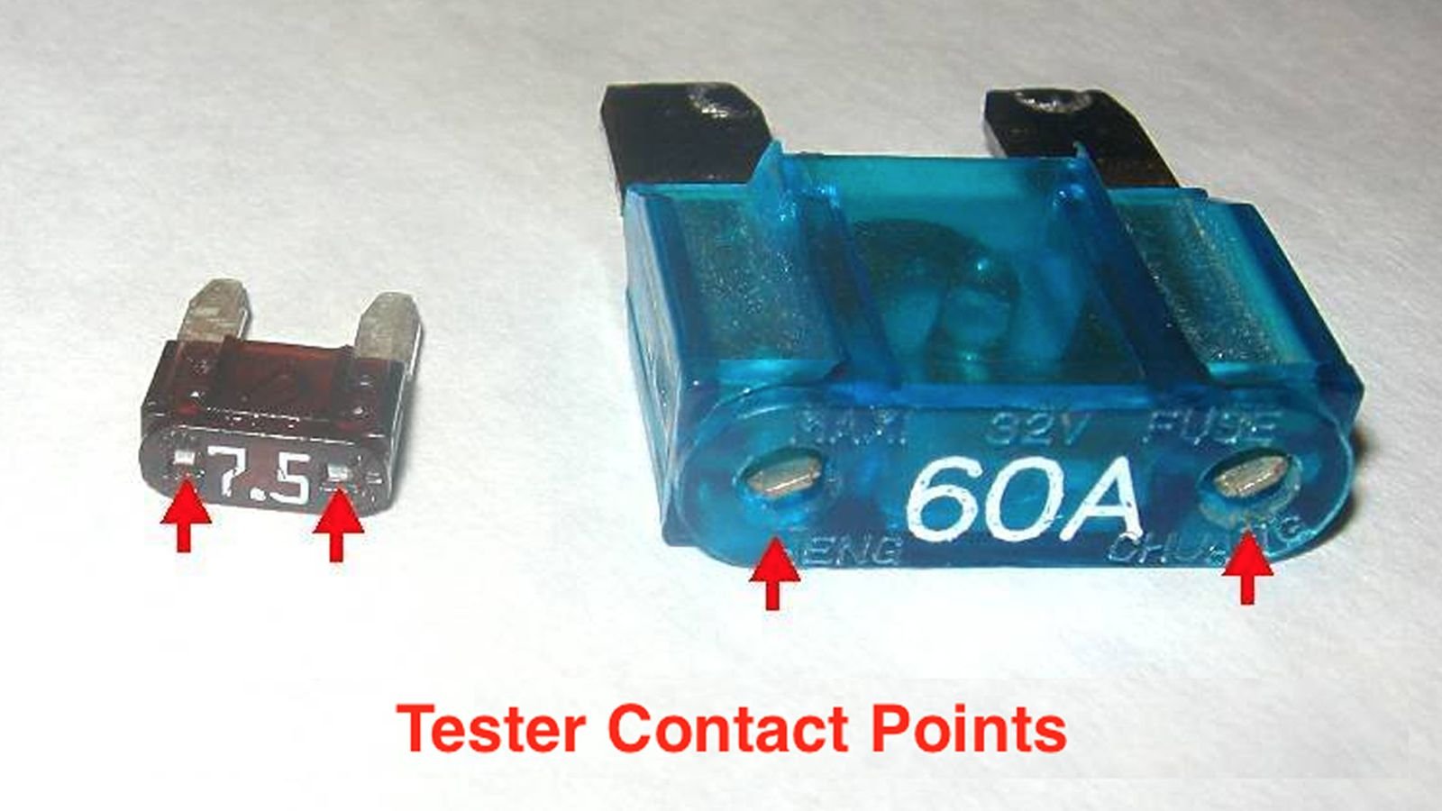

So I went back to the fuses and checked them with my multi-meter. Sure enough, one that looked good, was actually bad.
Replaced it and all was well. 2 minutes worth of work got turned into over an hour.:xzqxz:
I could have saved time, as Jack noted in his post, about checking fuses.
Most fuses have tester contact points (see photo below), which makes testing them even easier.
