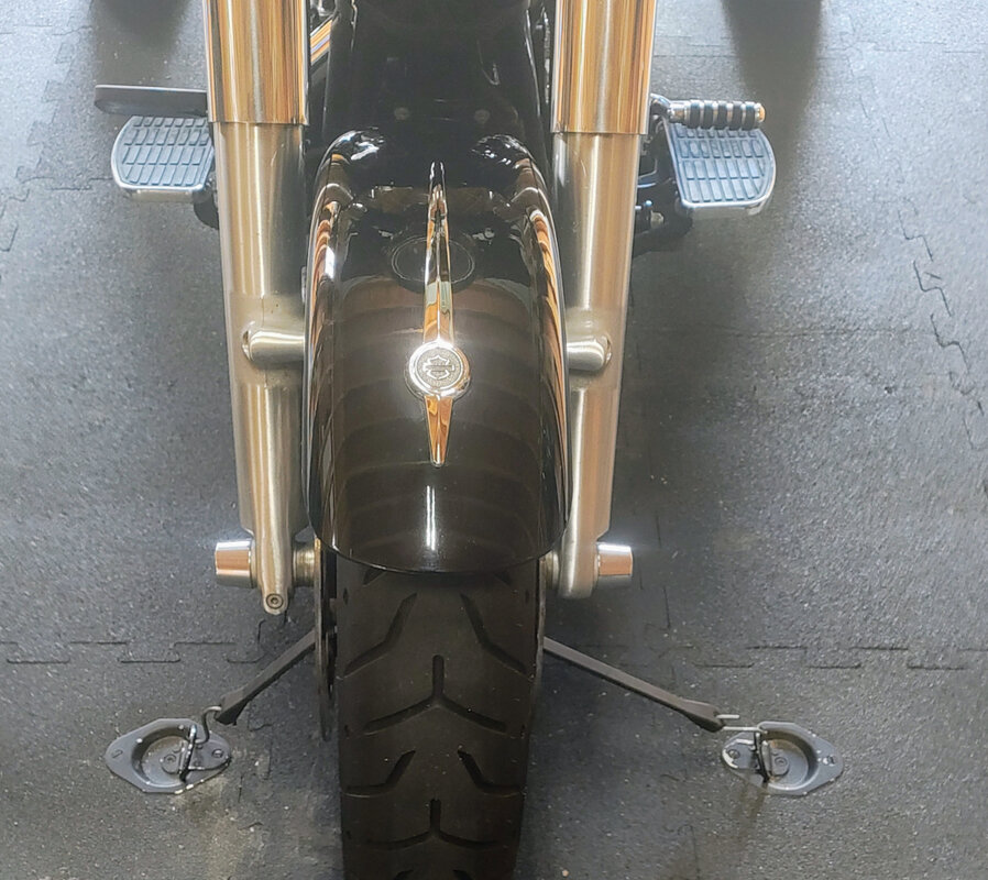

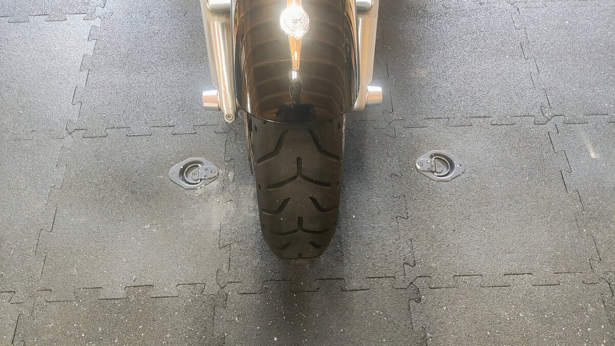

As far as jacking it, and Im gonna get roasted for this im sure, I used a floor jack with a 2x4 across it, at the very rearmost of the frame where the clutch cover is. Went in from the side. As far as the front wheel wanting to come off the ground, had my helper hold it down (takes little to no effort) until I got the jack stands under it.
I put these in a couple years ago and they work fine for holding the front wheel down. Like you said, it doesn't take much.

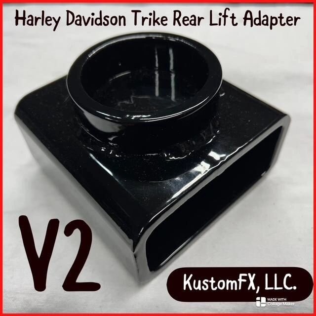

Here is my jacking solution . I use two V2 adapters from KustomFX along with two Harbor Freight trolley jacks. These little jacks work great. One will go with me onView attachment 134836View attachment 134837 long trip.
I've got one of those and it easily lifts a back wheel up with barely any effort. Guess I'm going to have to get a second one after seeing your pics.
