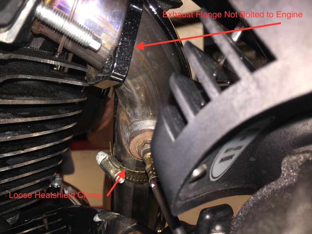

Took the new trike out Saturday for a 300 mile ride, came home and started washing the bugs off and found a loose hose clamp on the rear exhaust heat shield. While I was working on that I found something else rattling, did some investigating and found the rear exhaust flange was not bolted to the motor.

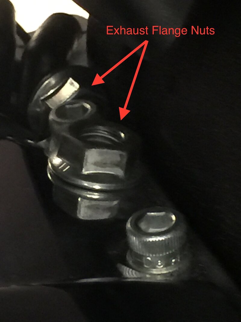

Looked a little closer and found the exhaust flange nuts sitting on top of the transmission.

On the first photo , What is the black [plastic] thing with the Finns and a white sticker on it..:Shrug:
That's the Cool Flow Fan they sell now for the M8 motors, that's one of the items I had the dealer throw in on the purchase. It actually works pretty well.

By chance did he have to play with that exhaust flange to install the fan....Looks like by the way those nuts are sitting, Some one removed them ,Laid them down, so they won't lose them.. But forgot to Put them back:Shrug:...Ive done that a few times myself monkeying around with engines...:gah:

According to the Service Manager the rear exhaust did not have to be removed to install the fan. I do find it hard to believe that working in that area the mechanic did not notice the loose hose clamp on the heat shield, or that both exhaust nuts worked their way loose and conveniently landed on top of the transmission while riding.

Very suspicious, Cause two nuts normally don't spin out at the same time and land in the same place....The truth will never be known, At least you caught it in time....

I replace my exhaust nuts with brass high nuts
shopping
With lock washers
The high nuts protect all the threads from heat, they make a good heat sink also
Torque and recheck them @ each oil change
Torque to 10-12 Ft Lbs JMO
