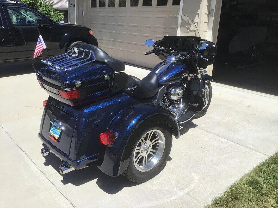

What’s everyone’s take on guards or bra for fenders? Dealership was trying to preach to me to get them asap before anything. I don’t usually go on gravel unless I decide to take trike to farm market type parking lots. Harley has a cheaper smaller version of protection that would financially be easier to get now that I could install. Also wife hates the idea of covering up blue fenders. Thanks!

I'm in the same spot you are in. I just got my Tri Glide this past spring. From what I read, people were stating the fender bras scuff the fenders. I did not get the fender bras and I now have a chip in my left fender. I do not ride on gravel either.

Can you elaborate a bit more on this? I’ve got 3 small chips in my RoadSmith kit already and wanting to put a paint protection film on the front part of the fenders. I’ve installed the product before on a car, was thinking about purchasing some in a roll and cutting a couple pieces to fit. How high do you take it or could you post a pic on one you’ve done? Many thanks!
If I posted a picture of the product installed on a trike, you could not see it...seriously! It is pretty much invisible, I have to look at it very close to see it. As for the height, I go far enough up that rocks aren't going to directly impact the paint. I'd add it sooner than later because those rock chips start accumulating quicker than you would think. If you are going to touch up the chipped spots before you have the film installed, I would give it time to cure before installing the film.

I'm the contrarian here. On my 2018 TG I installed the H-D PPF kit. Was ok but did not cover fender as well as I'd like as still got stone chips outside the coverage area. On my 2020 I went with the Hog Skins full PPF kit - rear fenders, side covers, outer fairing, lower fairing, front fender, gas tank where it meets the seat and had it professionally installed by his recommended installer in Springfield, MO.
Was better than the H-D as it covered more of the rear fender area but got some small cuts from rock hits. I know it is supposed ot 'heal' itself when left out in the sun bt I could still see the places where hits occurred. And with both installations while not noticeable from a distance up close I could still see edges and I just did not like that. And over time it did yellow just a slight bit. So I'm going naked on my 2024 and just ride it.

I have a 21 TriGlide that I had a local car protection place install XPel about a month after I bought the trike . The film is over Snake Venom paint and has held up really well over the 37 k miles I’ve put on . It is still clear and not beat up looking. IMHO far better than hat HD sells
Don't waste your time with all the products already mentioned. Oh they work to one extent or the other.....but in the end they are too thin. I've had good results with Vivvid brand. These have a sticky backing and are of heavier construction. Still, I install it with a slip solution and the magical mystical trick: steam! A garment steamer is my friend and allows me to stretch and pull the material.Tip: spray the surface with slip solution ( water and baby shampoo)and use a plastic squeegee made from a putty or body filler blade with a piece of micro fiber towel glued over the edge with 3M Super 77.They have a bizzilion color options.So the color is not a perfect match but close- so what it adds contrast.( I don't like clear) Price? Competitive with others so I buy it by the roll. YOU DO NOT need full fender coverage- impacts are mostly to the front of the fender and to the gap between fender and body. A small wrap is used on the front fender tip.But hey go wild if ya want.You'll be frustrated at first but practice makes perfect. YOU CAN DO THIS!
