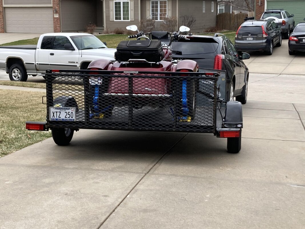

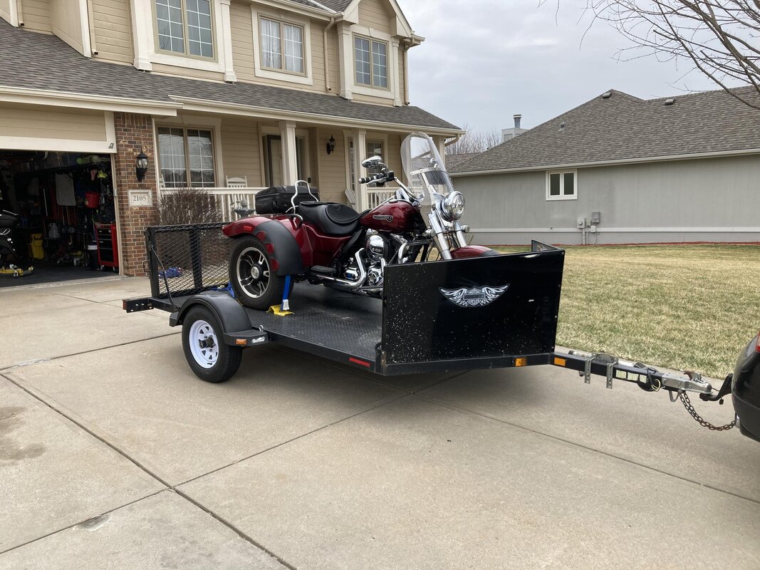

Well I got the Erickson wheel chock kit installed.
First; if you’ve got a Triglide save your time and move on this ain’t going to work for you.
The way the Triglide fenders wrap the wheels in front and back will likely not allow for enough space.
I think you could ratchet down the straps but there’s not enough clearance to release the straps.
If you have a Freewheeler, UTV, ATV, lawn tractor or a car to trailer this setup is pretty sweet.
Installation was easy and it only takes a couple of minutes to strap down the rear wheels.
I think with this setup all you really need is this kit and you’re good to go.
I however like to go overboard so I ended up strapping the rear hooks and securing the front.
Took the rig for a short ride down the highway and down a known bumpy back road and the Freewheeler never moved.
On a final note; when unloading you have to be on level ground or facing uphill.
The electric reverse motor isn’t strong enough to get over the rear chock if the bike is facing downhill.
If you notice in the attached pictures the Freewheeler is facing down a slight slope in my driveway.
I could not off-load the Freewheeler in this position as I popped the reverse breaker so I had to pull out into the street to get the trailer level.

I wanted to post a follow-up on this Erickson wheel chock kit.
After a few load/unloads it is apparent that getting over the rear chock with the electric reverse in my opinion puts too much stress on the reverse motor.
Since the front of the rear wheels were tight against the front chocks anyway the rear chocks really weren’t serving any purpose so I decided to remove the rear chocks and replace them with 6”X5” e-track plates.
These e-track plates provide the same function as the rear Erickson chocks did which is simply a tie down point but are only about 1/2” tall.
So in my opinion if this type of setup is desired I would simple go with either e-track plates in front and rear of the rear wheels or perhaps better would be to put down two extended length of e-track rails and park the rear wheels on the track, then take two 2” ratchet e-straps and secure the rear wheels.
In closing just so as to be fair; nowhere does Erickson state that their wheel chock kit works for a Harley Freewheeler.
I simple thought it was a good idea and decided to try it out.
I still have a good tie down system but could have gotten the same results a little cheaper than the $50 I spent on this kit
