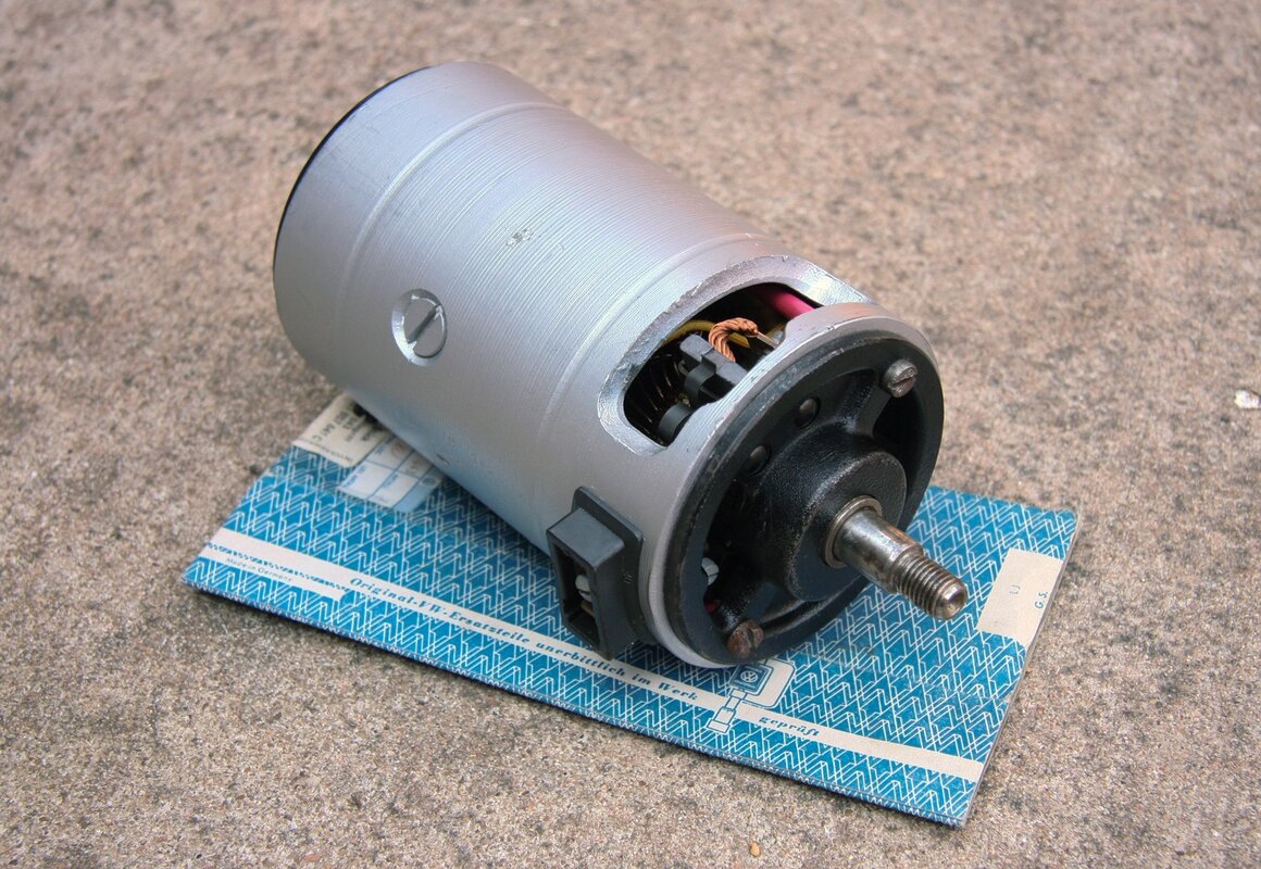

You already have a 12v generator (6v lighting is like driving by braille) so the 6v starter will work fine. Keep your engine in tune and don't abuse the starter. I ran one for years on a daily driver baja bug of mine.

Good catch!
I missed the 67 generator.
Now that might mean it is a 67 model 1500cc.

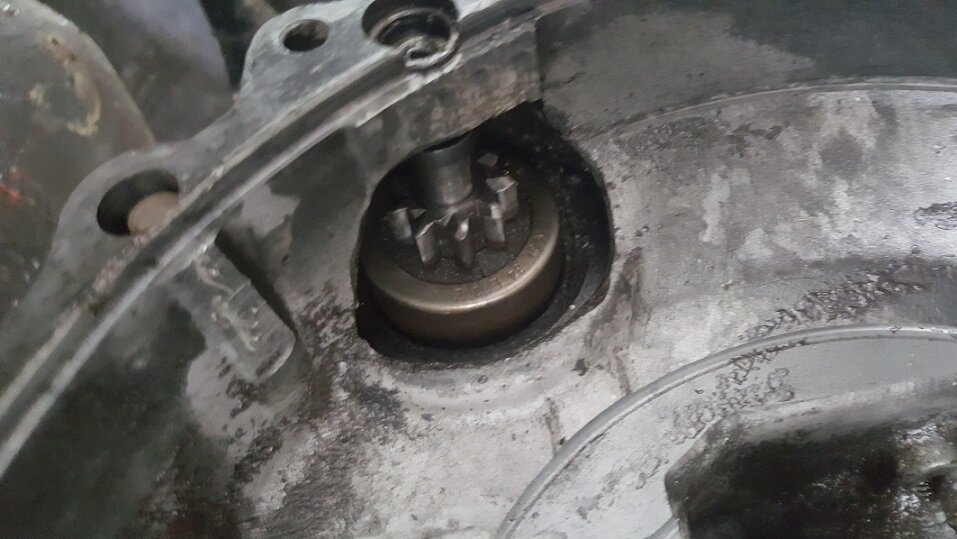

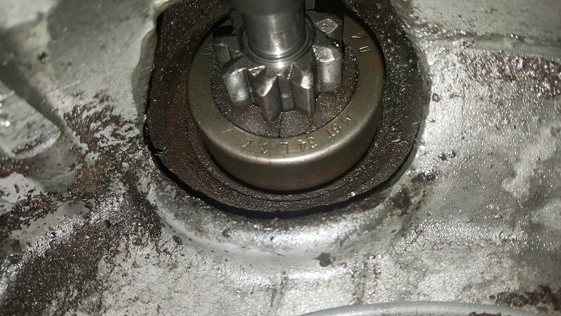

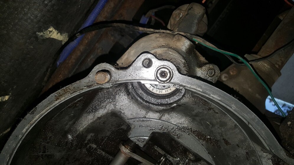

I took a few pictures of the starter in the bell housing maybe yall can determine if it is a 6 or a 12v
Sorry I couldn't really get to the back side because I did have any help to get the body off.
Starter is mounted by 2 bolts. One is the motor mounting bolt and the other is a short bolt across from it on the bellhousing casting. (to the right in the picture) Just pop it off and the starter slides out towards the front. Then you can read the P/N and voltage stampings on the starter motor body.

If I am reading everything correctly here, you've already determined that you have a 6-volt type transaxle that has been clearanced for a 200mm flywheel. You have a 180mm flywheel installed (i.e., 6-volt type), so the starter has to be a 6-volt starter to mate with the 180mm flywheel teeth, irregardless of whether it is powered with 6 volts or 12 volts.
As already mentioned, 6-volt starter spinning on 12-volts is a wonderful combination. I've had several in the past and have never, ever had any problems at all.

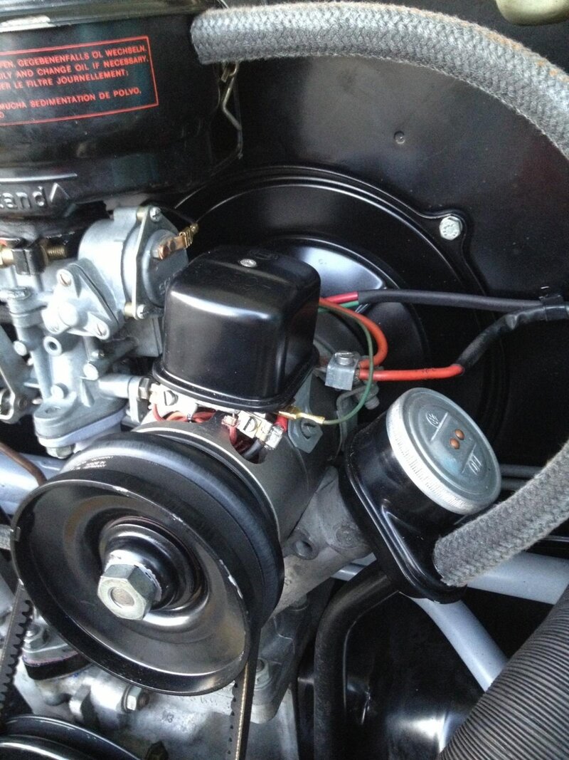

Has a 1200 (pre 66) carb and 67 generator.
I thought it looked like a 1300/1500 single port.

I did see the pictures and totally agree, I believe it's a pre 66 1200. I did notice the 12 volts 67 gen on it.
With that said, I'm betting the transaxle and engine were out of the same donor car and someone had the 67 generator to make the 12-volt conversion.
However, with the inside of the bell housing being ground out, I'm guessing the went with a 12-volt flywheel and starter. No other reason to grind the bell housing out.
