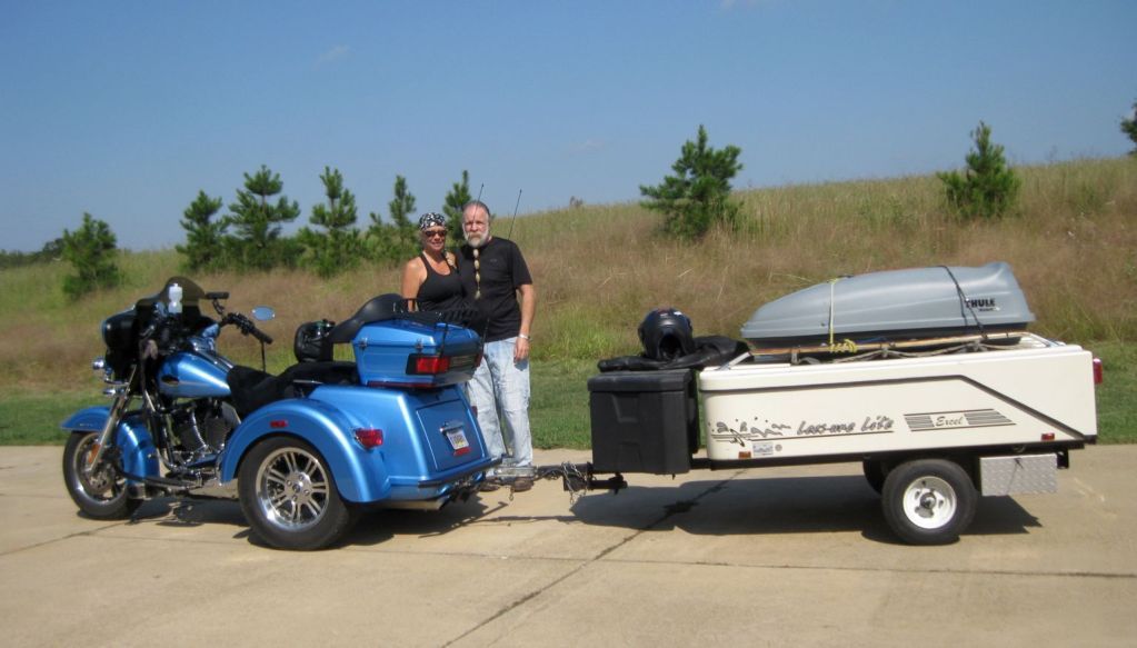

Pic of us camping, somewhere up north a few years back. We were just there for the night, did not even unhook the trailer from the bike before setting up camp.
Here we are at a rally, with the pop up and the TG-
