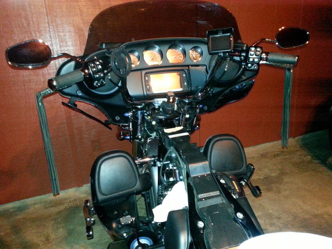

I changed my bars in 2014 to Khrome Werks 2+2 wide sweepers. The back and shoulder pain I was having with OEM bars was horrible, the forward leaning posture was killing me. If I had not found these bars I was ready to sell the trike and call it quits. The grip angle is straighter by a few degrees the width is about four inches wider this is like adding power steering to the trike and really helped my smashed up right wrist. Good luck in your search I changed these myself for less than Two Hundred bucks a longer clutch cable was all that was needed. Changing bars is not rocket science this was the first attempt at wrenching on the Harley. If you take your time and get a shop manual or down load the sections you need to get it right. Ball end allens for the radio screws they are at an angle that was the only thing I didn't have DSC00552.JPGDSC01196.JPGDSC00550.JPGDSC01022.JPGDSC01012.JPGDSC00553.JPGDSC00132.JPGDSC00271.JPG
I changed my bars in 2014 to Khrome Werks 2+2 wide sweepers. The back and shoulder pain I was having with OEM bars was horrible, the forward leaning posture was killing me. If I had not found these bars I was ready to sell the trike and call it quits. The grip angle is straighter by a few degrees the width is about four inches wider this is like adding power steering to the trike and really helped my smashed up right wrist. Good luck in your search I changed these myself for less than Two Hundred bucks a longer clutch cable was all that was needed. Changing bars is not rocket science this was the first attempt at wrenching on the Harley. If you take your time and get a shop manual or down load the sections you need to get it right. Ball end allens for the radio screws they are at an angle that was the only thing I didn't have View attachment 72502View attachment 72504View attachment 72505View attachment 72506View attachment 72507View attachment 72503View attachment 72500View attachment 72501

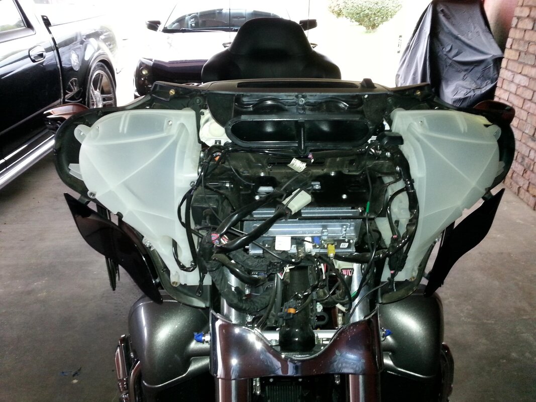

Last December I bought Khrome Werks 2+2 Narrow Sweeper Bars which are built for use with Harley's Bat Wing Faring and the Electronic Throttle Control (ETC). I did my own installation using 2016 Touring Service Manual and online video. After threading the lubricated ETC harness through the bars, I wimped out and didn't attempt installation of the other control harnesses inside the bars. I'm completely satisfied with my cable install method and I'm thoroughly satisfied with the new bars.
So if you have a Service Manual for your year trike, then lots of patience and videos you can get the job done correctly. Torque Wrenches inch and Foot Pounds are must have items! Ensure electronic cables are not pinched or stretched excessively, the wires are very delicate. Take photos of the cable routing on the interior faring. Again, with patience and attention to detail, you'll get it done.
Hope you find a suitable set of bars to your liking.
