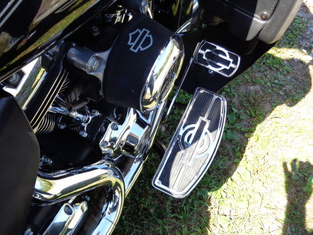

As mentioned love jug fans are supposed to work well. Floorboard extensions move the legs out about an inch on each side. At this time I am thinking about the DK Customs tank lift with the wings to increase air flow over the motor. I also might go with the remote oil filter and cooler depending on cash flow. Try angling the left lower vent in a little to direct the air towards the motor/rear jug, I found this helps a little if your moving. A decatted header can be found on eBay fairly cheap, same as all the m8 touring bikes. Also the m8’s run slightly richer the the twin cams, but.......

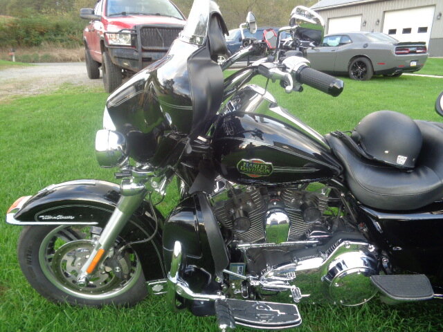

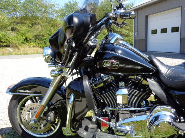

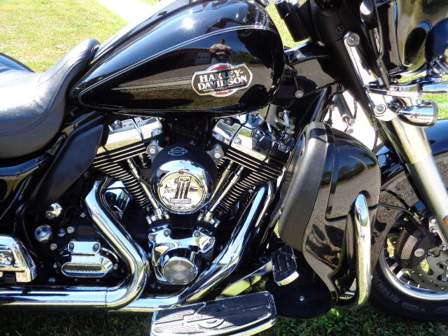

I had to do something to make a long story short... I raised the Fuel tank DK customs deluxe 2" lift, installed DK Customs Air deflectors, extended floor boards, Power Vision tuner really helped,and I removed the so called heat deflector on the left side mid frame to let the built up hot air somewhere to go. And last but by no means least Love Jug Mini Might Fans. In 2009 the Triglides had no Cat. unless it was a California model, and then it was in the right muffler or so I have been told.
Now we can cruise around with the temperatures 220 to 230 degrees on 80 to 85 degree day and leave a slow speed town at 245 degrees. The expensive part is the Tuner you chose and the Cooling fans, for what we pay for these wonderful machines it is not really an issue to make them last longer and run stronger. Travel safe Fred
P.S. I am now looking at replacing the OEM oil cooler with a fan assisted one just insurance against heat related failures.DSC00132.JPGDSC00139.JPGDSC00141.JPGDSC01023.JPG

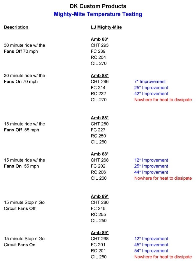

The major results do not happen at normal riding speed out on the highway with air temps below 90. With temps above 90 the jugs keep my oil temp down around 230. If I run into traffic delays or slow riding through a town/city, the jugs also keep my oil temp down around 230. In both those situations with the jugs turned off my oil temps will climb above 250 to 270. Even higher if action is not taken. I've even allowed it to do that and at 250+ I have turned the jugs back on and the temps will SLOWLY start back down. The key is to prevent the temps from getting up there to start with. In normal highway situations and temps below 90 the jugs do NOT make much difference. I ride a lot about 12k per year and I encounter high air temp and slow riding conditions so the jugs do the job for me. Also I run a Dakota Digital gauge for my oil temp which gives me good data.
"DK" Products has an extensive testing of the jugs on their site that also supports the effectiveness of the jugs.
But again YOUR riding style may not get the results that I have or the DK testing. No product works the same for everyone. Thank you for your input it lets people out there to known that fact. What works for one may not work for you.
On the surface that sounds right. HOWEVER, it is based on a faulty assumption. "really was by blowing air on the sensor"
The Engine Temperature Sensor is buried deep in the metal of the cylinder head. The only way the fan blowing can reduce the temperature that the sensor reads is by cooling the cylinder head around the sensor. That is what you want to happen...actually cool the cylinder heads.
To be clear, the sensor is not reading temps that are outside the engine (where the fans are) it is reading the temperature inside the metal of the head, right near the combustion chamber.
That said, I have heard of a few people that have installed fans and oil coolers that have reported that they have not experienced any significant drop in engine or oil temps. I don't know why.
I have personally done extensive testing on a half dozen different bikes and trikes and always seen a very measurable drop in temps. (see video and chart below)
