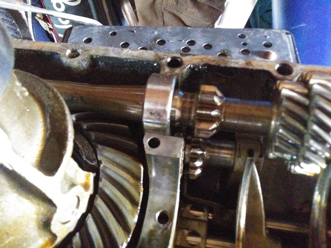

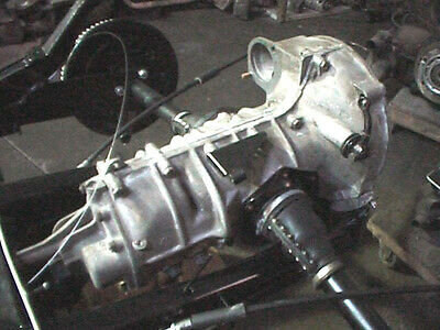

I need to repair reverse on my VW trike and have not learned the step to remove the axles. Does a person just split the case or is there a bolt or snap ring that I'm missing ?trike 2.jpg it is the very old type transaxle Vw-Type-1-2-3-Bug-Bus-Ghia.jpgthanks for any help. Don
Welcome aboard Don. We have a couple of VW guys on this forum I'm sure one will jump on this shortly.
Thanks Gorilla, I have the trans out and the axle tubes removed and all other pieces, But where I thought there would be a snap ring. "NADDA" I suppose I could just split the case and slid it past the axle.:xzqxz: but sure would like to hear from a been there done that source.:help:
Sorry to say guys but I think I must reach back farther in time. I've seen both web sites but not the right tranny. On the inside of my bell housing I see what appear to be dates formed into the casting on one side it's 10 - 11 - 28 on one half and 13 - 11 - 38 and I'm thinking back before the war or during the cases where joined to create this Trans. these numbers are not stamped but part of the mold during casting. A short build history is I merged a 1600 cc single port out of a spray coupe to the trans with some creative grinding on bell housing and a mod to the throw out bearing arms. I have this in the basement hoping to give it a go.fus 22.jpg
Hens Teeth Alert!!!! This is a non-syncro 1st gear transaxle last used in 1959. These were built for 25 and 36 HP motors. Parts are obsolete and rare for these and really only of interest to the restorers at this point. Check out: https://www.thesamba.com/vw/ for more info and parts availability. You will probably be better off upgrading to a later model transaxle with parts availability. As far as I know, with some caveats, any swing axle transaxle up to 1968 will work for you. Check out Rex's thread: https://www.triketalk.com/forum/threads/35579-Tech-Tech-Tech-or-So-you-want-to-build-a-trike for a lot of good info. We will be glad to answer any questions about interchangeability for you (and believe me there is a lot of interchangeability!!!). Good Luck!
And also....
This split case is going to be very low geared and easy to break with a 1600.
As far as mounts....there is a specific model of nose mount or and adapter mount that you will need for the nose cone end. But other than that it is a direct bolt in.

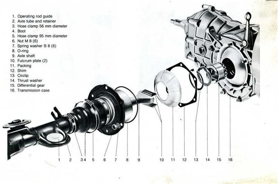

On the axles. I have seen where folks have used the old split case axles in a tunnel trans swap. So that makes me assume they have the same snap rings and fulcrum plates.
Any 61 to 66 trans will be the easiest fit, but will still be low geared for a 1600. A late 66 through 68 trans is the one to have. It will have the gearing for a 1600, even though you will still want taller gearing still.

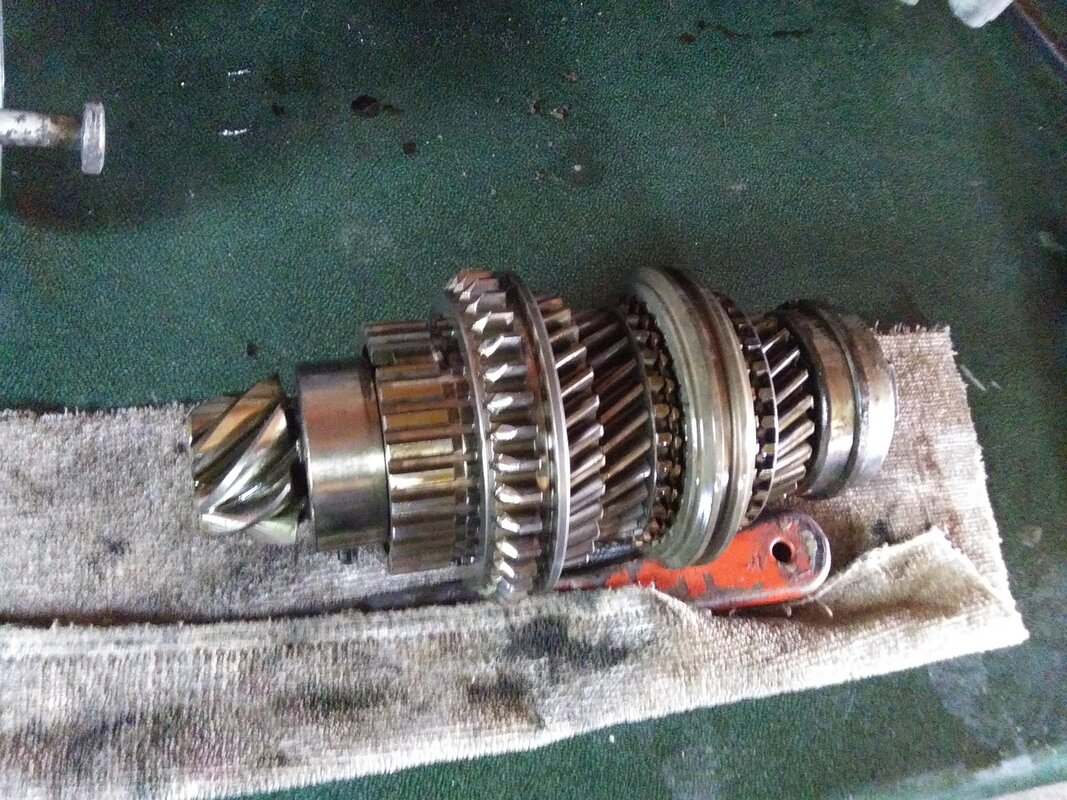

I split the case and found some bad gears. 1st is half wore out and reverse is a crying shame and the 10 tooth input shaft gear is half wore away. So off to the internet and see what can be gotten and if not, time to take good advice and upgrade to some thing newer. Thanks much all for the insight and I will do my best to become a active member. I have been a long time member of HBA Forum and this is a great change to aid in my love of building and riding my Trike. My boy can't wait till he gets a ride.:) trike 3.jpg and also warm weather.

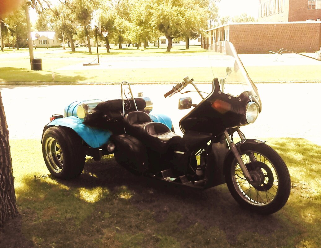

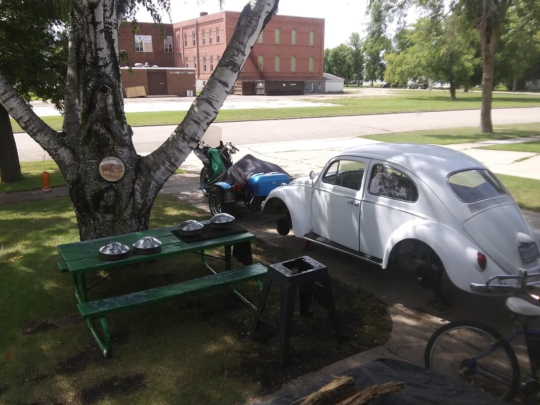

I repaired my trike with used parts and works great and then worked on getting it ready to sit out in the weather full time. The 62 Beetle in picture is up for a brake job and I will say it does have a smoother shift. I.m glad I tore into the old trans it taught me a lot and I think with the trike trans it important to remember there is no first gear sync.trike 4.jpg
