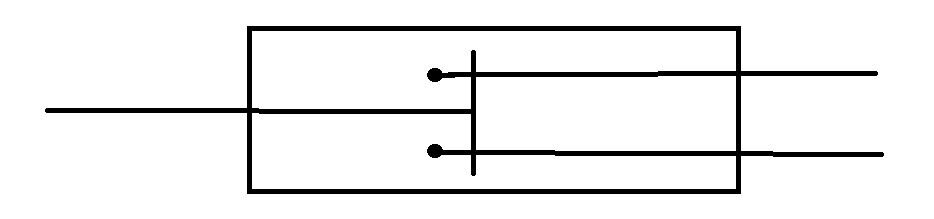

So i don't know if this is what you are looking for or not
This is something like what I was shown when I wanted 2 throttle cables.
I wanted foot throttle and a hand throttle
Below is a very quick drawing of what I was told about.
Basically either of the 2 cables could pull the center section and pull the throttle
The other cable would just slide through the center section
I know not very good example but im trying to do this from memory of something I have have never seen

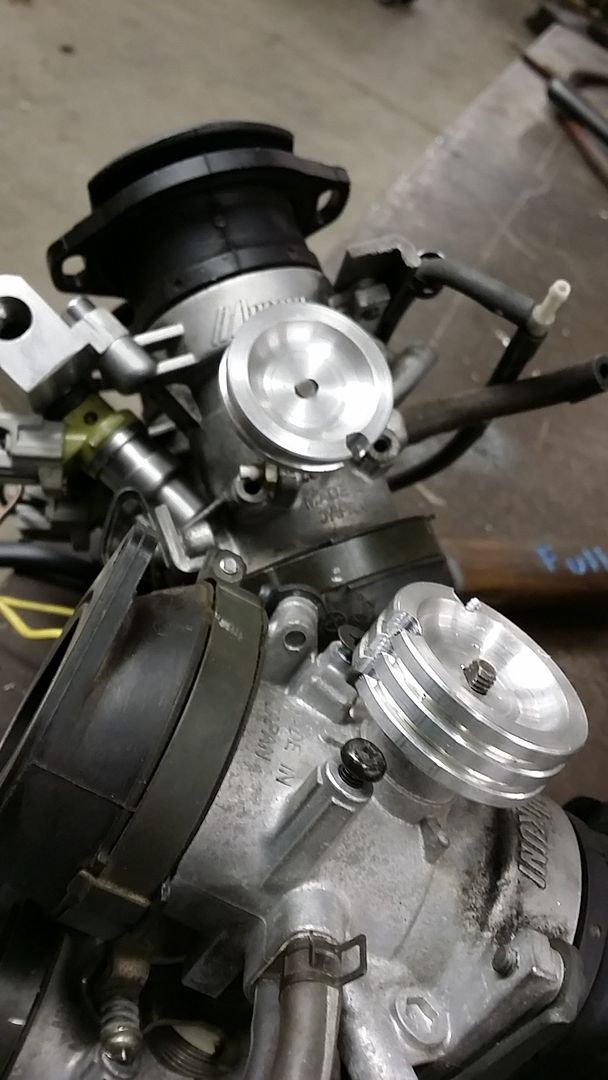

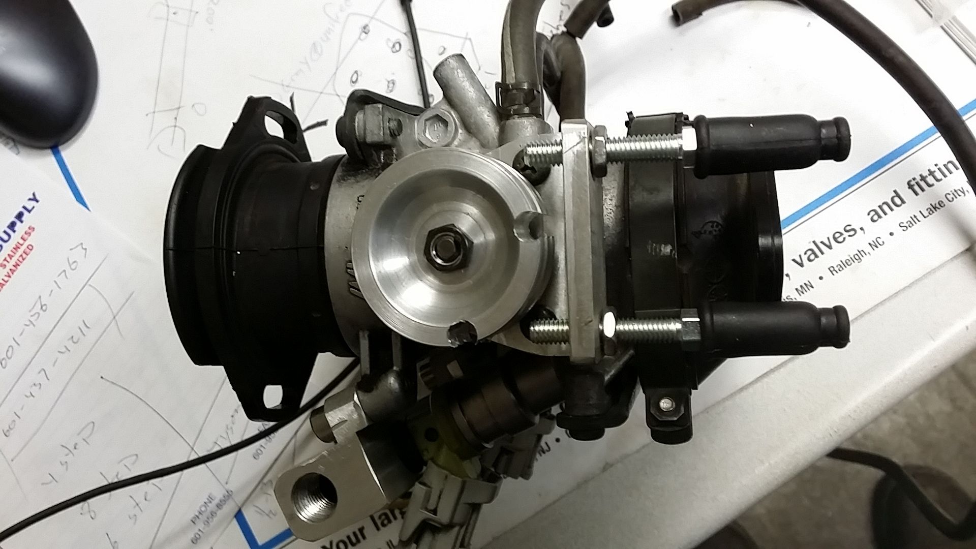

Just need the two groove wheel on the throttle shaft. Maybe adapt something from a bike. Or machine one from scratch by your own dimensions.
It would look a lot like this.

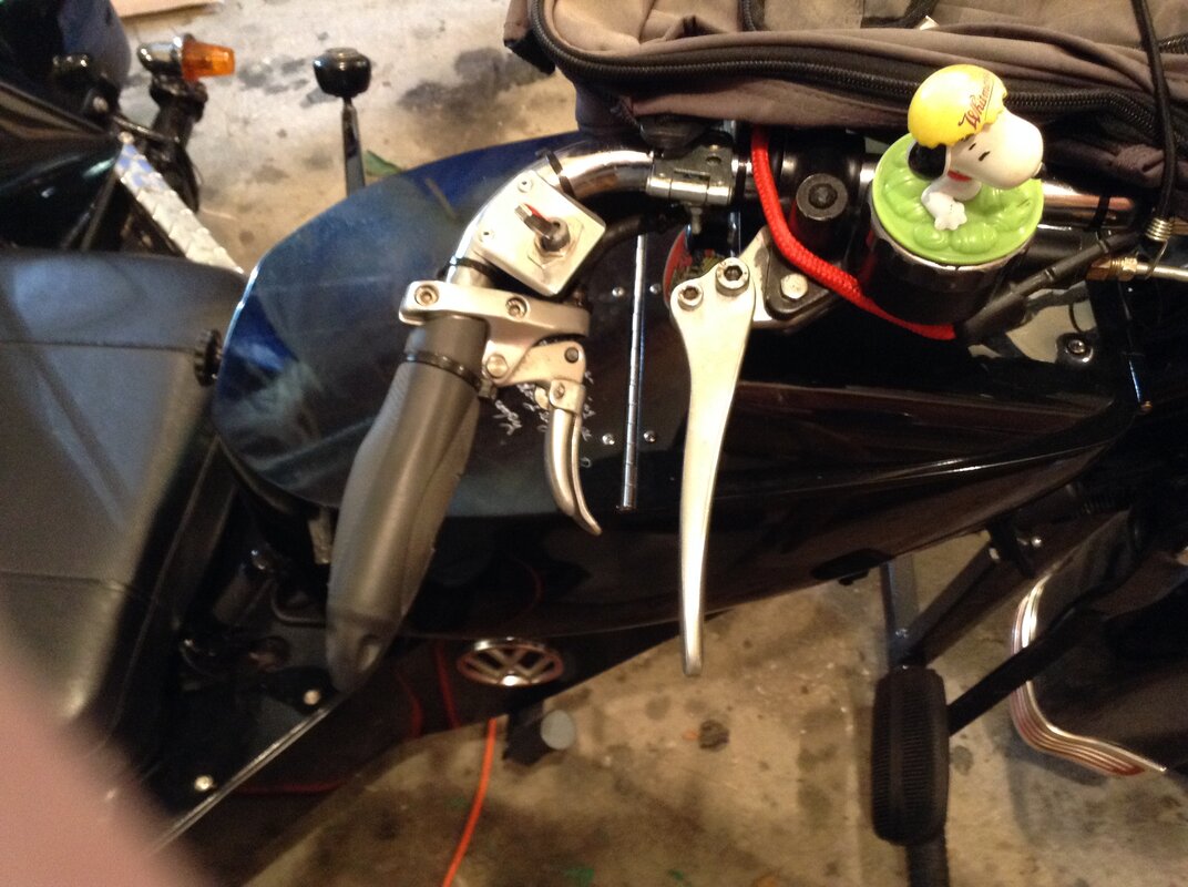

image.jpegHow about this. Its a thumb throttle for an atv. Got it on ebay. Works with two fingers easy. My wrist was broken and I have a plate with screws in my hand so l went with this. Probly on there for 5 years or so now.
Sidecarbill, does that work with a standard throttle cable ball or barrel end and attach to a 7/8 bar? A VW trike down here is pretty unusual and mine is unusual for the unusual. Your set up would fit well if it comes in black.
Thats a standard cable end. Its on 7/8 handlebars. Don't know what colors you can get. I don't know the ebay seller, its a long time ago. Just go on ebay. Look for thumb throttle 7/8 should bring up plenty. I actually think you could use a brake lever from a bicycle. Thats what I was gonna try but then I found this.
