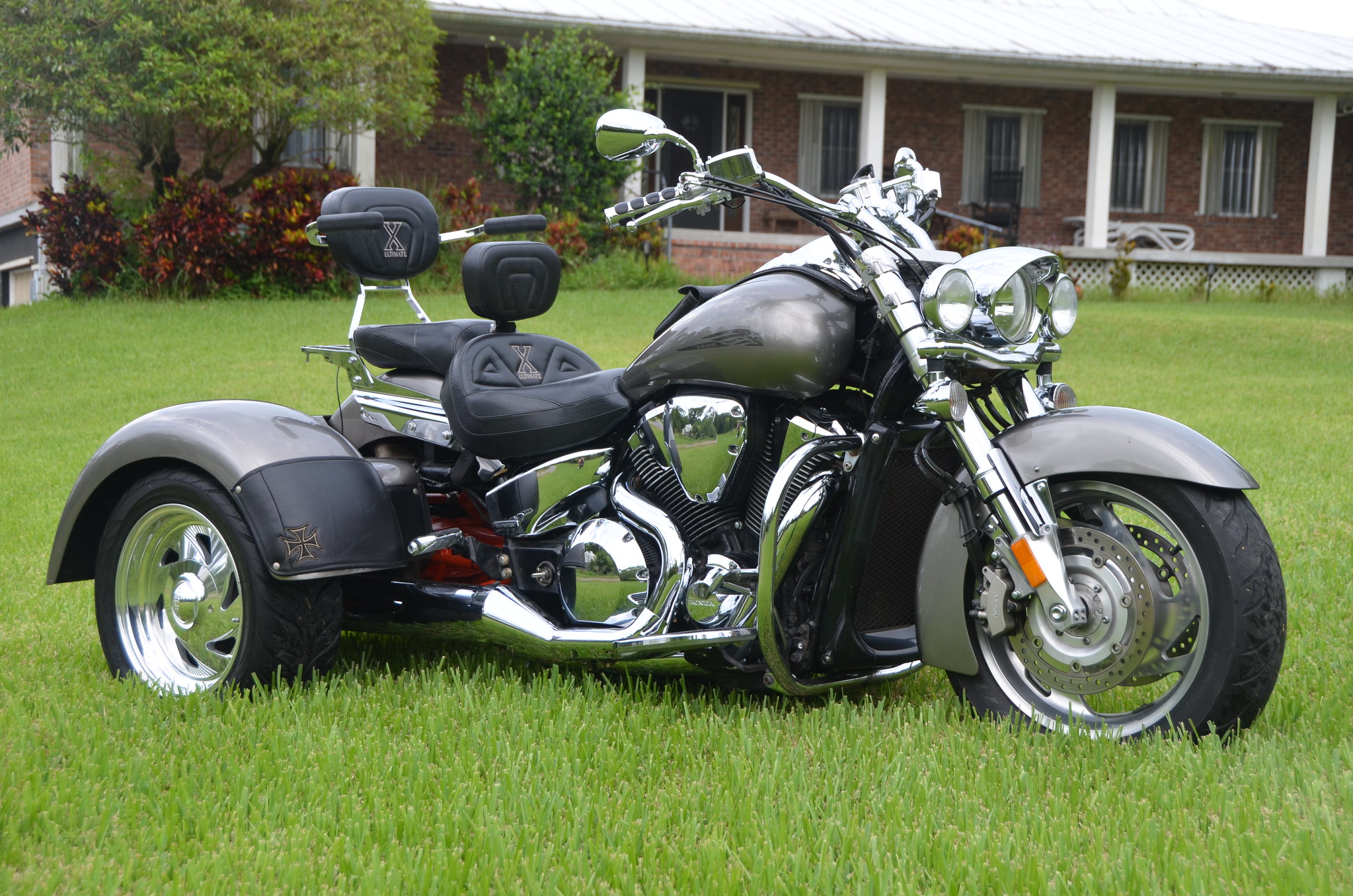

Not sure what picture you are referring to, this is my ride -
Very comfortable distance rider, we usually go 200+ a day when sightseeing. The rear side covers are off in this picture, and a couple things unfinished, as I was still in 'shakedown cruise' mode after doing extensive rear end repairs.
I built several VW trikes for others over the years, but never one for me. I am also a Honda fan, so this trike and I are a good fit. 1800CC with aftermarket cam has me pulling wheelies if not careful.
