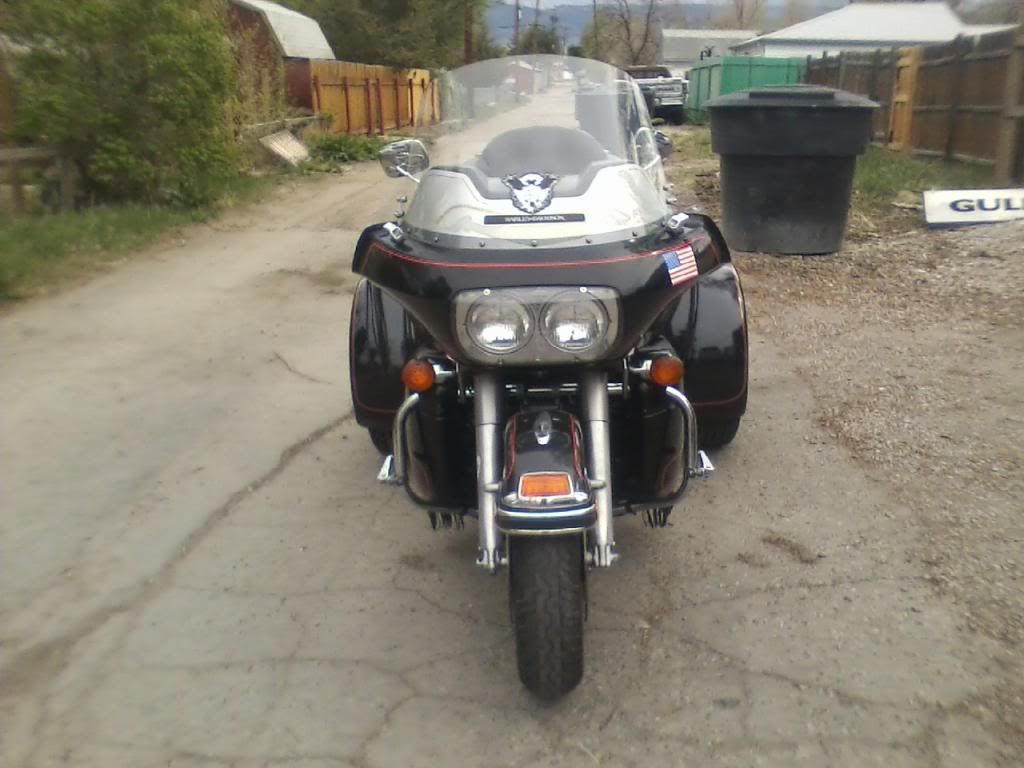

Looks good, now all you have to do is just ride the snot out of it.
Paul has a wonderful photo gallery of the entire build process here: pcombe's Library | Photobucket
Here are a couple of shots of his beautiful new trike:

Looks great Paul! How does it steer compared to your friends TriGlide? I know its alot easier to steer with the 5 degree rake kit.
Hi zook:
I can honestly tell you that my steering is quicker and more responsive than the tri-glide.
As you know, I managed to incorporate the stock, air over hydraulic anti-dive system, so my trike feels more secure when stopping than the tri-glide even simulating emergency stops.
I don't fight it through curves and have a bit more head shake than the tri-glide.
A steering damper would make them equal, But my trike in no way needs it.
Ron and i have been switching off trikes road testing mine, and with 40,000 miles on his tri-glide i reckon he is qualified to say the ride on my tour glide is every bit as smooth as his.
I would recommend that anyone considering a conversion look into to the (H.H.I.)
Hog Halters brand from zook and save themselves a lot of bucks.
The quality is far superior to Harley OEM.
They have some real nice features also, like hand screwing your forks and neck stem into the upper triple tree and taking the guess work out fork alignment, and eliminates upper fork clamps. ( Put your pipe wrench away!)
