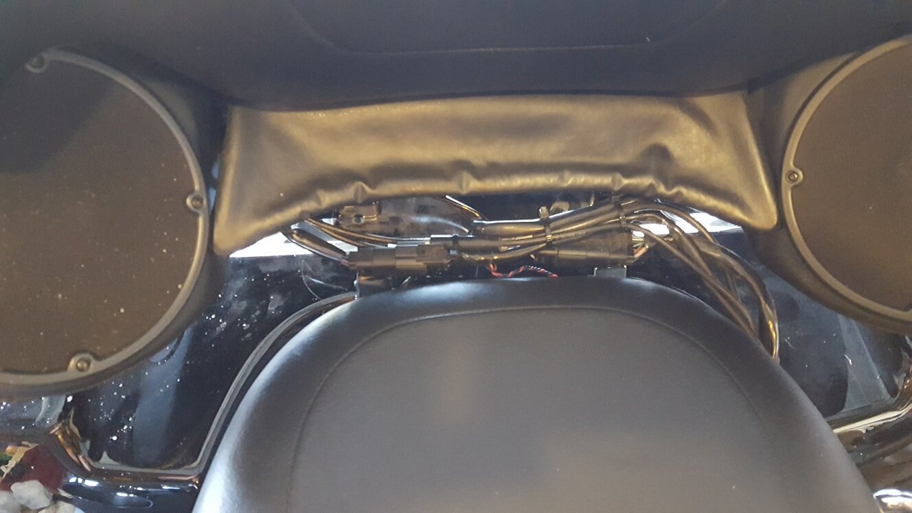

Why no talk of this issue?
So - Other than my stupidity regarding the clip release on the electrical....pretty straight forward install. But curious why nobody here mentions the large gap created over those harness connections? No one sees this as a issue or just an eye sore? I understand had I sat down and tried to think this all the way thru, that I MIGHT have wondered if the skirt would still cover that gap. Now what?

Kuryakyn makes a filler pad for this
"Filler Pad for Tour-Pak® Relocator for '14-'18 Touring & Trike, Black Item #8742"

A lot of us have used the extender in the link below or had one made by someone local.
https://www.kuryakyn.com/products/4076/filler-pad

So Again my question.....curious how this can be and it's not mentioned....not on the DK site or with the previous responses? I'm not mad at you guys, just surprised....
OK....maybe a little upset with DK for not addressing this issue....

So you will not get too upset again, :Dhere is a possible problem you might have. When I installed my Kuryakyn extender, I had to get a couple of new screws to install the new one. The part of the Kuryaykn that actually mounts to the tour pak is thicker than the stock pad, or at least on my 2016 TGU it was. YMMV. I didn't want the screws to cut through the material on the tab while tightening. So i found a couple just a little longer and used a small Chrome washer with them.
Yup. Same here. I bought the Kury relo kit for my '17 CVO Limited and then of course transferred it to my '18 Tri-Glide. When I installed it on the '17 I too found the stock screws too short to get the acorn nut on and had to make a trip to the hardware store for some longer ones. I called Kury and advised them of this. The guy I spoke to said he would pass it along but since that was in Sept or 2016 I guess nothing has been done.
I have always found Kury's parts and instructions to be spot on. This was not a bigger but a frustration nonetheless.
Hi JC1300,
Just saw this thread. I sincerely apologize. I thought we had the fitment note about the filler pad in the description.
It is back in there now. Apparently when we migrated to our new website last August, that did not make it in the migration from the old site.
I know that it being back in there now does not change the hassle you've had, I am very sorry.
Also, looking at your photo, my recommendation is that you disconnect that bundle of wires from the clip on the chrome rack. Then use the supplied zip ties to get that bundle back closer to the Tour-Pak, out of the way of the passenger. (#7 in instructions)
That is what we did on ours, and the wires pretty much disappear behind the pad that hangs down. On our TG we use a sheepskin over the seat, and do Not use a filler pad. No one has ever mentioned the gap, and no wires are visible.

Kevin - First off thanks - This is really a quality product - The floating cross member is a great idea - and it's solid as a rock. No problem just what I stated earlier - To go from done to not done....you get my drift. I did move the wiring back on both and it does move it back far enough that I am confident Joanne can't sit on the connections now. I've ordered the pad and with luck it will be here Monday - leaving on Wednesday....with the Dog......embarrassed to admit it, but it was the reason for the relocation kit.....I've already turned in my man badge....
