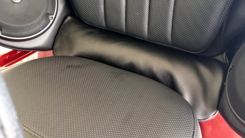

If the Tourpack is moved the full 3 inches, what is the best filler pad to prevent the passenger from falling in the gap. The Kuryakyn is frequently out of stock. Candee Customs has been mentioned as making a filler pad. Does anyone have experience with them, possibly pictures?
I took my filler pad to an auto upholster and had them add 3 inches. Cost me less then $50.

This is the Kury filler pad on my '21 trike with DK relocation kit
