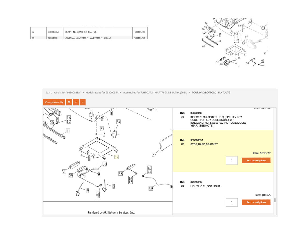

My bike... a 2021 Tri-Glide approaching 10k. I keep my full face helmet in my trunk, and after todays ride I went to put away my helmet back in the trunk, and after opening the trunk I found two sheared off mounting studs (of 6 total, three on each side) that attaches the tour pak mounting bracket to the trunk.
They are sheared below the nut (see attached pics). The bolts/studs are integral to the bracket per the parts diagram (not separate bolts). IMO, to break where they did indicates the studs were "stretched" (over torqued) when attaching the bracket to the trunk.

Boy that sure sucks. I never heard of anything like that. Any chance you could drill through the bracket and just add regular bolts? On second thought after looking at the diagram I see that would be difficult.
