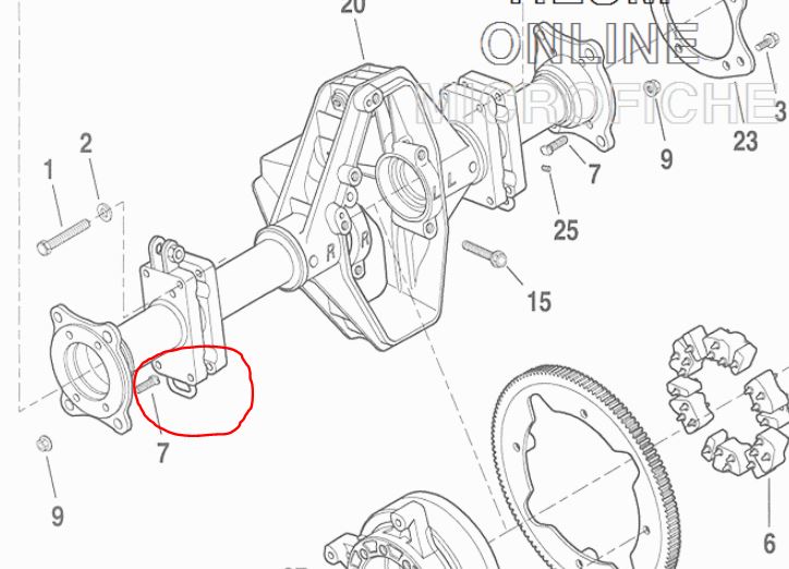

Where we have lifted it up...ONLY One side at a time, is on the blocks, circled in red below, right were the tie down loop is. We did not lift on the actual loop, but on the two heavy blocks that are circled.
Feel free to call anytime.
Thanks, was thinking around that area or a few other area's, my jack in my truck is a scissor jack but I do have a 5 ton bottle jack. I do have a short piece of 2x4 with a slot in it for the tie down ring, tried that yesterday with floor jack but the mufflers were in the way and I couldn't get it just right, never thought of going from the side with floor jack or maybe with my bottle jack which I think will be to high, will check out my scissor jack another day, I know I will get it done someday and with the heat here it is pretty rough in the garage even with my fan going. My friend has a air in his shop this year and he said it is really nice now, wished he had done it many years ago. I might call you someday if I run into trouble with this, shouldn't after helping my friend do his, different years but he didn't have the parking brake bracket to deal with.
