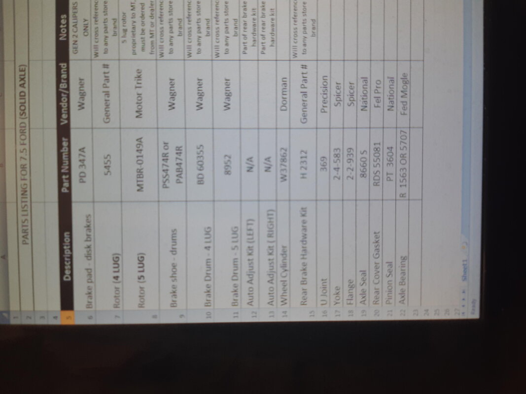

I just got an e-mail from Motor Trike and they provided me with a parts list for the brakes. Solid axle trikes use the 7.5" Ford, common in 4 cyl Mustangs (Fox body) These normally come with 4 bolt hubs but mine has the upgraded 5 on 4 1/2" pattern. I'm also looking to go from drum to disk.

Would you share the part numbers for the conversion, I have looked for 7.5 inch ford rotors and I don't find them listed anywhere, to include the mustang (fox body) cars...

MT sent the file in EXCEL format so I took a photo and will attempt to attach it.
Failing that, send me a PM with your e-mail.
OK, so that didn't work!
Send me an e-mail!
mike.levesque1945@gmail.com
Oops, I guess it worked!!!
Mustangs of those years never had disk brakes on the 7.5" rear ends. They did in V-8 cars equipped with the larger 8.8" rear ends Drum to disk conversions are available in the aftermarket. I've e-mailed MT again and asked for the year & model so that I can research further.

GOOD LUCK.... I find their customer service very lacking, especially for older conversions. Apparently they don't keep very good records and when they transitioned to a new computer system, all of the info on older conversions was not saved. When you get time, please email me the list. The photo has part of the description, etc missing..
