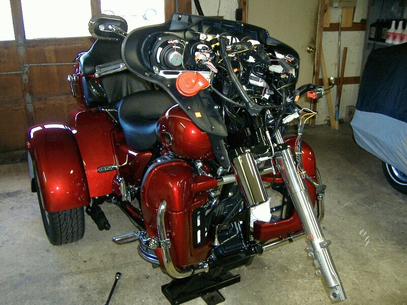

View attachment 26190View attachment 26193View attachment 26191View attachment 26192

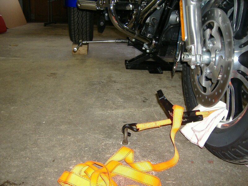

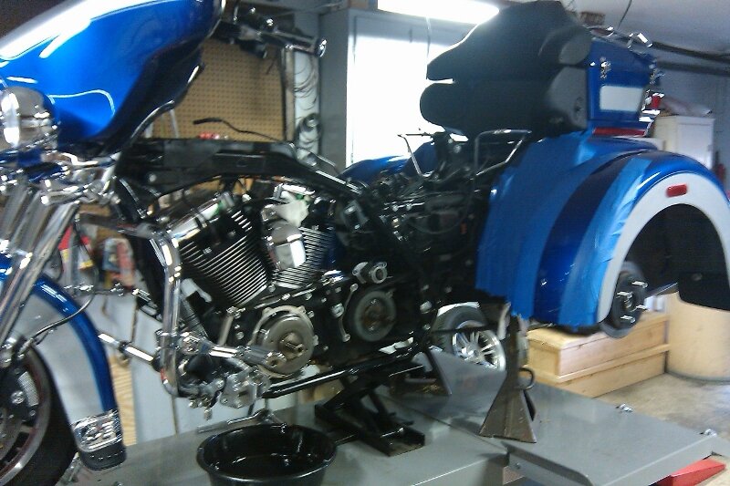

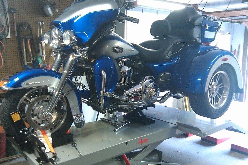

You have the advantage of tying down the front tire. I don't have that option. Mine started rocking and with the tires off, that was for me a bit scary.
Yep, you have to tie the front down. If I'm working on the floor, we have a couple anchor's in the concrete I can screw some eye bolts into. On the lift I tighten the chock and put a strap through the front rim which hooks to eye bolts on the lift. When we first read the manual and it told us how to jack the Triglide up, my dad installed the anchors in the garage floor., been doing it that way from day one.
