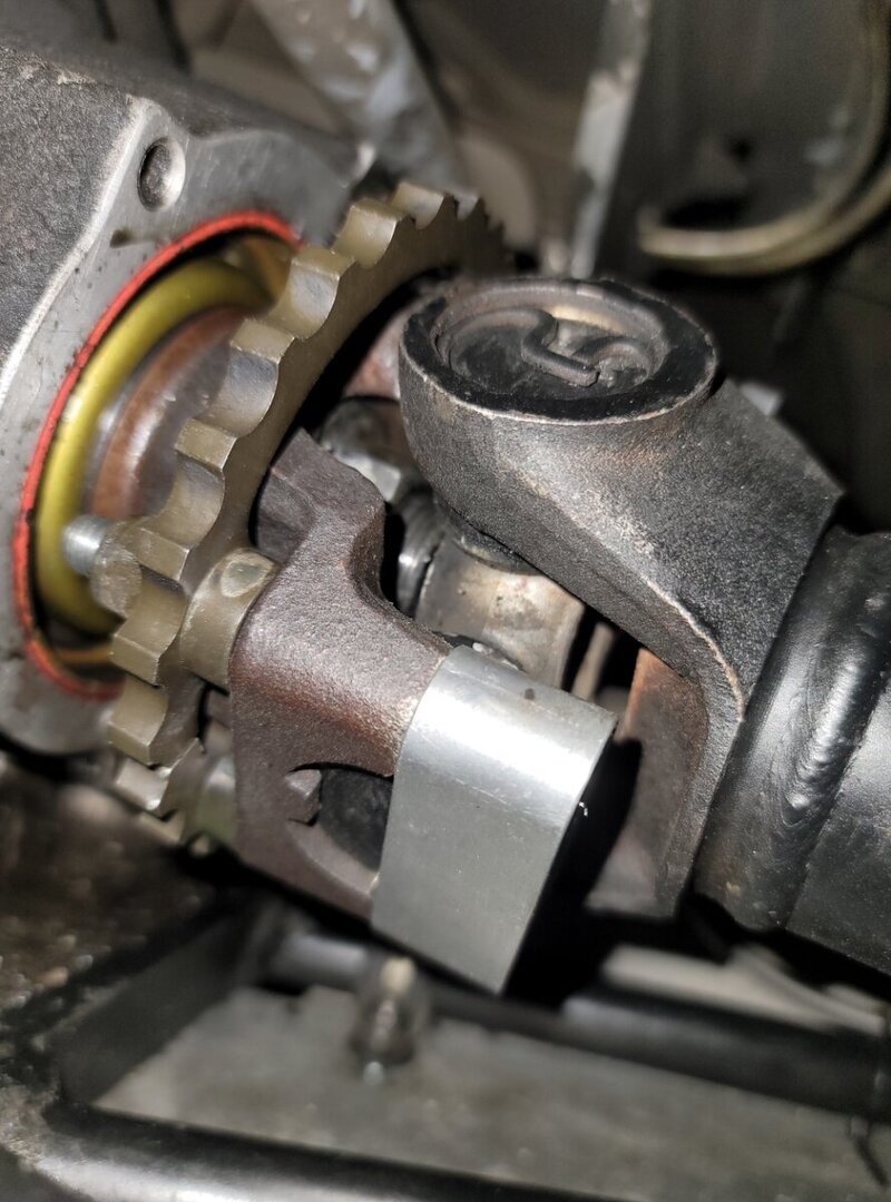

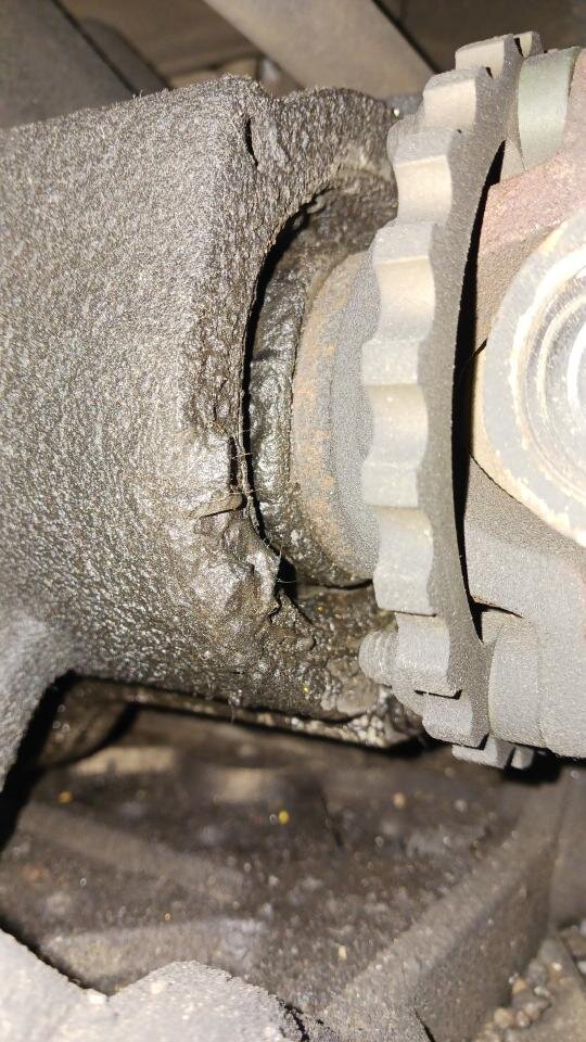

Now my CSC rear end was a modified DANA rear end. It held gear oil and not sealed and filled with grease like yours. That developed a pinion seal leak but I think I need to blame myself for that. And this was also out of warranty when it happened. I had never changed out the gear oil on it. I knew there was a schedule for changing the gear oil but will admit to being intimidated by it so ignored it figuring it would be fine. I never noticed the leak as most of the front where the pinion seal was located was covered by a gravel pan. It wasn't until another CSC owner I knew pointed out the leak to me that I became aware of it so I really don't know how long it had been leaking. Once I had a chance to drop the gravel pan I was able to get a much better view of it. It wasn't a streaming leak but quite enough had leaked out over time to make a pretty big mess all around that. Here is the before pic
And here is the after pic after it was fully cleaned off and new seal installed.
I learned my lesson on that one. Now that I know how easy it really is to change the gear oil, I will do first change on this new one much earlier and keep on top of it.
